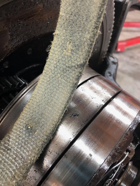

Removed the mag plug for the '25 Coupe motor disassemble prior to pulling the hogshead and found this :(
When there was much fuzz in the oil screen too, at first glance when I got this project, and spied fraying at the ends of the brake lining too, and finding this amount on the mag post (the magneto was working fine), your first thought is drums, drums, drums :o
So removed the hogshead, and pulled the bands, here is the look:
Reverse lining, Kevlar, seems ok for reverse. Drum is only fair-to -poor.
Low speed, ah, some fraying on the edge....near the brake drum. The low drum is poor too, has some pitting, one pit still had a fray of Kevlar!.
and the main culprit, brake drum. Pitting in many places, and this spot is a busted open pit on the edge. Did in both the low band lining edges, and the brake band lining.
Cause of all that fuzz...pitted drums that shred woven linings. These drums are toast.

Also, notice the edges of the drums are sharp from wear. If you are going to run Kevlar lining, the edges of the drums need to be chamfered and polished as well, in addition to no big pits or excessive roughness on the drum surfaces.

Do the Kevlar linings normally shed? Or is this due only to the drums picking at the fabric?
I put Kevlar in my T, but have not driven it yet, due to other items needing attention, but I wondered about the shedding. I know the cotton ones shed as a normal occurrence. Are the Kevlar ones more stable than the cotton ones, or less stable?
I have the little lid filter installed, to hopefully catch any fur that is generated. I am just curious about how often I should be pulling the trans cover to check it, (Based on smooth drums in very good condition)

In my experience, my Kevlar didn’t start shedding until my drum cracked. Then it filled up the transmission oil screen. For years I opened up the cover without anything in the screen.

I am not trying to jack your thread. I would like to add I bought and installed a new screen in my truck and the the brakes went soft so I checked the drum temp. and it was close to 400...long story short I drilled the two rear holes out to 5/8 and more oil dumping on my brake drum temp. went down to 125...now more brakes..My opinion is more oil extends life of band and drum...I have read that kevlar will take high temps...alas the drum will not...so more oil :?: ???

Dan - Unfortunate for sure! And I hear what you are saying about the quality (or, the lack thereof) of the parts used in this rebuild, especially drum condition,.... worn, cracked, pitted, sharp edges, etc, etc. But in the case of the shredded & fuzzy woven Kevlar linings, I cannot help but wonder what might have (or, might not have) happened in that "rebuilt" transmission, if wood linings had been installed, rather than the woven Kevlar???
I like wood linings for several reasons; less heat generated with wood, no lint, long wear, etc, etc. Might be that the drum wound not have cracked in the first place with wood, the sharp edges would probably be a bit less of an issue, and as far as the "pits" in the one drum are concerned, I don't think wood bands would be much affected by that either. Pitts do not protrude,...in fact, it might be said that they hold a bit of oil, you know. sort of like its been said that riveted brake linings hold a bit of brake dust, as opposed to bonded linings.
