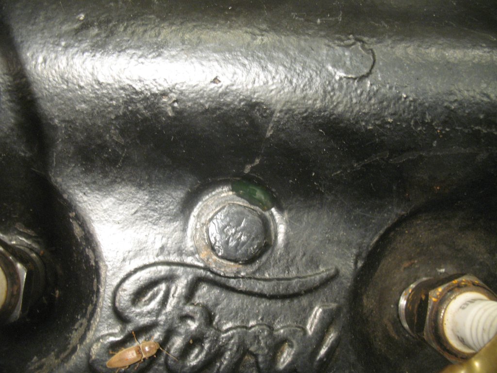

In your picture, I notice the wire for one spark plug is very close to another spark plug. Do you suppose, a spark is jumping at the wrong time?

From your picture, it looks like one spark plug wire is touching the terminal of another spark plug. Is it possible that a spark is jumping at the wrong time and that plug is firing twice? That could cause it to run rough.

Steve I’m assuming that the spark plug wire shouldn’t be sitting on the top of another plug. That’s not good. Since youve got it to start fairly easy, let it run and get it to operating temp.

Steve, In today's picture, ( 7-4-2021 ), it looks like I can see the steel ring at the intake manifold to rear intake port. The copper crush ring should be crushed against the block and the intake manifold because the steel ring is a split ring and will leak at the split. Most likely the steel split ring needs to be trimmed and is currently bottomed out and not allowing intake manifold to crush the copper ring.

I think what you are seeing is a separate gland rig laying there to show the crush of the rings. All the new glands are red from the silicone.kmatt2 wrote: ↑Sun Jul 04, 2021 6:35 pmSteve, In today's picture, ( 7-4-2021 ), it looks like I can see the steel ring at the intake manifold to rear intake port. The copper crush ring should be crushed against the block and the intake manifold because the steel ring is a split ring and will leak at the split. Most likely the steel split ring needs to be trimmed and is currently bottomed out and not allowing intake manifold to crush the copper ring.

No, it is not the extra glan ring that I am looking at. Look at the rear intake port by the E in MADE. There is shiney steel and then red, I would expect dull cast iron then red. It could be just the picture or maybe a aluminum intake, but is worth checking.
Topic author - Posts: 7411
Re: Feeling stupid - hard starting
What Kevin is seeing isn't the steel ring. It's the intake manifold. The shine is from light hitting the black paint.
That #1 plug wire is across the #3 plug because I put it there to get it out of the way for the picture. It's normally far from any other wire or plug.

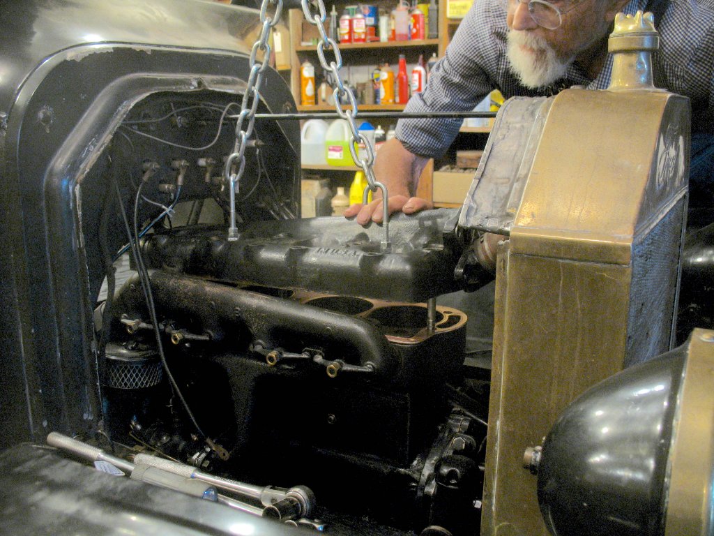

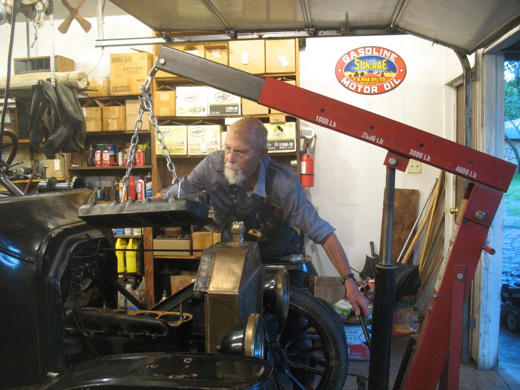

But wait, there's more. Coolant around the #1 head bolt told me that the fancy no-sealant head gasket was leaking, and that coolant was getting into at least one cylinder and causing the rough running. So I pulled the head, chased all the holes with a tap, blew them out, and checked without a gasket to be sure the bolts would go all the way down. They did. So I put the head back on, this time using a new copper gasket with Permatex copper coat sprayed on both sides.
I prefer to let machinery do the heavy lifting, rather than my back.
Guide studs at front and center align the gasket and head perfectly.
With the head back on and properly torqued all around, I went to buy oil. When I got back from town I found this: The old cliché not a happy camper applied here. After all the hassle of pulling the head and installing a new gasket, I still had a leak at the #1 head bolt. But a closer look shows that the coolant isn't coming up through the bolt hole. It's coming from a crack or a tiny hole near the bolt. So the supposed leaking gasket was a red herring, and the whole gasket change was unnecessary. Grrr...
So there are still two things to fix. A bit of JB Weld or the like will take care of the leak. No big deal. I've done that before. But what about the rough running? We shall see.
