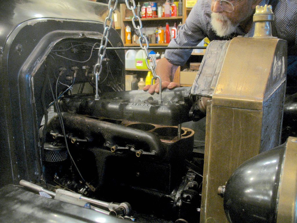

But wait, there's more. Coolant around the #1 head bolt told me that the fancy no-sealant head gasket was leaking, and that coolant was getting into at least one cylinder and causing the rough running. So I pulled the head, chased all the holes with a tap, blew them out, and checked without a gasket to be sure the bolts would go all the way down. They did. So I put the head back on, this time using a new copper gasket with Permatex copper coat sprayed on both sides.
I prefer to let machinery do the heavy lifting, rather than my back.
Guide studs at front and center align the gasket and head perfectly.
With the head back on and properly torqued all around, I went to buy oil. When I got back from town I found this: The old cliché not a happy camper applied here. After all the hassle of pulling the head and installing a new gasket, I still had a leak at the #1 head bolt. But a closer look shows that the coolant isn't coming up through the bolt hole. It's coming from a crack or a tiny hole near the bolt. So the supposed leaking gasket was a red herring, and the whole gasket change was unnecessary. Grrr...
So there are still two things to fix. A bit of JB Weld or the like will take care of the leak. No big deal. I've done that before. But what about the rough running? We shall see.
