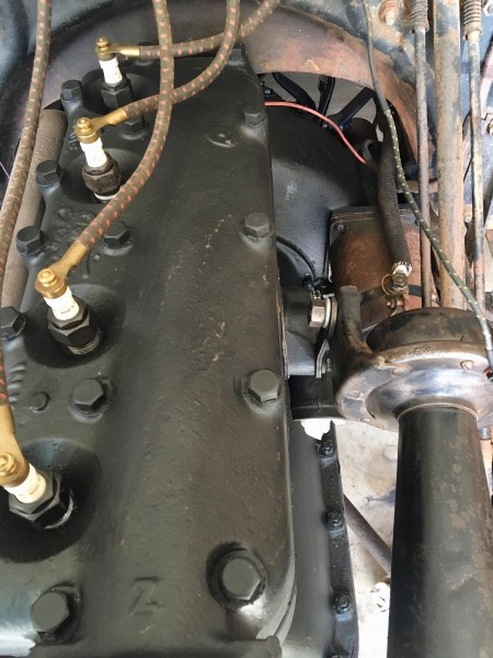

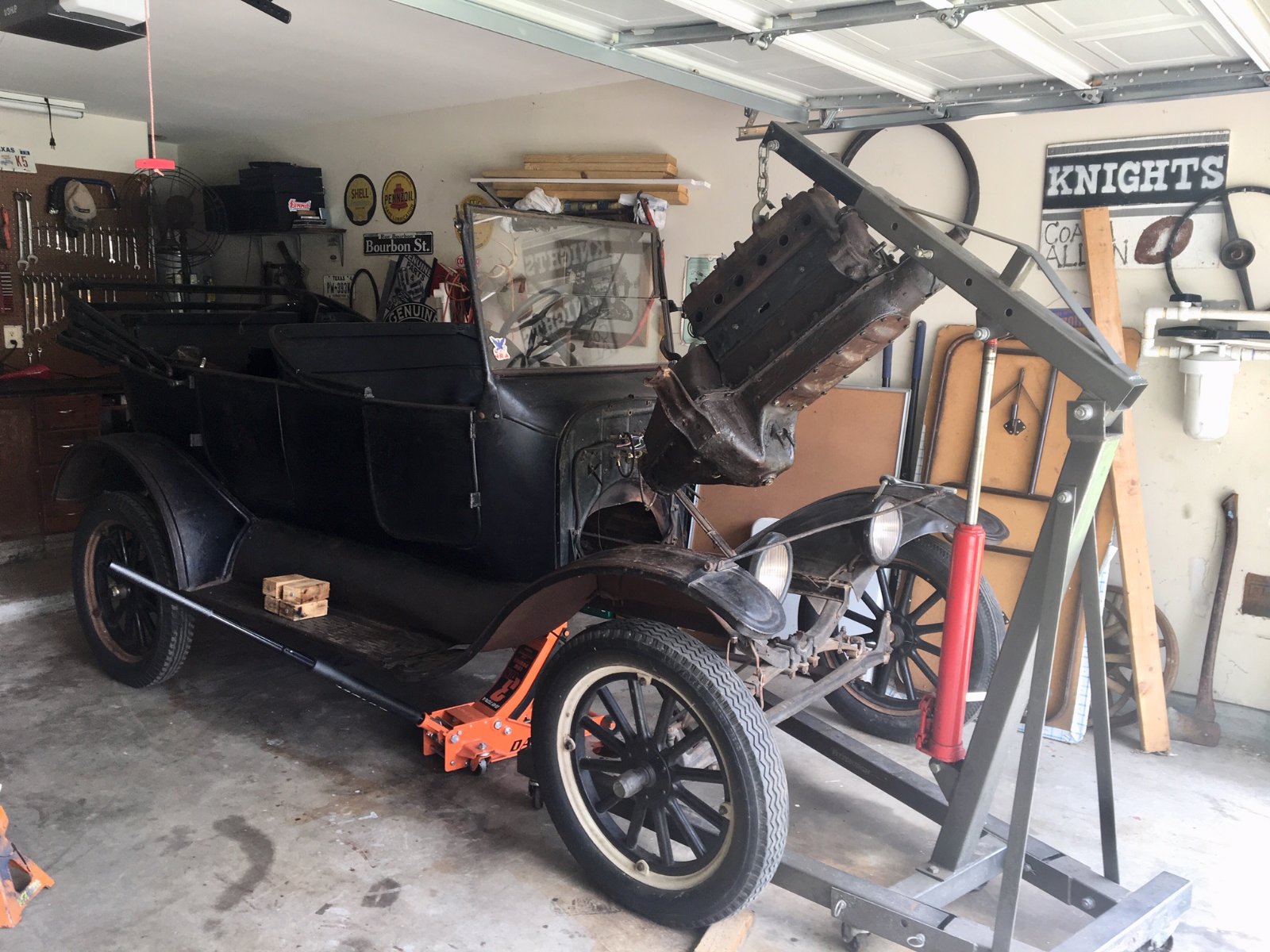

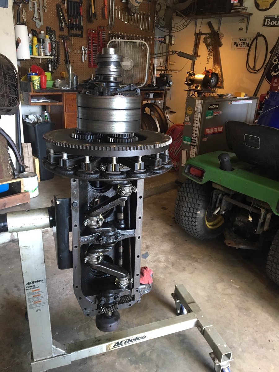

Steady as she goes...removed, cleaned, re-gasketed and reinstalled the timing gear cover then installed a very nice original lower pulley that George House sent me and installed an upper coolant hose neck.
1924 Touring
RustyFords

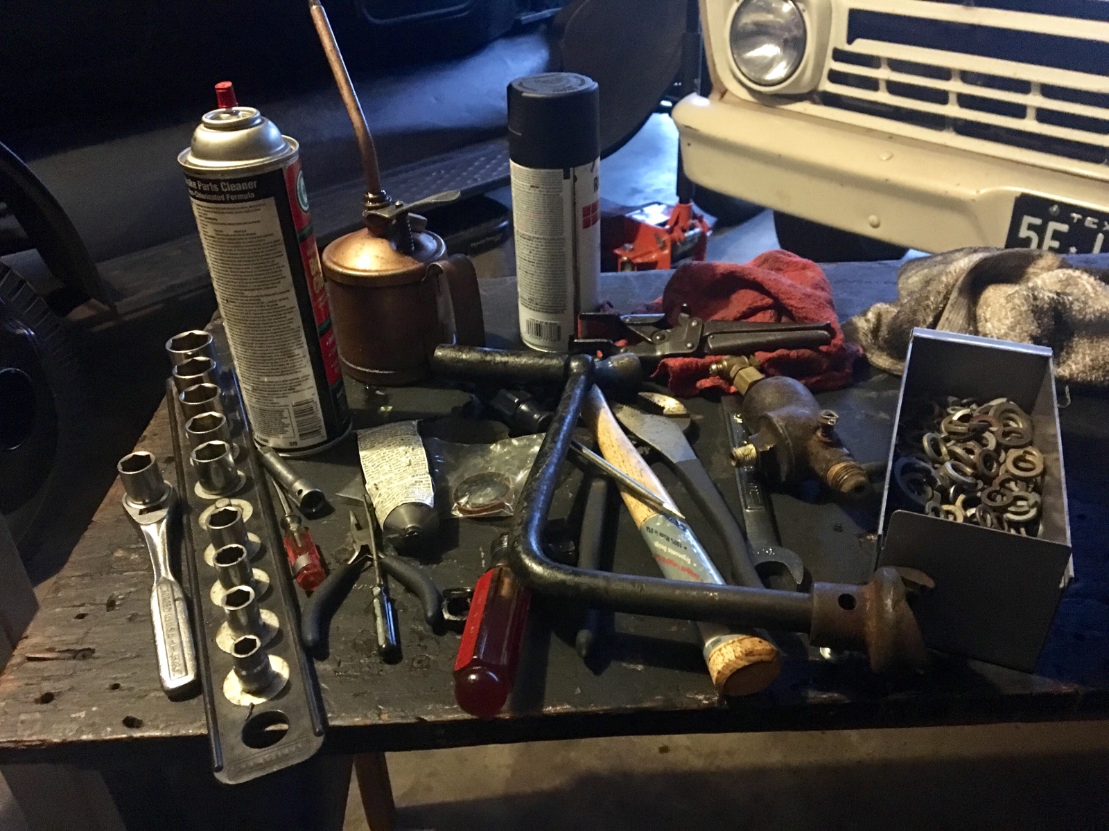

No matter how small the job, I always seem compelled to get out nearly every tool I own.

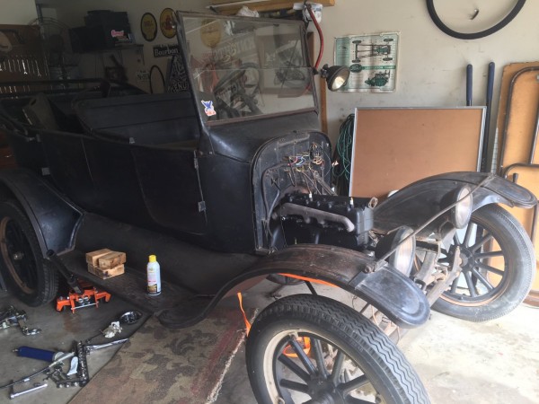

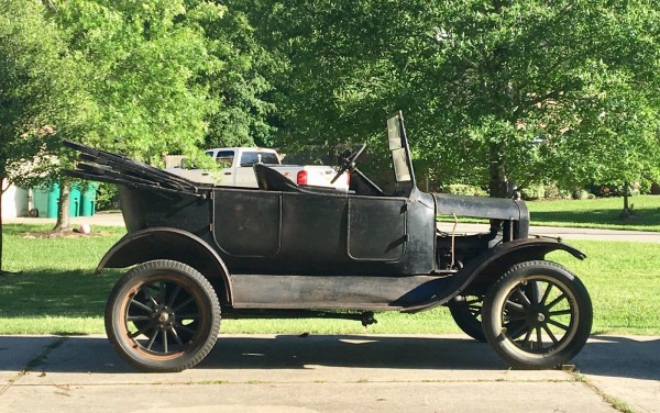

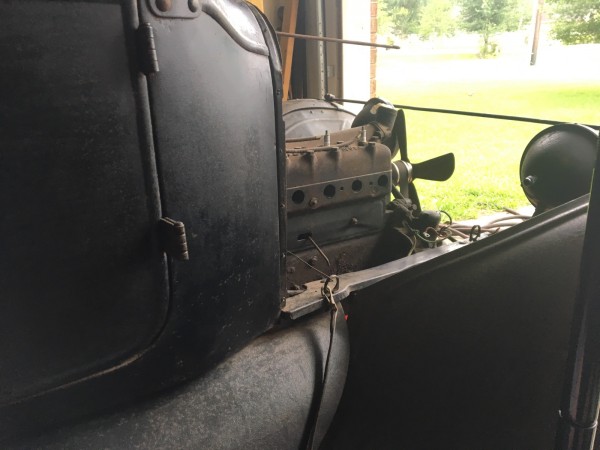

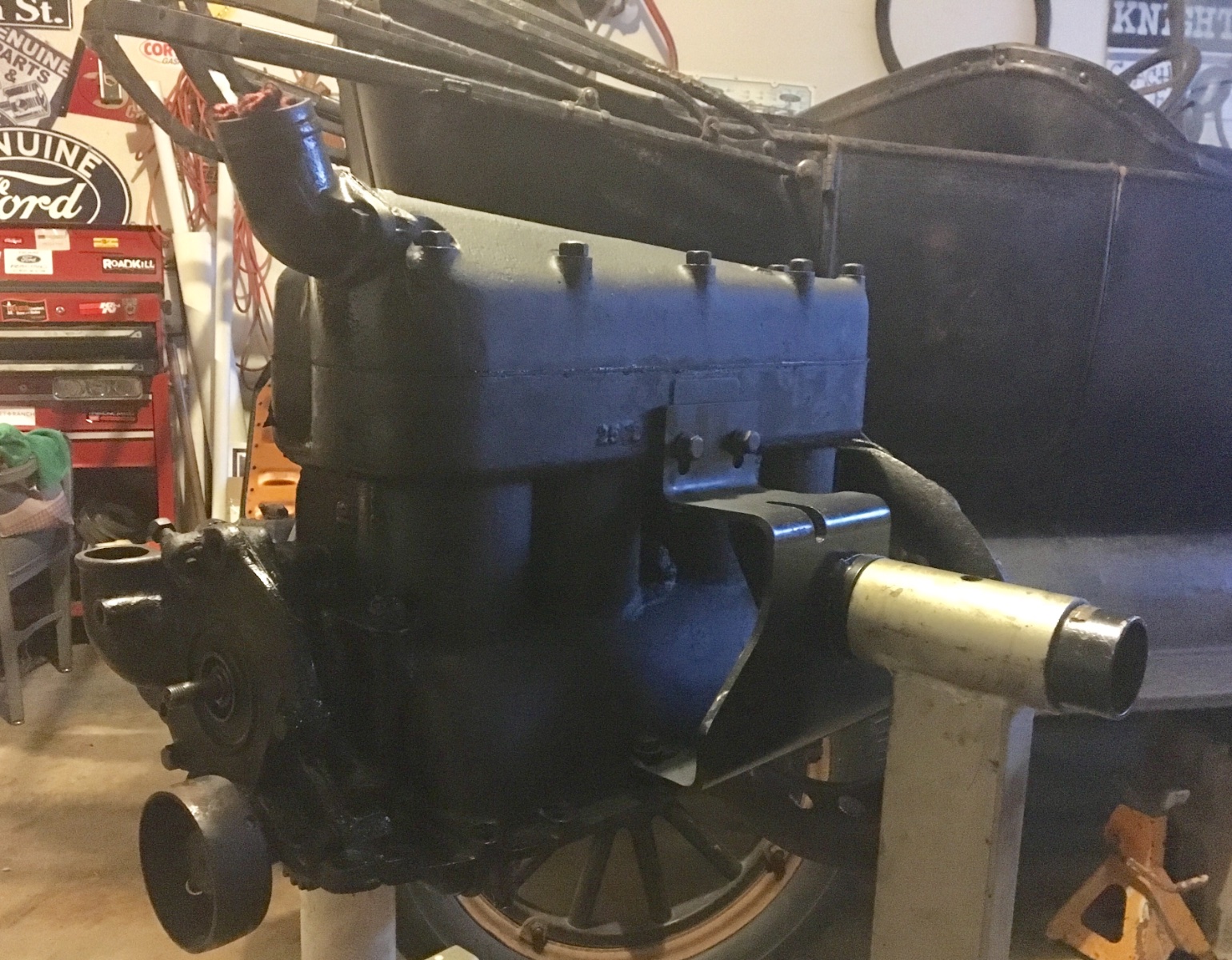

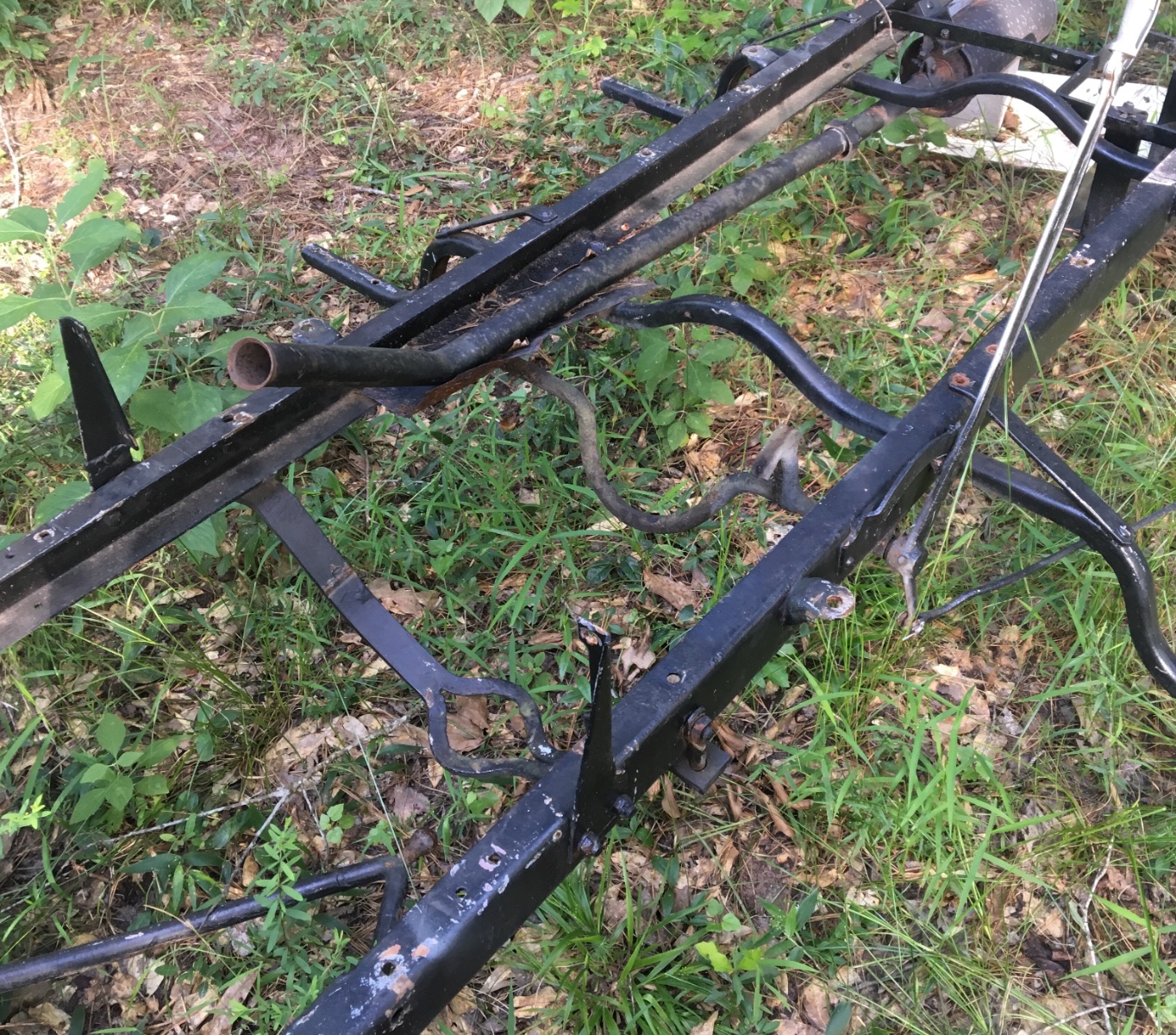

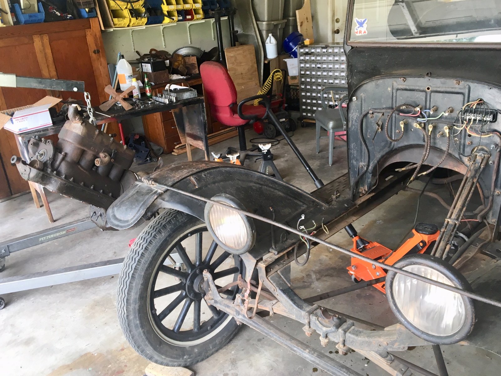

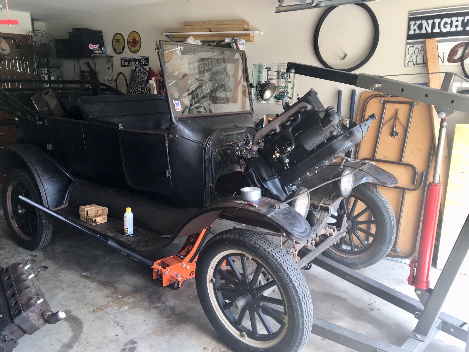

The old girl is coming along.
I think a realistic goal is to have it running and driving this summer.

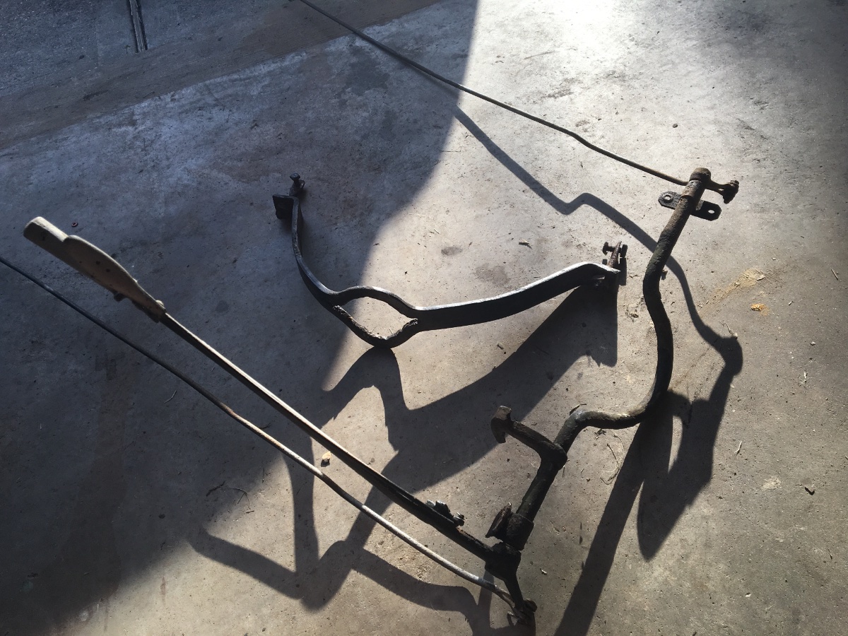

I could probably hastily assemble what I have right now and get it running in a couple weeks, but I'm going to resist that urge and continue to be methodical about things and do it right.
Observant viewers will notice that the driveshaft isn't hooked up. I have it hanging by some bailing wire to make pushing it around a bit easier. And also because I'll be swapping engines soon anyway.

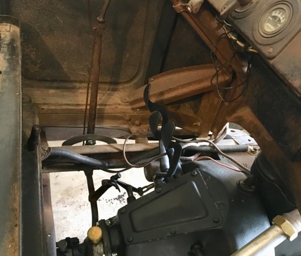

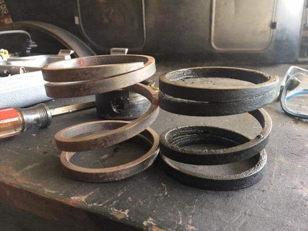

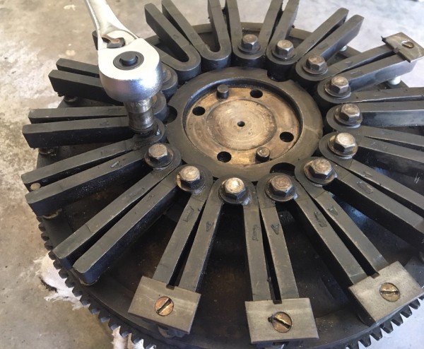

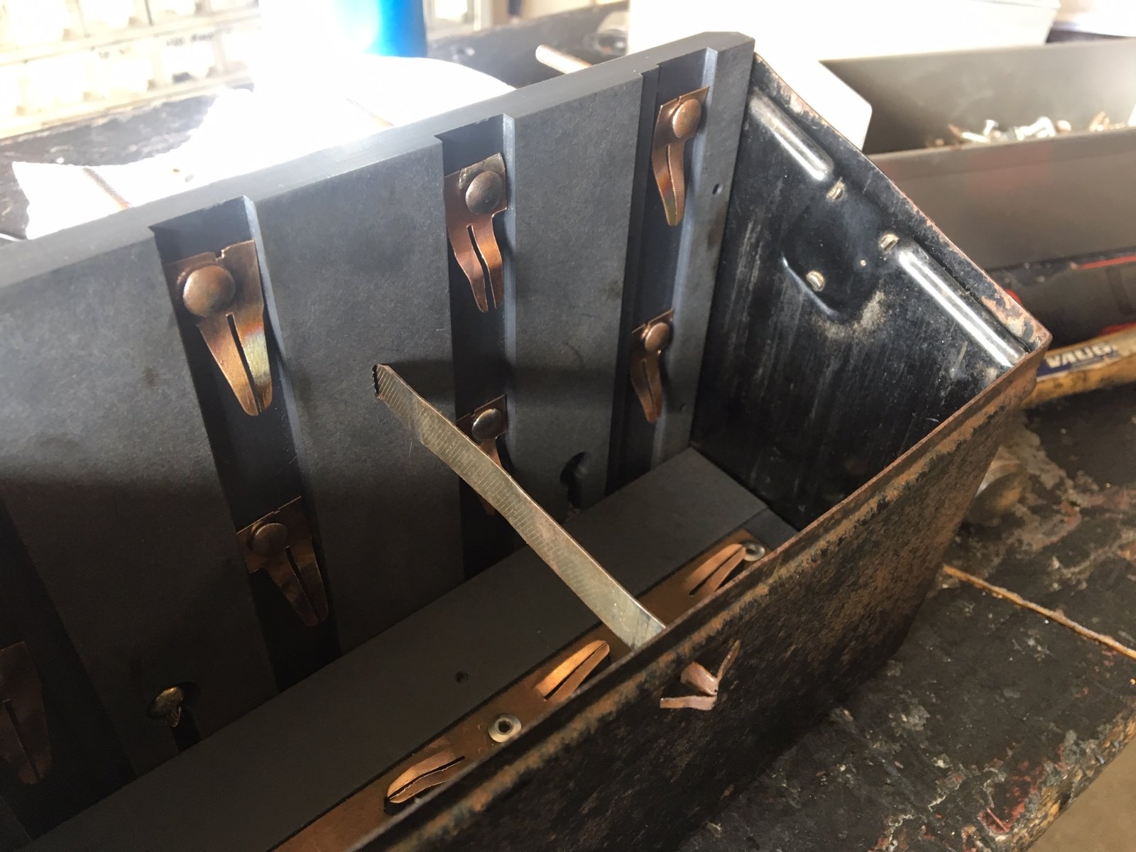

Big step forward today.

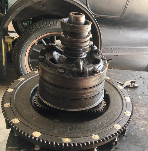

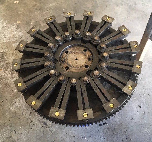

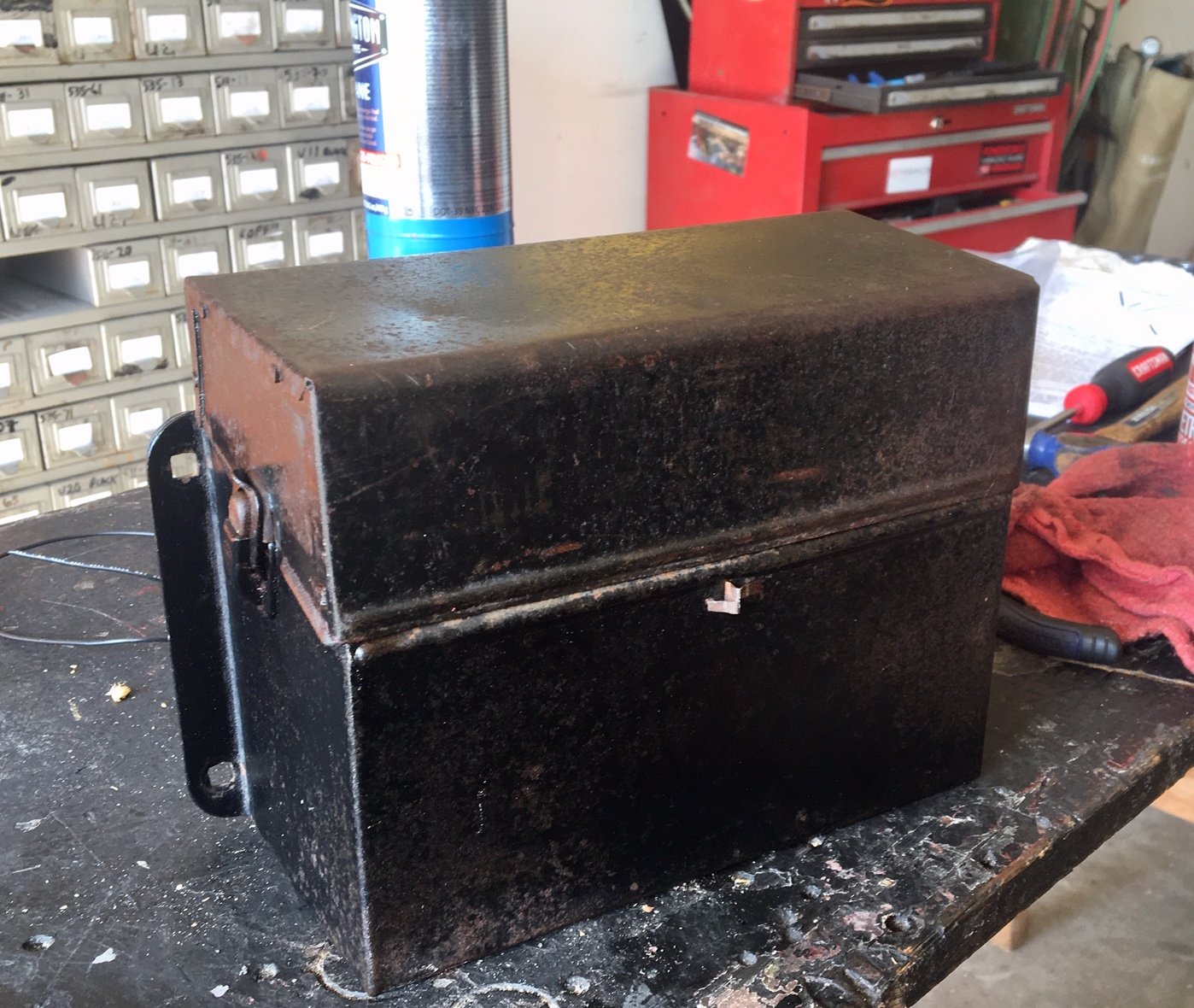

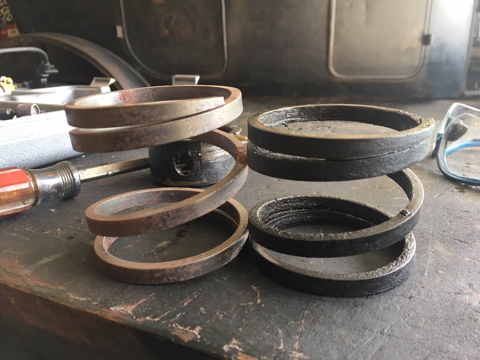

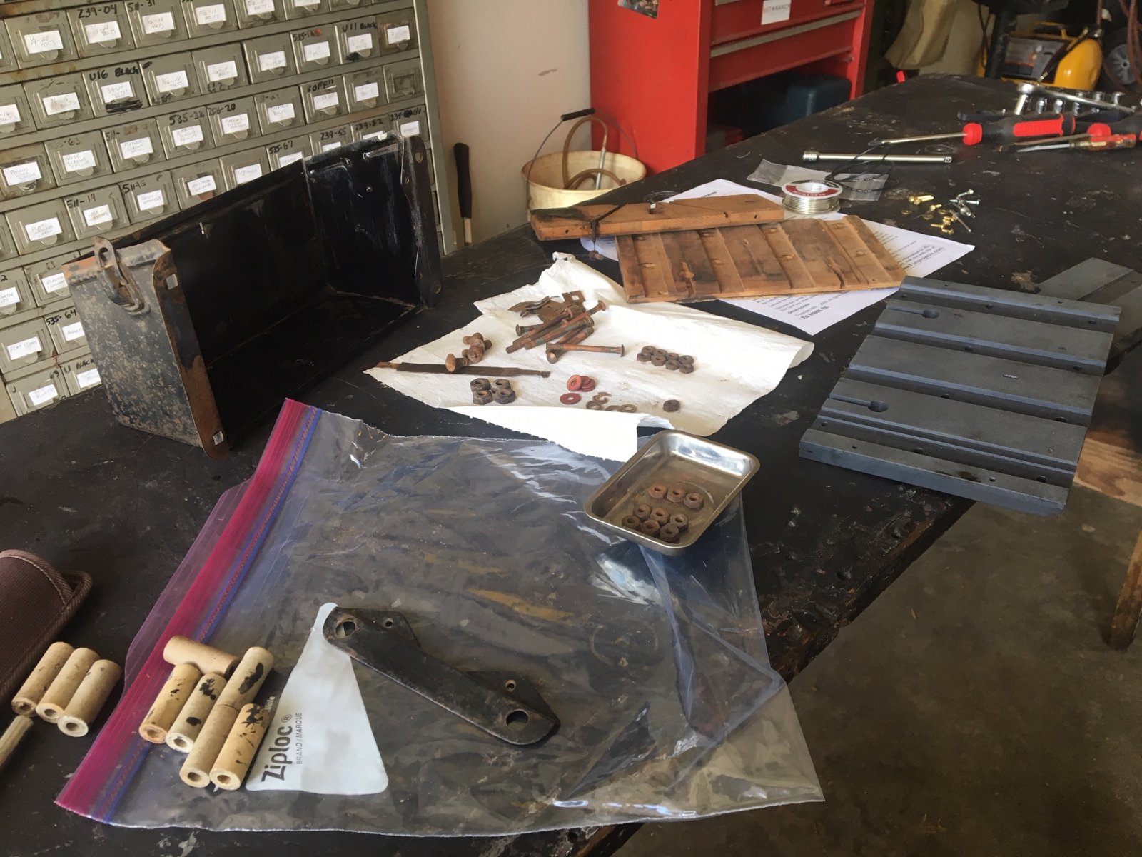

I replaced all the magnet screws with new ones then did a trial fit of the transmission to see what my magneto gaps were. Much to my amazement, it varied between .025 on one side and .030 on the other. I called that good enough and safety wired the transmission/crankshaft bolts.
Last project for the day was installing a new clutch spring. I was debating on whether to do it, but I'm glad I did go ahead....especially after placing the new and old springs side by side. The old one was pretty tired.

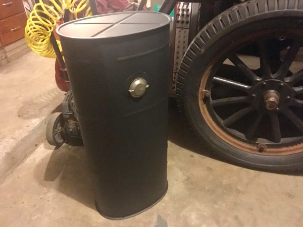

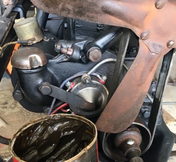

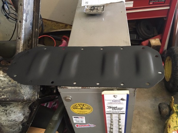

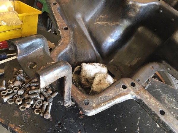

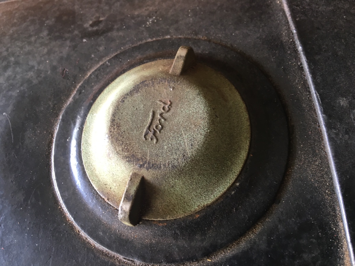

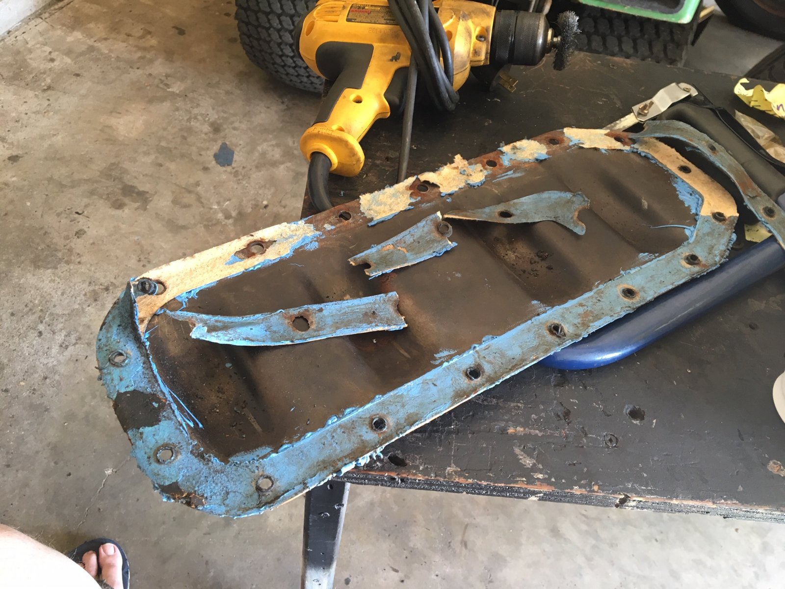

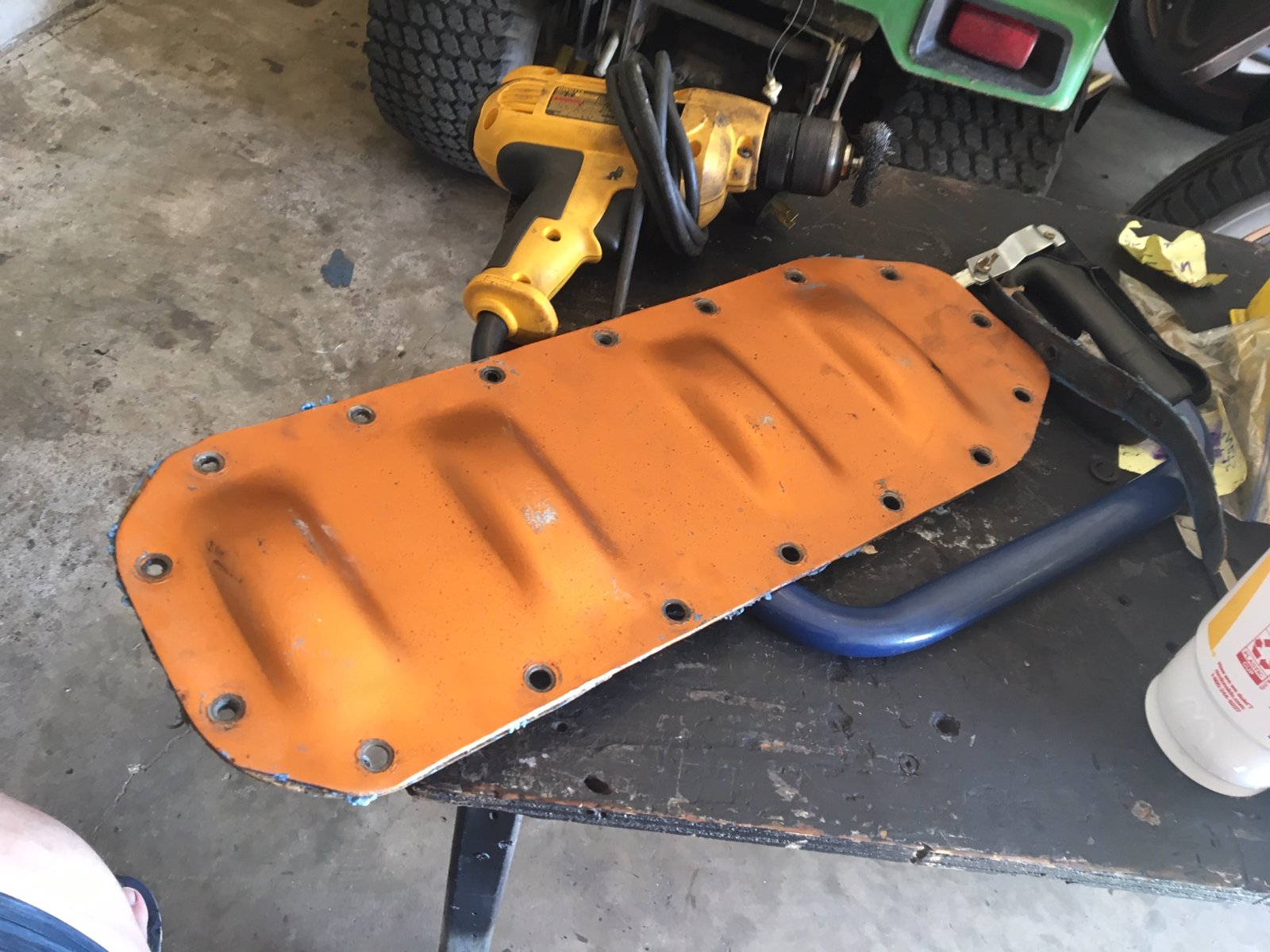

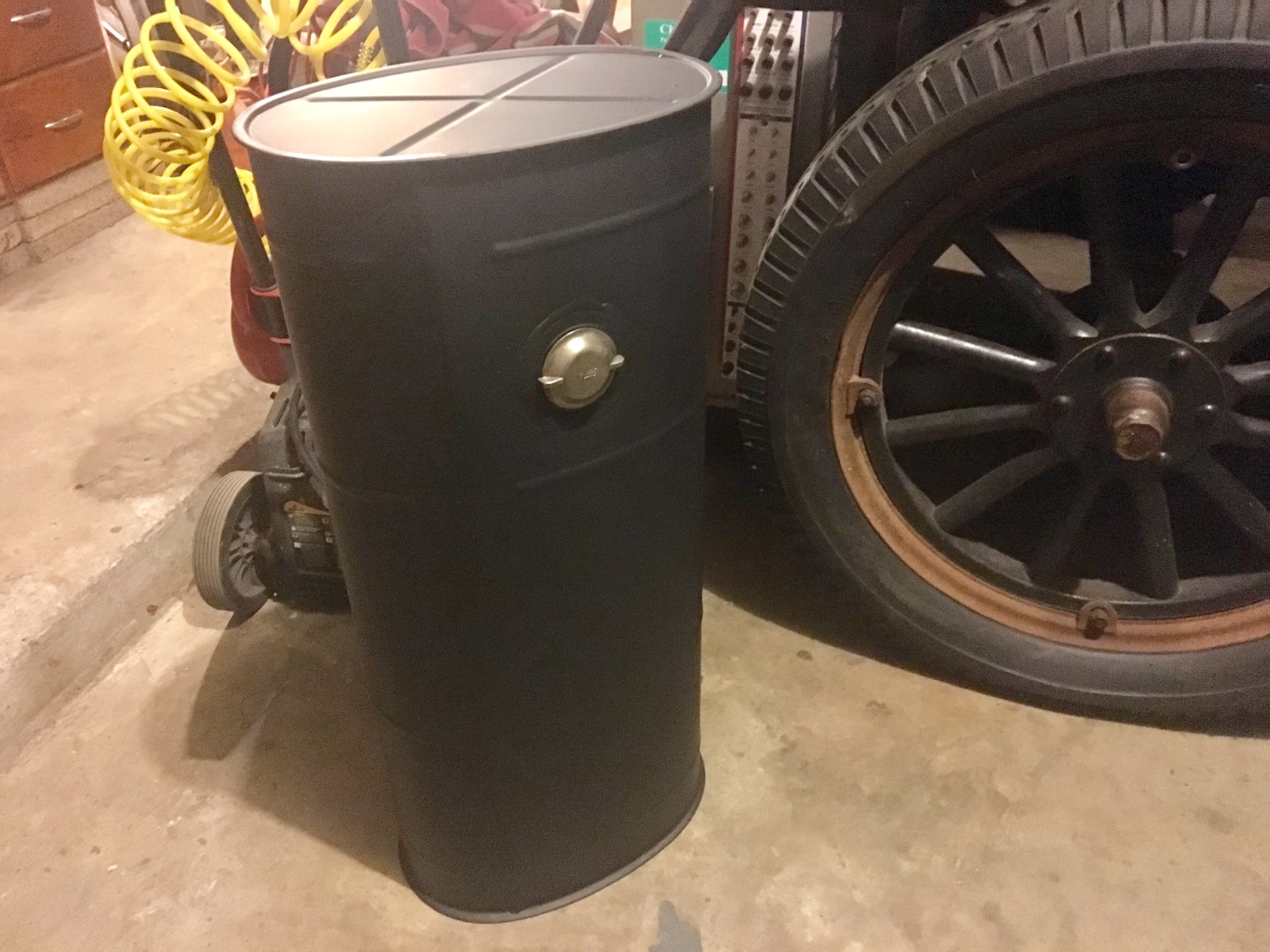

I kept the ball rolling today by cleaning up the oil pan and inspection cover and degreasing all the hardware for the oil pan and hogshead. I also have a new bushing for the crank handle. I wanted to get that installed today but the old bushing is really being stubborn about coming out. I think I'm going to have to collapse it in place and pull out the remains.
And...I'll say it again...I AM NOT RESPONSIBLE for the hideous paint or the copious slathering of the blue RTV on the inspection cover. This temp engine came that way in the parts chassis from the previous owner. Sometimes I think you should have to get counseling before you're allowed to buy RTV. ;)

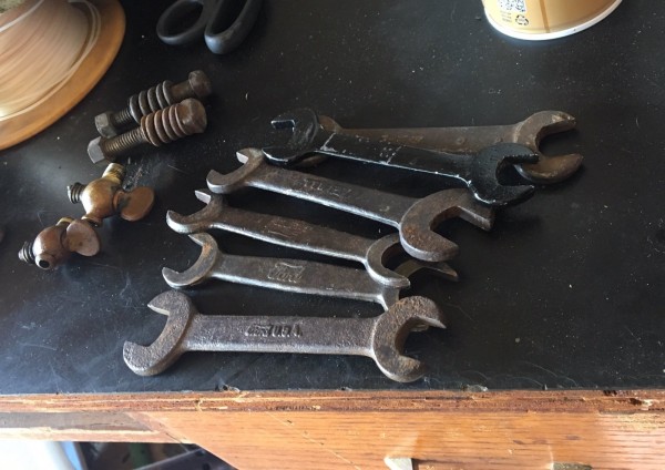

I stopped by an antique mall today and found this Ford scripted wrench assortment for $5 for the set. They're pretty common, but I thought that was a decent price.

" Sometimes I think you should have to get counseling before you're allowed to buy RTV. ;) "
That goes right along with one of my many sayings of many years; "Some people should be banned by law from ever touching a screw driver or any other common hand tool!"
Some people simply CANNOT handle simple tools or mechanical anythings.
Truly tragic. But could have been funny if it weren't so sad. When I was in the sixth grade, a girl in my class, and neighbor just over a block from where I grew up, her dad was killed changing a light bulb in the living room. He was well known in the neighborhood for being totally unable to handle anything mechanical.
Enough said about that. Back to better things! Like working on model Ts for the mechanically inclined!
Same guy must have been through my T engine also... they loved the blue stuff. If a little is good more must be better!

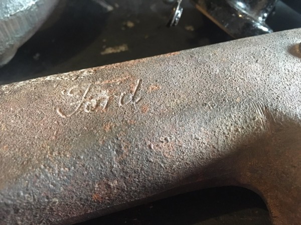

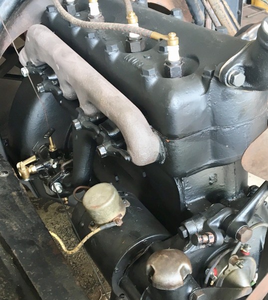

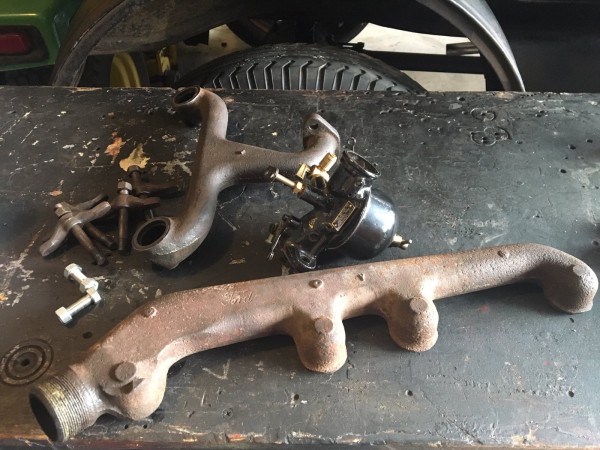

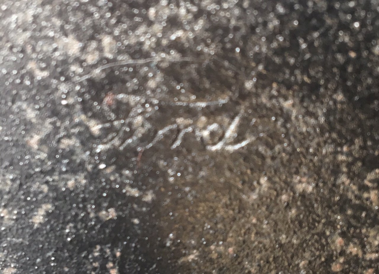

Removed all the "breathing apparatus" from the other engine to clean it up for the install on the temp engine.

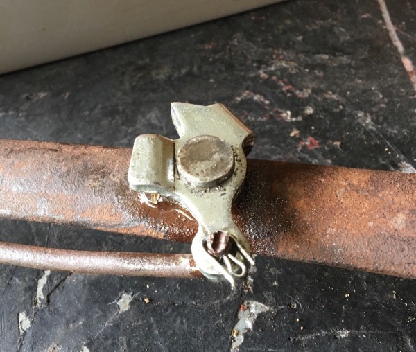

I put a straight edge on the Ford script exhaust manifold and, much to my surprise, it was straight as an arrow.

Straight? Thats a good day in my book Don.

That's what I thought too. I understand that it's hard to find a straight OEM one. I was prepared to shell out the $$ for a new one.

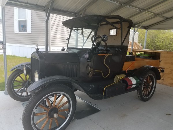

Just my Ol' buddy and me. I mind that wheel seriously. If he has a problem, I may suffer. I find doing that out of this world.
Yet, the stout little bugger carries on. Sure as ever. Nearly unstoppable. Except for brakes. His 16" tires lock up IF I pull.
Back on Earth. I itch for your first maiden voyages with your Touring Don and await your reports.

Getting ready for the engine swap

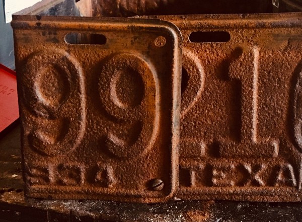

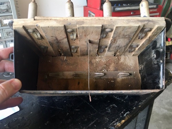

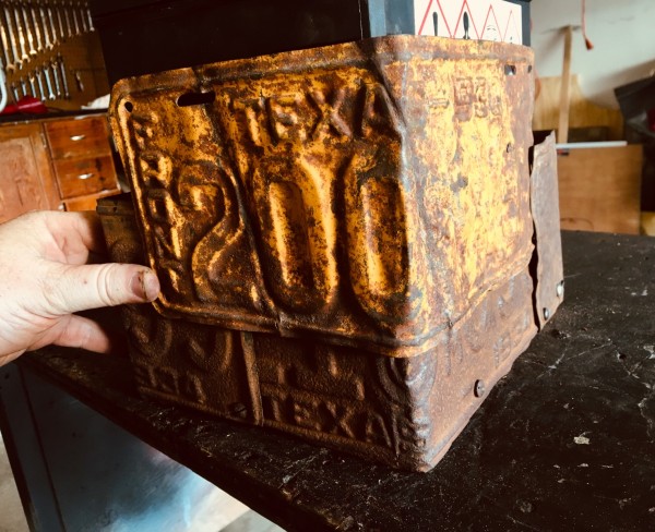

My car was missing its battery box so I decided to make one that fit the “use what was available on the Great Depression era farm” theme.
I figured pre-war license plates would fit the bill. It has a cut down piece of 2x12 wood for a base.
It’s a work in progress, but I think it’ll turn out pretty neat.

Nice period screws Don. Its all the details, right? I like the theme.

I figured you’d catch that Dallas. 😊
My goodness I’m having fun with this gigantic art project that also happens to be a car. I may not be able to contain my excitement once it’s actually mobile.

RustyFords
Posts: 1559
First Name: Don
Last Name: Allen
Location: Houston, TX
Re: 24 Touring Barn Car Revival - Part 3
Post by RustyFords » Sat Jun 22, 2019 11:39 pm
I pulled the engine that came with the car and installed the "freshened up" engine. Not having done this before with a Model T, there was a learning curve. So, what probably should've taken a couple hours, took me about 4 hours instead.
Based on what I've read on this forum, I thought I might have to remove the steering column, but managed to pull the engine without doing so by sort of twisting the engine as it came out. For the installation, I applied a thin layer of grease on top of the frame rails between the firewall and engine mounting holes. Then I pulled the engine rearward with a ratchet strap until it fell into position.
1924 Touring

A heart transplant. It will live! I cant wait to hear " ITS ALIVE"

With the very limited time I had today, I worked steadily and installed the starter, timer, throttle and timer rods, fan, fan belt, crank handle, horn, generator cutout, and a few other things.

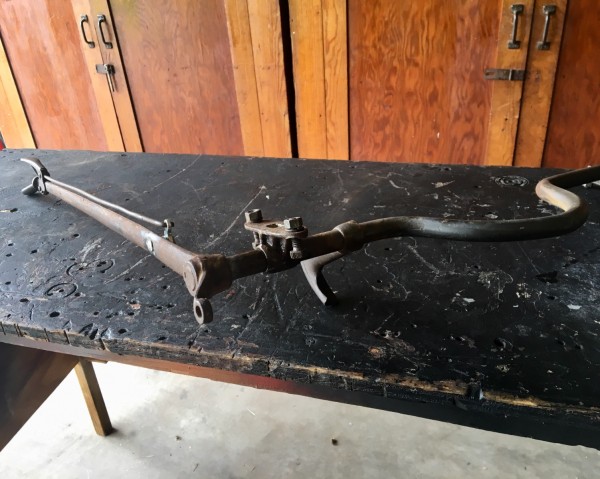

My parts chassis had an aftermarket engine support (aka...belly band) that I decided to scavenge and use on my car. It also had a set of factory brake rods where my car had a homemade set.
So, this evening I pulled them off the chassis.
If anyone in the local area wants this 1925 frame, you’re welcome to come get it for free. I’ve pretty much picked it clean.

Post by RustyFords » Sat Jul 06, 2019 9:15 pm
Taking full advantage of the time I had today, I installed the exaust pipe and pumped nearly a full tube of grease into the u-joint grease fitting.
Then, I installed the coils and a fresh battery and rigged up an "I.V." gas line and jacked up one rear wheel. Then, for curiousity's sake only, I choked it a few times while turning it over with the starter...then turned on the ignition and hit the starter again.
And wouldn't you know, the old bucket sputtered and coughed right away. This was without any attempt at setting the initial timing or even setting the carb mixture adjustment.
I had to call it a day after that, but I'll be back at it again tomorrow.
I'm going to treat the fuel tank with acid first thing in the morning, then by late afternoon, it should be ready to install and accept gasoline. I also need to install the hand brake and all that goes with that system (which is why I tried to start it today with one wheel jacked up). So...in spite of the fact that I had a sign of life, I still need to do a few more things before I have a runner. When I do, however, I'll film it and post it here.
1924 Touring

Yesterday it tried to start but I had to call it a day. Today, I adjusted the timer and the mixture screw and it instantly fired right up as you can see in the video.

Post by RustyFords » Sun Jul 07, 2019 7:37 pm
Alas...all is not peaches and cream.
The gas tank that came on my parts chassis...the tank that I thought was excellent...is not. I tested it with water and it leaked like a sieve. An inspection with a flashlight also revealed lots of rust inside.
I’ll be ordering a new tank from Lang’s tomorrow. It’s an expense I hadn’t counted on, but it will be nice to have a completely fresh/new fuel system from tank to manifold.
On the bright side, the tank did come with a nice Ford script cap.

Post by RustyFords » Sun Jul 14, 2019 4:58 pm
I had one measly hour of play time this weekend so I picked a project that could be completed in that amount of time.
Fortunately, the project that ranked highest in importance fit the bill...the hand brake assembly.
The original pawl was worn out, the hole in the lever where the pawl connects was all hogged out and the pawl rod was broken where the cotter pin goes. I made a rivet out of a shoulder bolt then peened it closed after installing a new pawl. There was just enough rod left to drill a new cotter pin hole.
I had enough time to install it but not enough time to adjust for free neutral. That’ll have to wait.
Once that’s done, I’ll be able to start the car with all four wheels on the ground. Up to this point, I’ve been jacking up a rear wheel when starting the car.

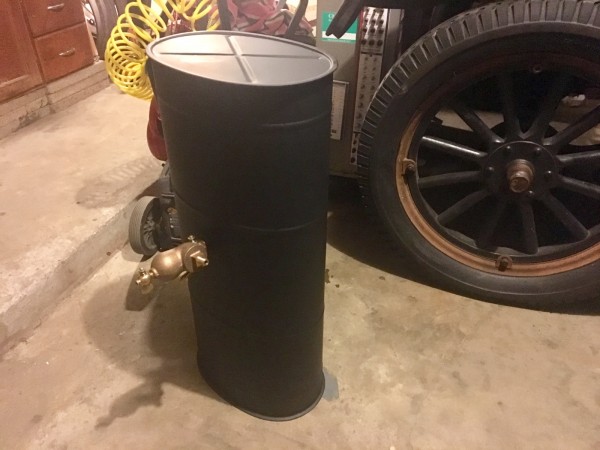

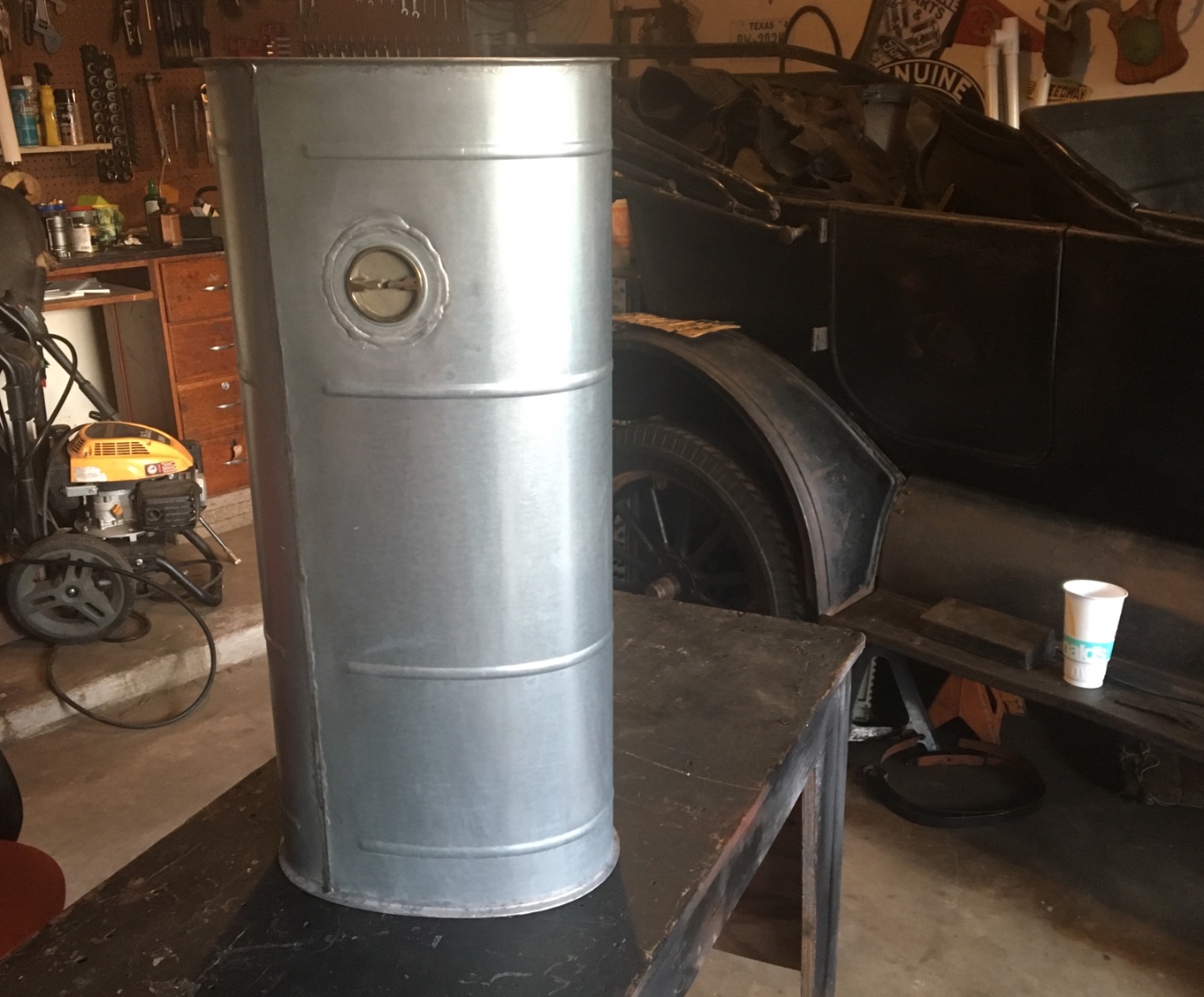

Post by RustyFords » Wed Jul 24, 2019 10:07 pm
The new Rootlieb tank arrived today so I gave it a few coats of flat black so it’ll be dry by this weekend.
Now everything between the gas cap and the intake manifold is new (tank, sediment bowl assembly, fuel line and rebuilt carburetor). I’ve learned from the school of hard knocks with old cars that have been sitting for decades...if you can afford to go ahead and replace the whole fuel system, you probably should. It saves a lot of time and frustration,
In the end, I’m glad my leaky fuel tank forced my hand on getting a new one.

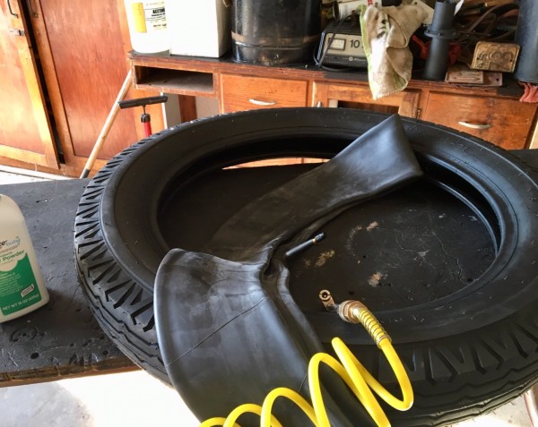

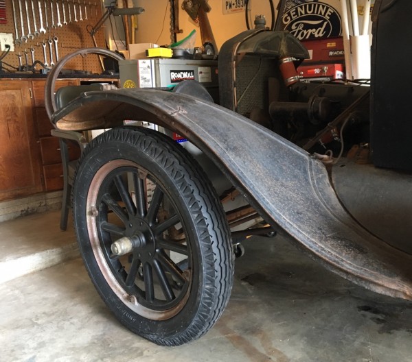

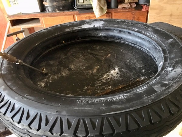

Post by RustyFords » Sat Aug 31, 2019 11:10 pm

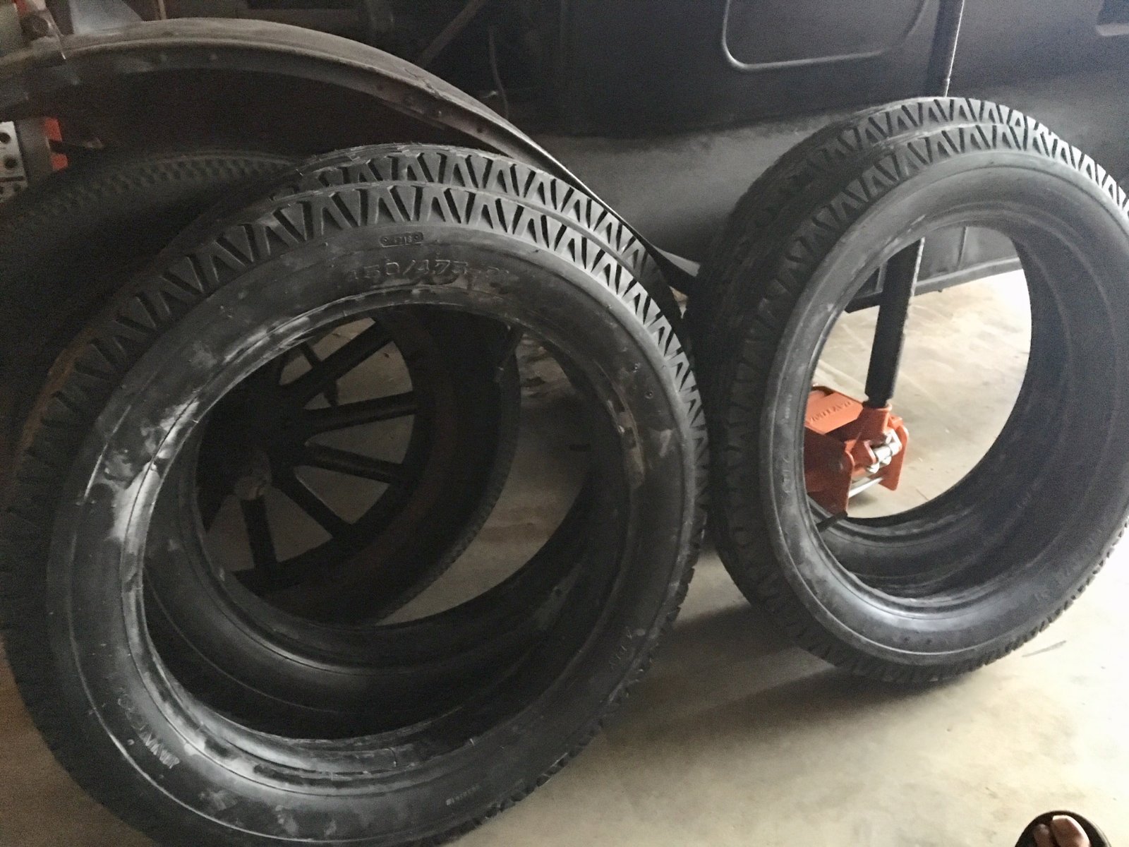

Today I assembled four new tires, tubes and flaps.
Tomorrow I'll try my hand at mounting them on split rims. But, first I need to learn the proper way to use the rim spreader so I don't wreck the very nice set of split rims I bought at Chickasha in 2018.
1924 Touring
RustyFords
Posts: 1559
First Name: Don
Last Name: Allen
Post by RustyFords » Sun Sep 01, 2019 11:05 pm
Thanks to the MTFCA forum archives, I learned how to properly use the rim spreader and got all four tires mounted on the rims then on the car.
1924 Touring

Post by RustyFords » Mon Oct 07, 2019 1:50 pm
From the outset, I suspected that the coil box in my car was most likely OEM and had never been touched or maintained. I knew this couldn't be helping the car any as far as running smoothly, so I ordered a Fun Projects Coil Box Kit and, over the weekend, installed it.
It was fairly straightforward but one does need to follow the instructions in order to get it right. The one step I skipped was soldering the contacts to the posts because I didn't have any rosin core solder. At some point in the future, I'll probably pull it back apart and do this.
After the reworked box was installed, all hard starting and intermitent missing issues were resolved. I'm sure that my rebuilt coils were not making full contact in the old box.
The most surprising improvement was the magneto performance. I'd never noticed the "surge" in the engine that so many people report when switching to mag. My car tended to run about the same or slightly worse. After the rebuild, the surge is very noticeable.
I am very pleased with the outer appearance of the box. It's a rust-free (gotta love the way west Texas preserves old metal) Ford stamped piece wearing the same nicely weathered factory paint as the rest of the car. And, like the rest of the car, it responded nicely to the Penetrol treatmemt.
1924 Touring
