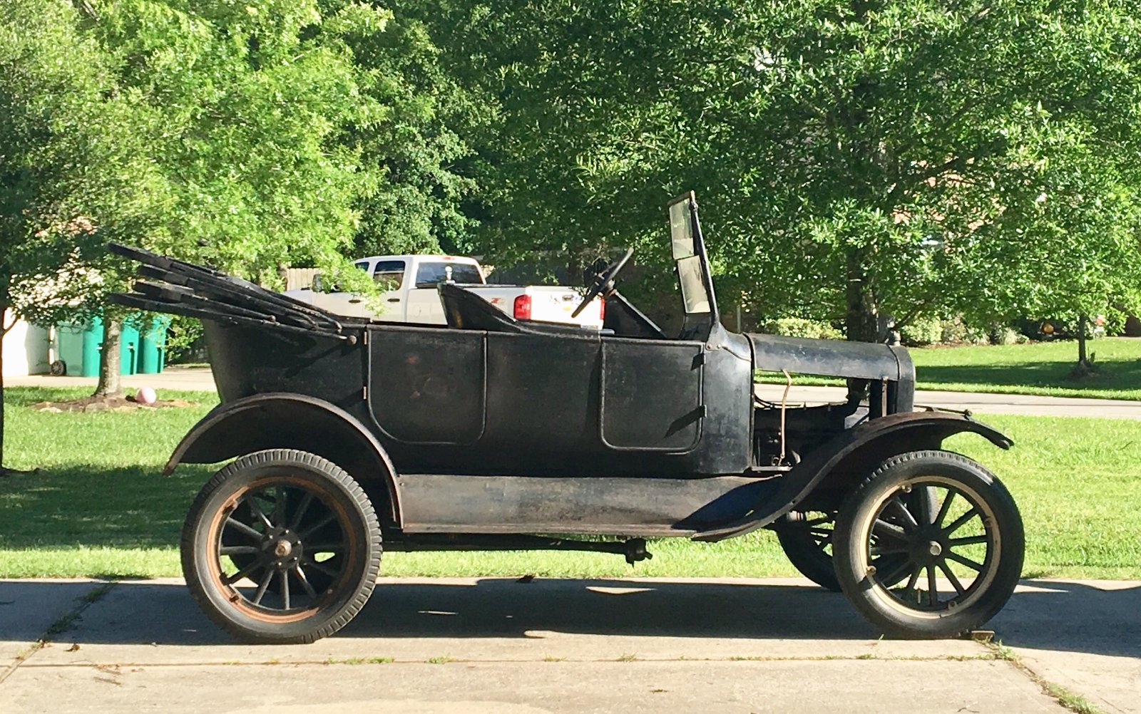

The old girl is coming along.
I think a realistic goal is to have it running and driving this summer.
I could probably hastily assemble what I have right now and get it running in a couple weeks, but I'm going to resist that urge and continue to be methodical about things and do it right.
Observant viewers will notice that the driveshaft isn't hooked up. I have it hanging by some bailing wire to make pushing it around a bit easier. And also because I'll be swapping engines soon anyway.

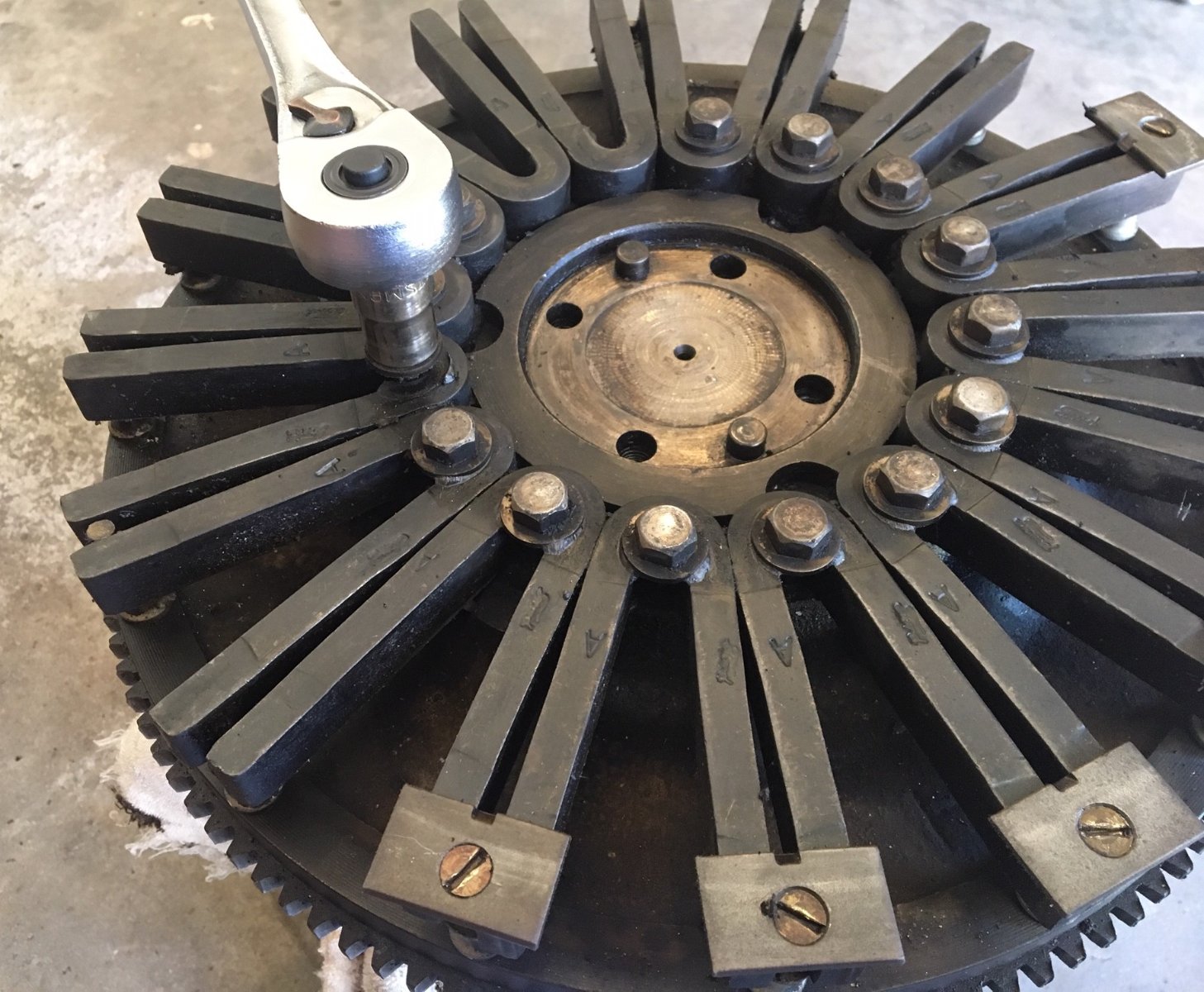

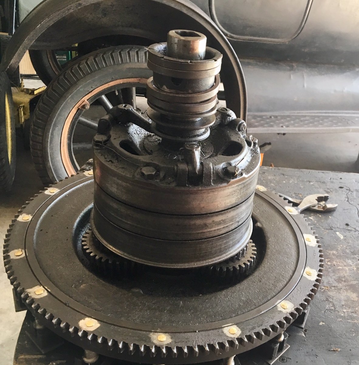

Big step forward today.
I replaced all the magnet screws with new ones then did a trial fit of the transmission to see what my magneto gaps were. Much to my amazement, it varied between .025 on one side and .030 on the other. I called that good enough and safety wired the transmission/crankshaft bolts.
Last project for the day was installing a new clutch spring. I was debating on whether to do it, but I'm glad I did go ahead....especially after placing the new and old springs side by side. The old one was pretty tired.

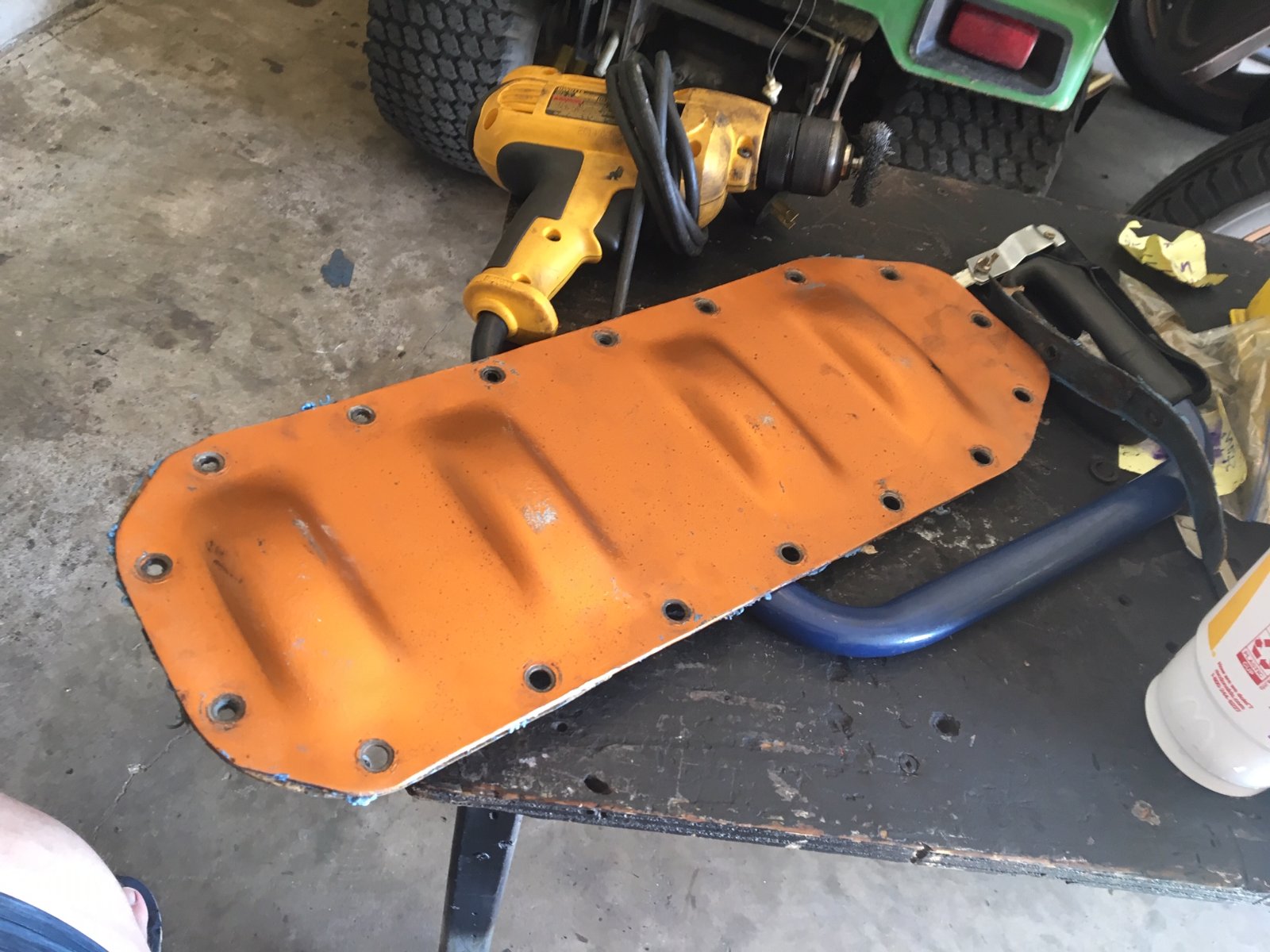

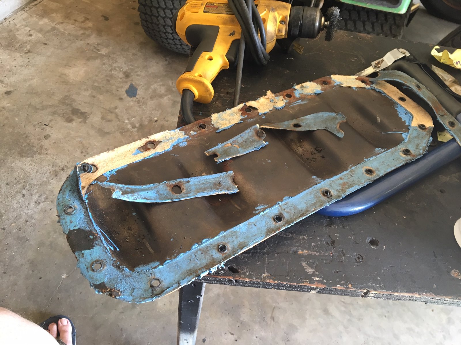

I kept the ball rolling today by cleaning up the oil pan and inspection cover and degreasing all the hardware for the oil pan and hogshead. I also have a new bushing for the crank handle. I wanted to get that installed today but the old bushing is really being stubborn about coming out. I think I'm going to have to collapse it in place and pull out the remains.
And...I'll say it again...I AM NOT RESPONSIBLE for the hideous paint or the copious slathering of the blue RTV on the inspection cover. This temp engine came that way in the parts chassis from the previous owner. Sometimes I think you should have to get counseling before you're allowed to buy RTV.

" Sometimes I think you should have to get counseling before you're allowed to buy RTV.
That goes right along with one of my many sayings of many years; "Some people should be banned by law from ever touching a screw driver or any other common hand tool!"
Some people simply CANNOT handle simple tools or mechanical anythings.
Truly tragic. But could have been funny if it weren't so sad. When I was in the sixth grade, a girl in my class, and neighbor just over a block from where I grew up, her dad was killed changing a light bulb in the living room. He was well known in the neighborhood for being totally unable to handle anything mechanical.
Enough said about that. Back to better things! Like working on model Ts for the mechanically inclined!

My dad has a friend who is like that. My dad has always said he could break an anvil with a rubber hammer.wayne sheldon wrote: ↑Mon May 06, 2019 4:43 amHe was well known in the neighborhood for being totally unable to handle anything mechanical.
When I was a kid, we pulled into his driveway one Saturday afternoon and he had his F100 rear end jacked up high, under the center section. He was laying under the truck with no jackstands, furiously yanking on one of the leaf spring shackles with a crowbar, trying to pop it loose. The whole truck was swaying dramatically as he did this.
My dad saw this as soon as we entered the driveway and ran screaming up to him yelling "STOP, STOP, STOP!!!!!" Fortunately he did.
This same guy, in an effort to fix a plumbing problem, knocked a hole in his garage drywall that was roughly the size and shape of a grizzly bear. The hole stayed that way for years...it always sort of intruiged me.
On another occasion, the three of us were headed to the Laguna Madre early one morning to go fishing in my dad's new boat. We saw a huge rattlesnake crossing the road in front of us and my dad's friend wanted to stop so he could kill it for the skin and rattle. We stopped and he ran back to the brand new boat and retrieved one of the brand new hardwood paddles to use to smack the snake on the head. On his first swing, he missed the snake by a mile and hit the road instead. The paddle broke in two and the snake slithered off, unharmed, into the brush. Without saying a word, he got back into the truck as my dad silently stared at him for a minute, just like a scene from a Laurel and Hardy movie. Then my dad, put the truck in gear and we pulled back onto the road and continued our trip. Neither one of them said a word about it.
This man was, and is, the nicest and best sort of human being though....always has a smile on his face and a song in his heart, so my dad has always looked past his mechanical shortcomings.

Same guy must have been through my T engine also... they loved the blue stuff. If a little is good more must be better!RustyFords wrote: ↑Sun May 05, 2019 11:19 pmAnd...I'll say it again...I AM NOT RESPONSIBLE for the hideous paint or the copious slathering of the blue RTV on the inspection cover. This temp engine came that way in the parts chassis from the previous owner.
Great progress, keep up the good work!

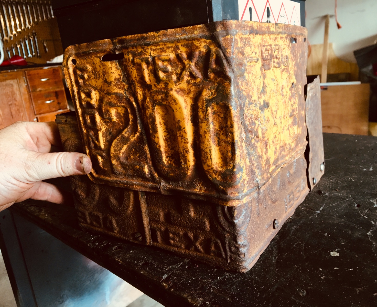

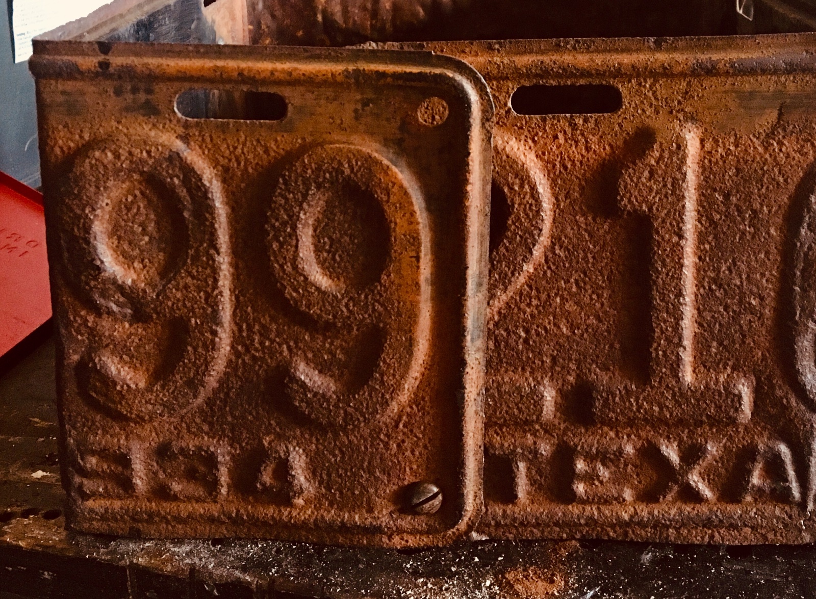

My car was missing its battery box so I decided to make one that fit the “use what was available on the Great Depression era farm” theme.
I figured pre-war license plates would fit the bill. It has a cut down piece of 2x12 wood for a base.
It’s a work in progress, but I think it’ll turn out pretty neat.

Nice period screws Don. Its all the details, right? I like the theme.

I figured you’d catch that Dallas.Dallas Landers wrote: ↑Sun Jun 02, 2019 10:04 pmNice period screws Don. Its all the details, right? I like the theme.
My goodness I’m having fun with this gigantic art project that also happens to be a car. I may not be able to contain my excitement once it’s actually mobile.

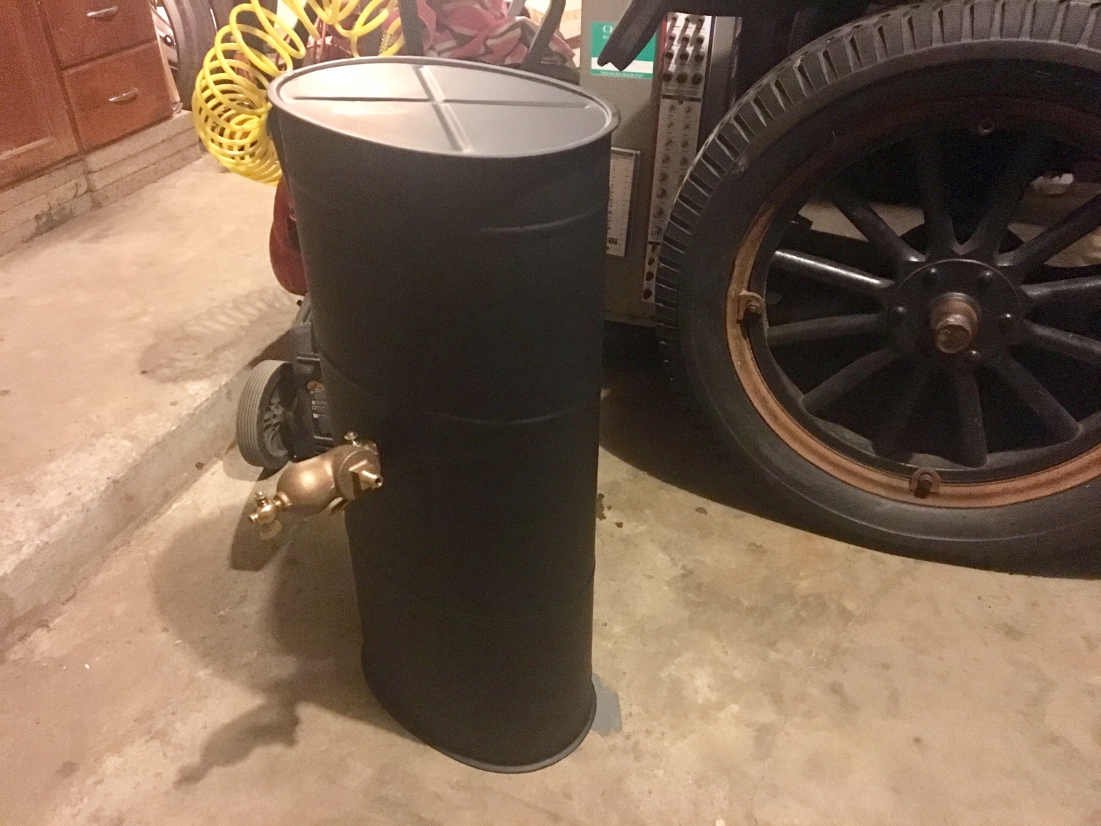

The new Rootlieb tank arrived today so I gave it a few coats of flat black so it’ll be dry by this weekend.
Now everything between the gas cap and the intake manifold is new (tank, sediment bowl assembly, fuel line and rebuilt carburetor). I’ve learned from the school of hard knocks with old cars that have been sitting for decades...if you can afford to go ahead and replace the whole fuel system, you probably should. It saves a lot of time and frustration,
In the end, I’m glad my leaky fuel tank forced my hand on getting a new one.

Re: 24 Touring Barn Car Revival - Part 3
VICTORY!
We took the T for its first run around the block this weekend. I still have a grin on my face.
My son took a video that I'll get posted soon.
It was a mixed bag...with some very amatuerish mistakes on my part. I started the car up and backed it out of the driveway then put the handbrake forward and, in spite of me knowing that I needed to advance the throttle a bit before taking off, I forgot to do so and killed the engine when I stepped on the pedal for low gear.
Then, I got flustered and restarted the car but left my foot on the starter button for about 5 seconds....all the while wondering what that grinding sound was. It was the starter of course. So...I successfully launched the car in low gear, drove about 100 yards then attempted high gear and lurched the thing like a complete amatuer.
We made the 1 mile loop around the neighborhood and parked it.
I attempted another, longer run later (4 laps around the neighborhood) and things were going well until the beginning of the last lap when it started running badly...struggling for power and missing a lot. I made it back to the house and parked it. I can't find my heat stove pipe (it disappeared sometime in the last two years) and this being Houston, the temps are in the 90's and the humidity is about the same as the inside of a dog's mouth. I noticed that the carb was covered in condensation and cool to the touch even though the engine was hot.
So, I'm guessing that had alot to do with the power/missing issue. I ordered another pipe from Langs.
Another "problem" was the ancient tires that have been sitting for years in basically the same position. Once I was underway, their lack of roundness and overall pliability was comical. I ordered 4 new tires and tubes from Summit.
Ross wanted to put o-rings on the pedal shafts and I let him, but the pedals are not readily returning when I let off of them and I'm wondering if that's the cause. I'll pull off the trans inspection cover and take a look at that.
BUT....the overall story is that the old girl is a real, running driving car for the first time in lord knows how long....at least since 1969, but if I had to guess, I'd say that it's been much longer than that...probably since the end of WW2.

I’ve been staying busy on the T when time allows and have the following projects going currently:
- installing a new generator and cutout
- replacing the short honeycomb radiator with a new, tall one from Berg’s.
- installing Fun Projects coil box kit.
- adding a running board luggage rack and a vintage suitcase containing oil, gas and water
- installing a remote fuel cut off valve handle made out of a vintage bathroom sink handle.
I’ll get some photos of all of this made soon and will post them.

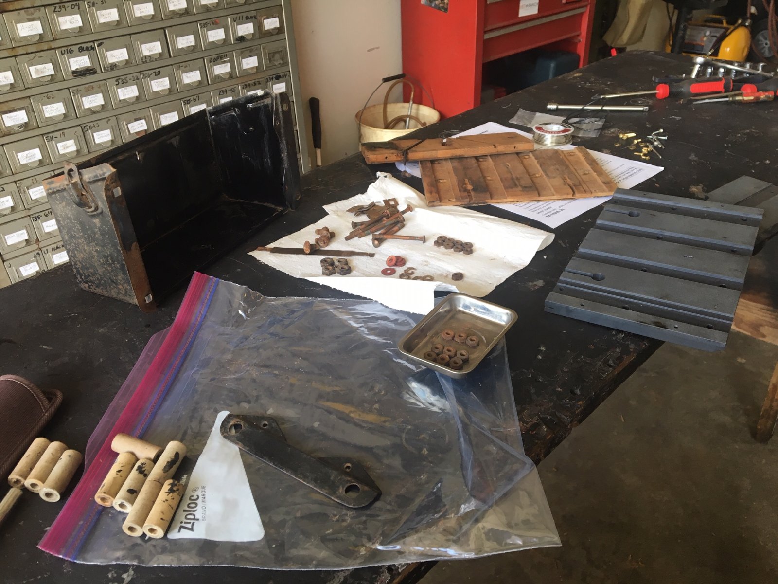

From the outset, I suspected that the coil box in my car was most likely OEM and had never been touched or maintained. I knew this couldn't be helping the car any as far as running smoothly, so I ordered a Fun Projects Coil Box Kit and, over the weekend, installed it.
It was fairly straightforward but one does need to follow the instructions in order to get it right. The one step I skipped was soldering the contacts to the posts because I didn't have any rosin core solder. At some point in the future, I'll probably pull it back apart and do this.
After the reworked box was installed, all hard starting and intermitent missing issues were resolved. I'm sure that my rebuilt coils were not making full contact in the old box.
The most surprising improvement was the magneto performance. I'd never noticed the "surge" in the engine that so many people report when switching to mag. My car tended to run about the same or slightly worse. After the rebuild, the surge is very noticeable.
I am very pleased with the outer appearance of the box. It's a rust-free (gotta love the way west Texas preserves old metal) Ford stamped piece wearing the same nicely weathered factory paint as the rest of the car. And, like the rest of the car, it responded nicely to the Penetrol treatmemt.
