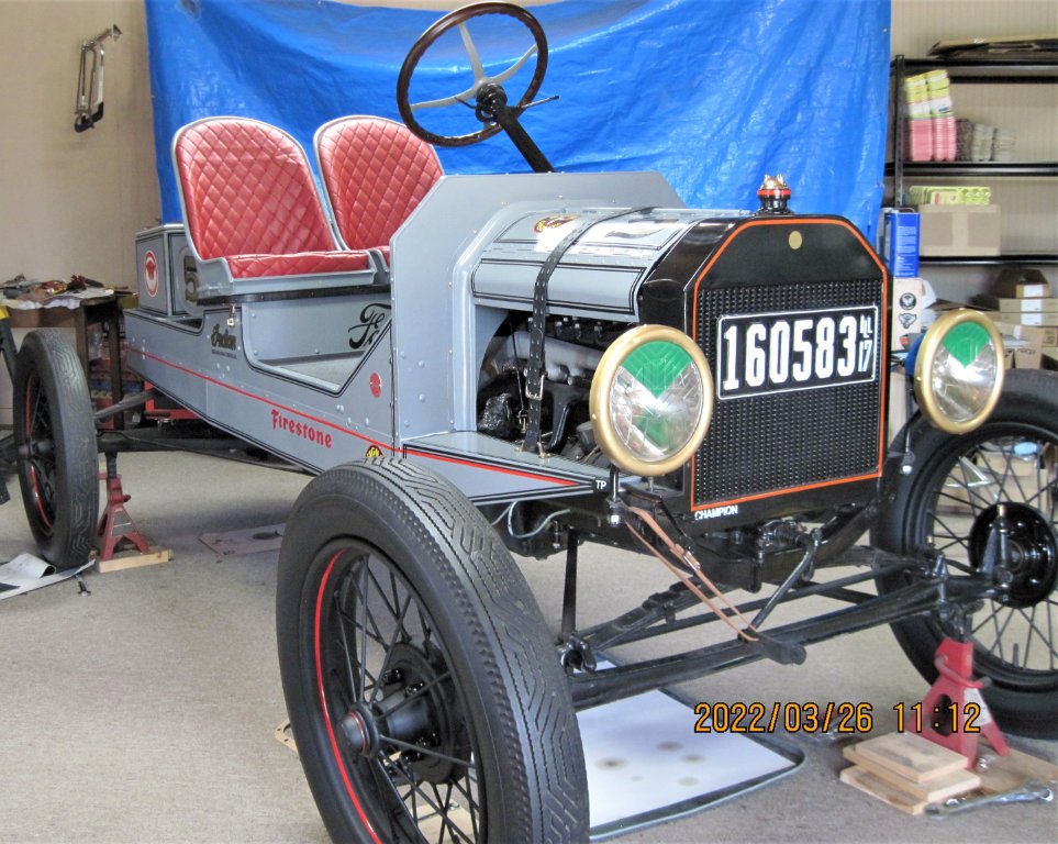

Post by Caswell » Wed Mar 16, 2022 3:42 pm

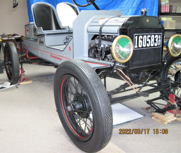

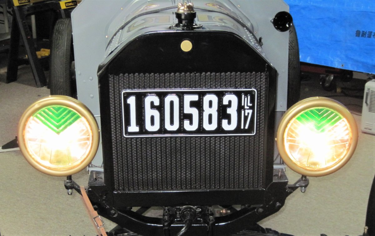

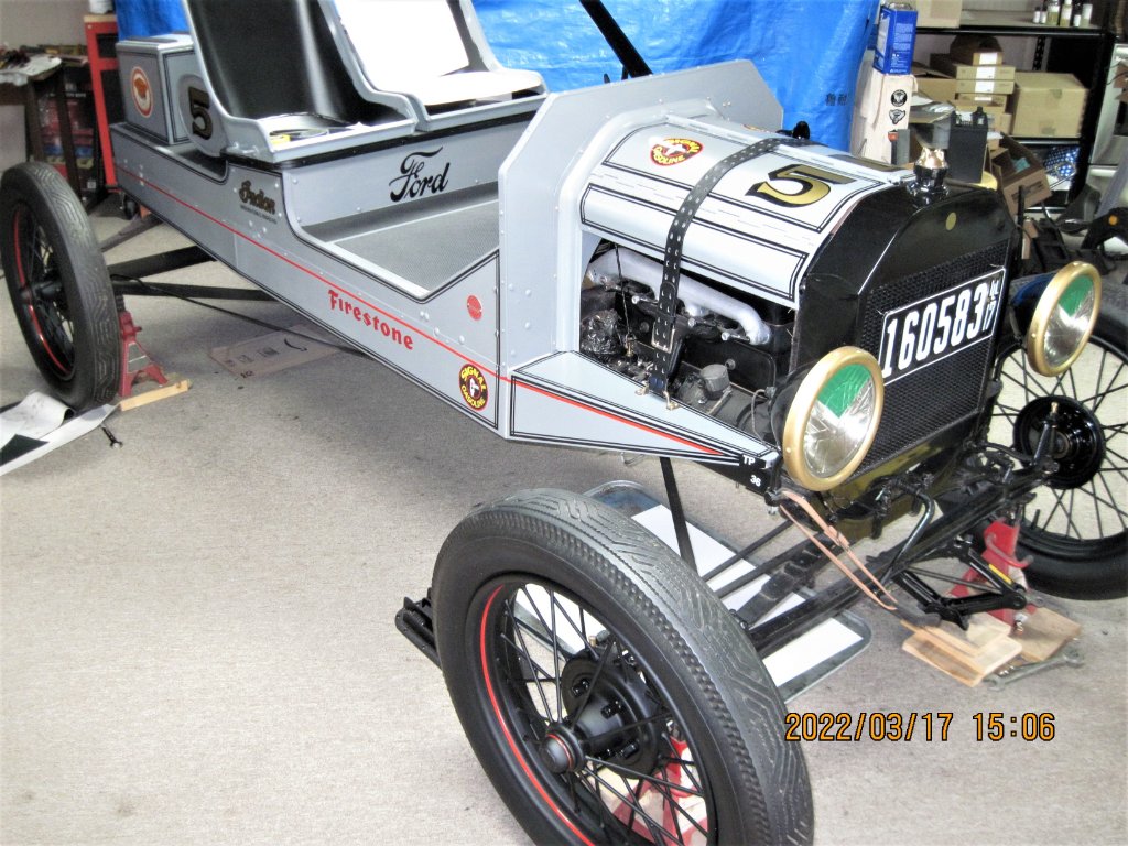

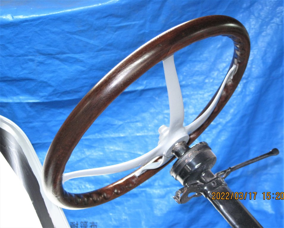

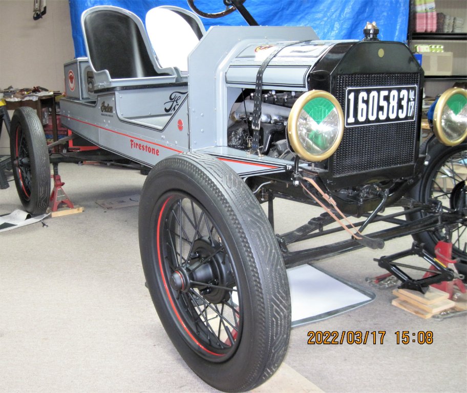

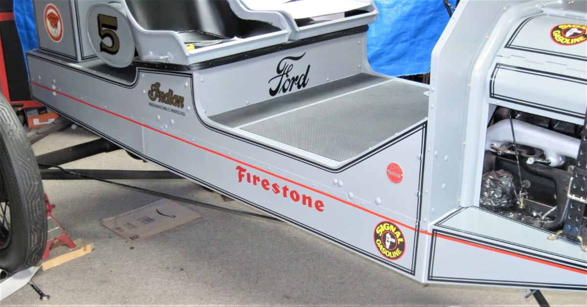

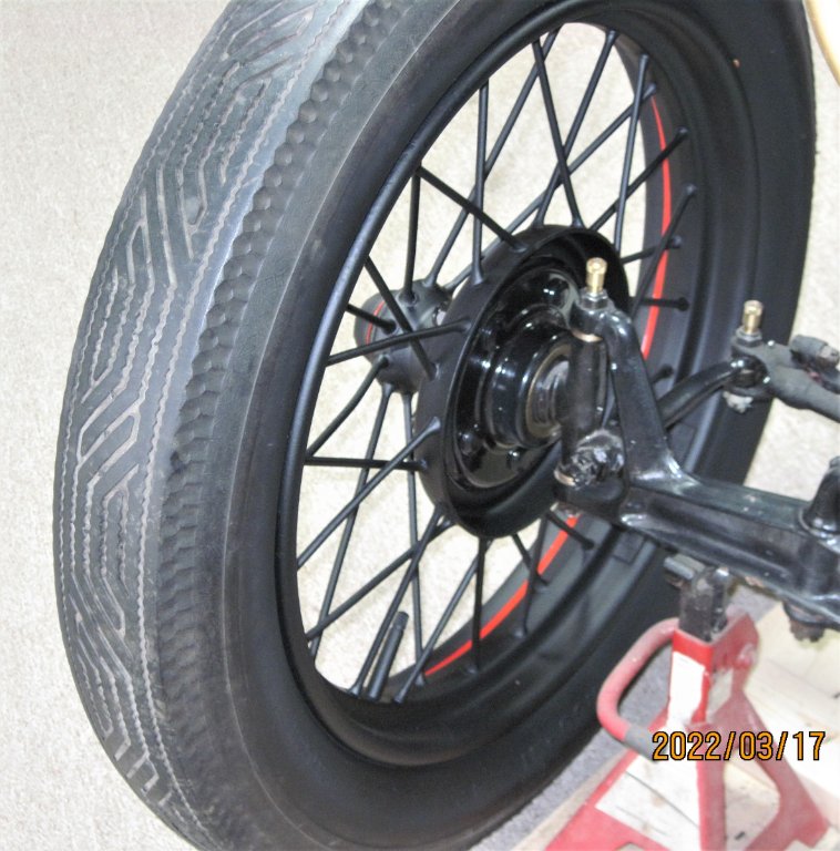

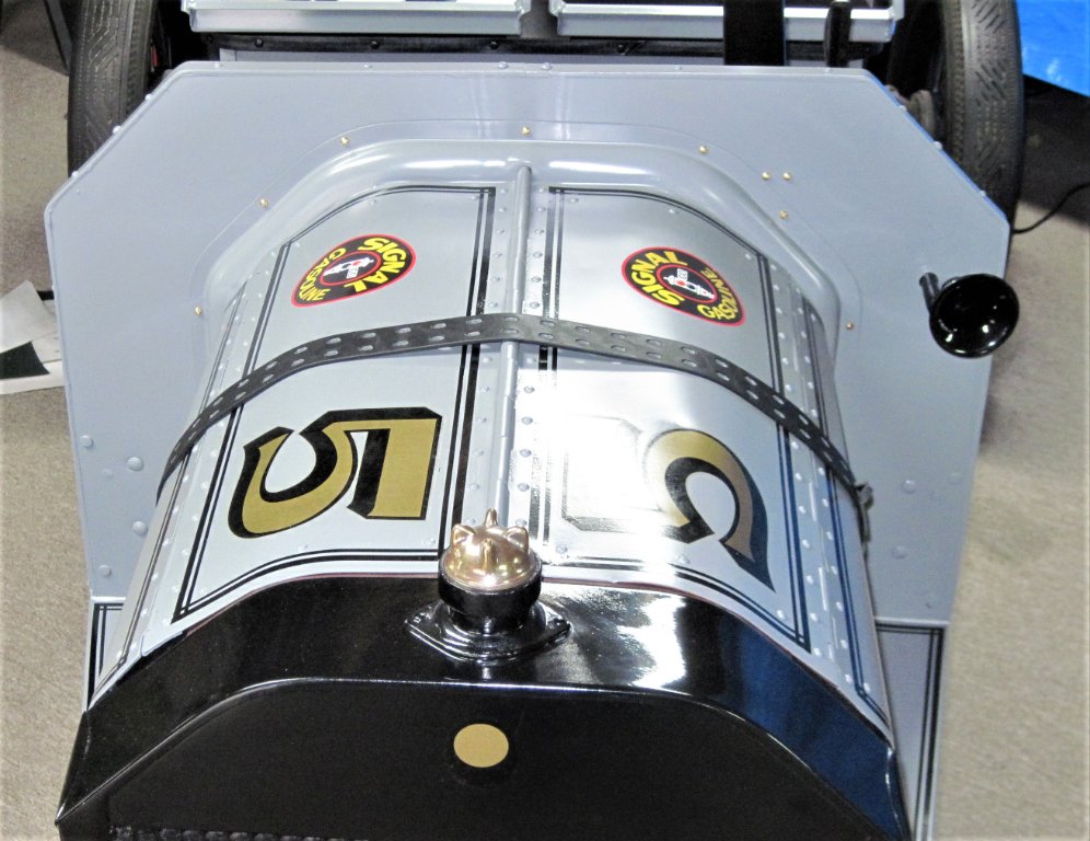

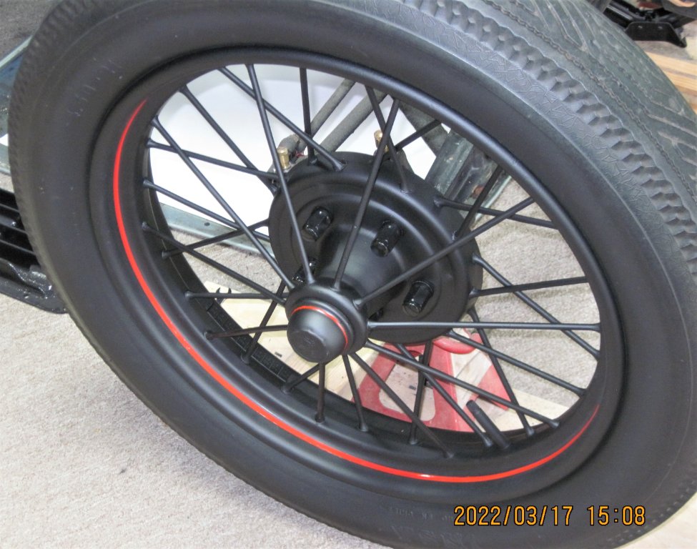

Did some more to the car, last decal set (gas), red line down the side and painted wheels, finished wiring and hood strap, refinished steering wheel.
Pictures are in no particular order, still have to make a step and do the upholstery when the leather shows up.

More pictures

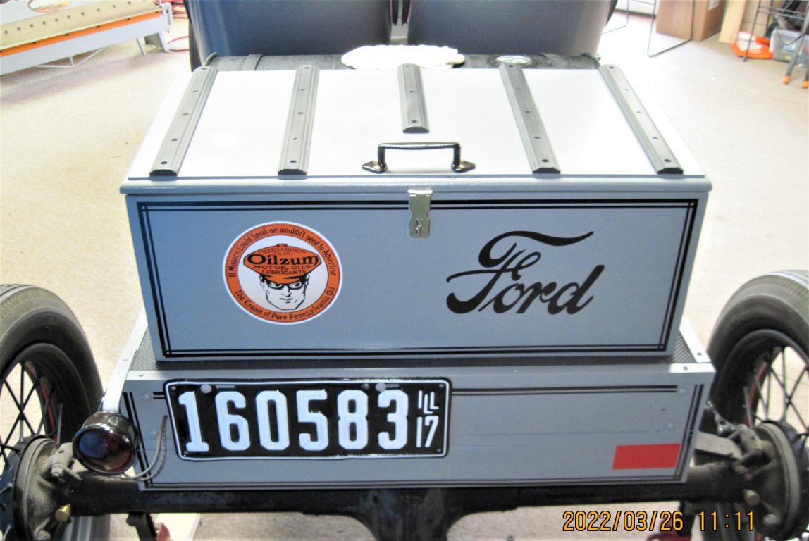

Post by Caswell » Wed Mar 16, 2022 3:49 pm
The last of today's pictures, a few people are interested in the progress but I promise to stop posting after the seats are done ;).

Post by TRDxB2 » Wed Mar 16, 2022 3:51 pm
Copy Cat... looks like what I have on my daily drive :oops: ;)

Post by Dallas Landers » Fri Mar 18, 2022 6:50 am
Nice job Dean. She is a real looker. I like all the decals.

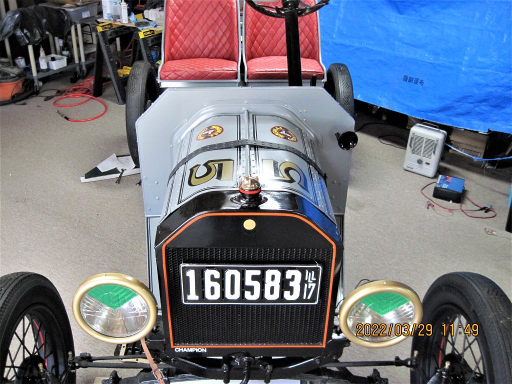

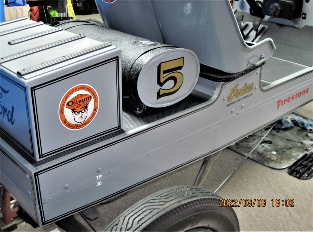

Post by Caswell » Fri Mar 18, 2022 9:58 am

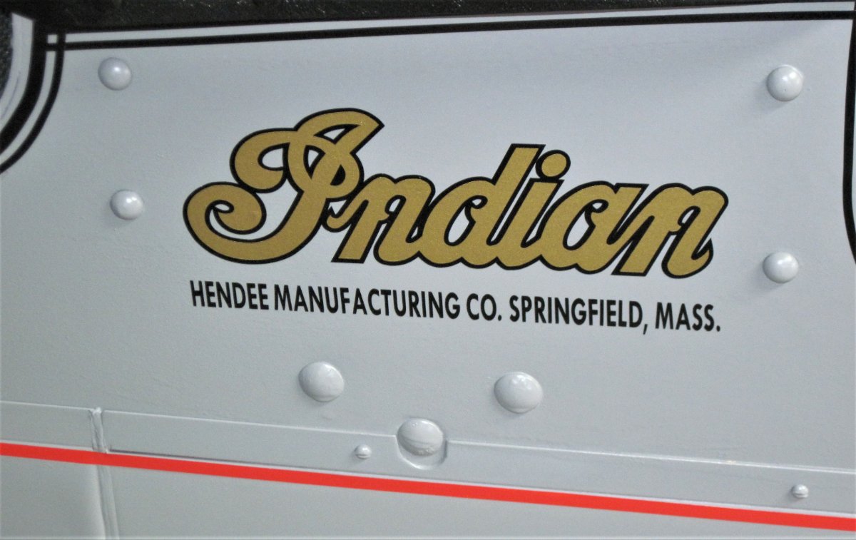

Thanks again for positive comments Dallas, I figured if it was going to look new (ish) that sponsor decals would not look out of place, all are period correct with Indian and Oilzum being from the same State, Firestone appropriate for Ford/race car.
I'm reasonably happy with the way it's turning out, more so as I did everything myself, fabricating the body and painting it, reuse/refurb of good condition original Ford hood, original Ford hood former, Ford coil box, Ford headlights, original accessory radiator, steering wheel and NOS taillight and the list goes on, seat cushions and backs next along with a step.

Post by DHort » Fri Mar 18, 2022 11:37 am
Dean
It is looking better than I expected. You have a talent for color. Too much black and you would not like it. I suggest the dark grey for the seats. Will give it a nice contrast, and black would be hot. What does your car look like with the seat up?
I think I might steal the red stripe on your wheels.
Your license plate and registration sticker say you are a flatlander, but your address on the side says you are a tarheel???

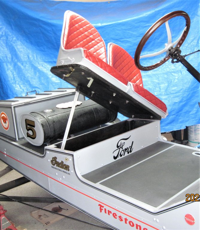

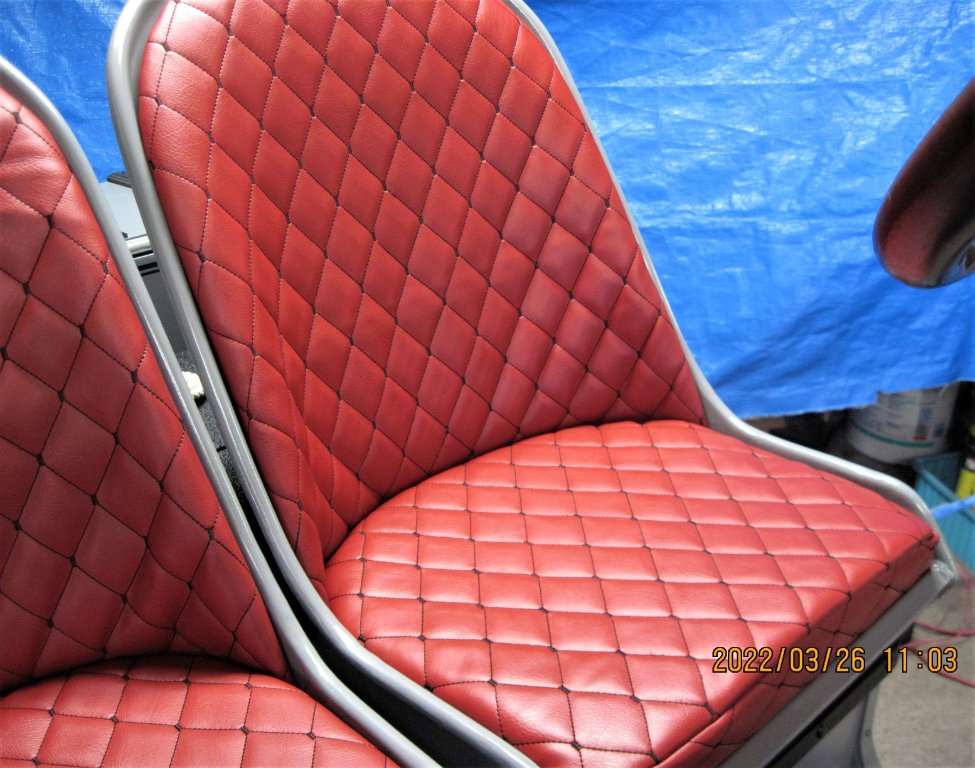

Post by Caswell » Fri Mar 25, 2022 11:59 am
Dean

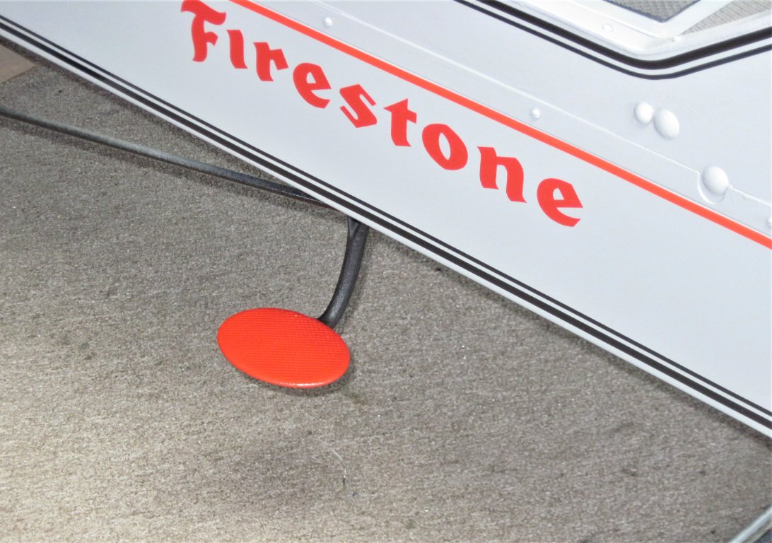

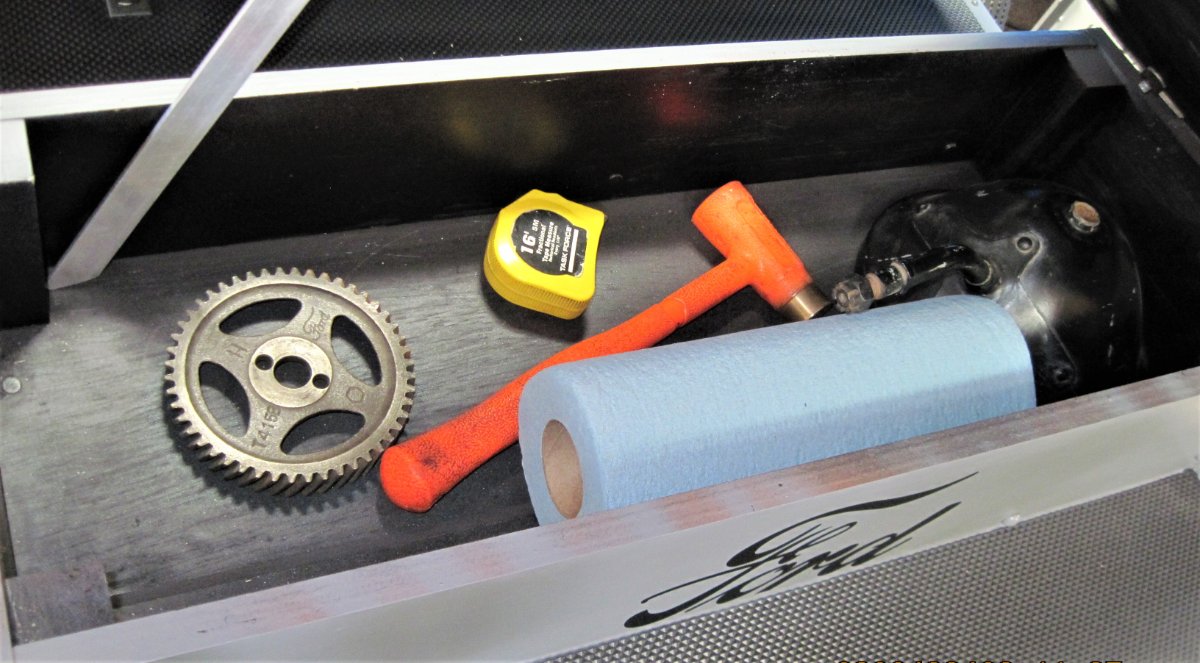

Thanks Dave,

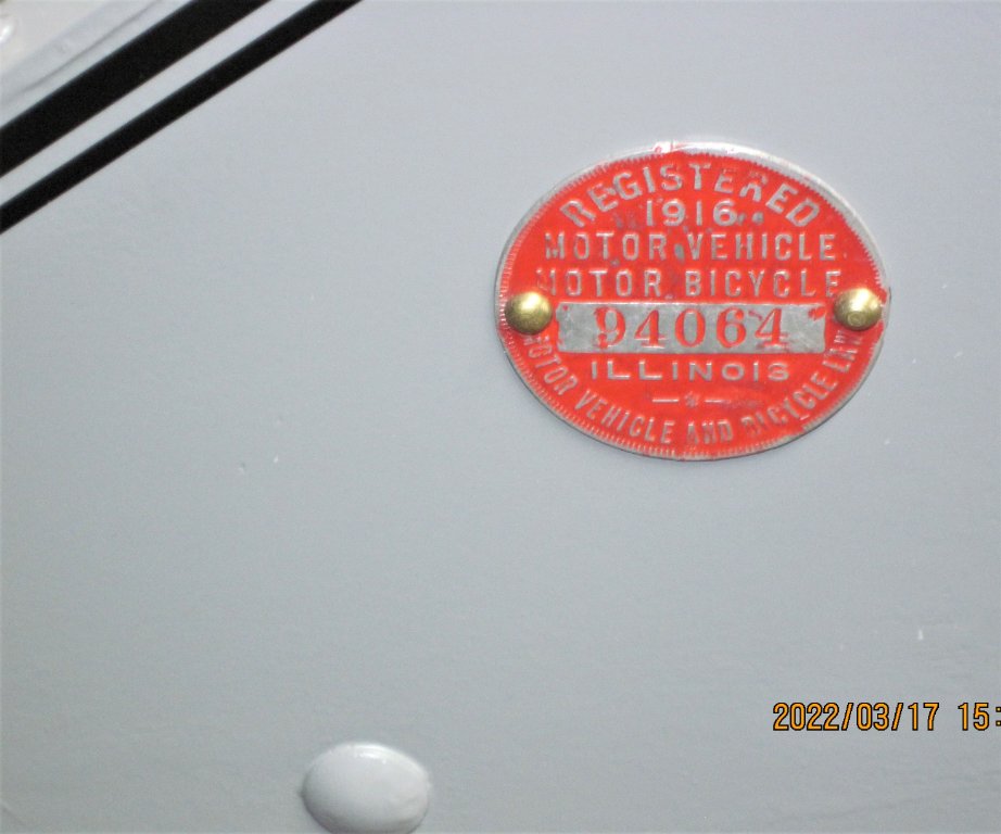

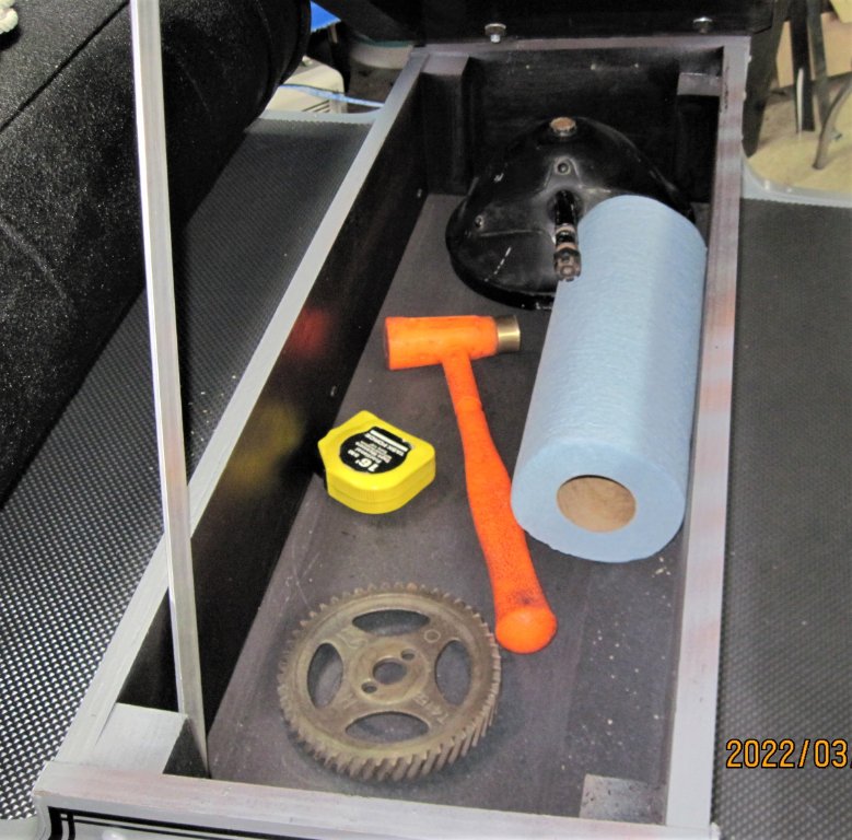

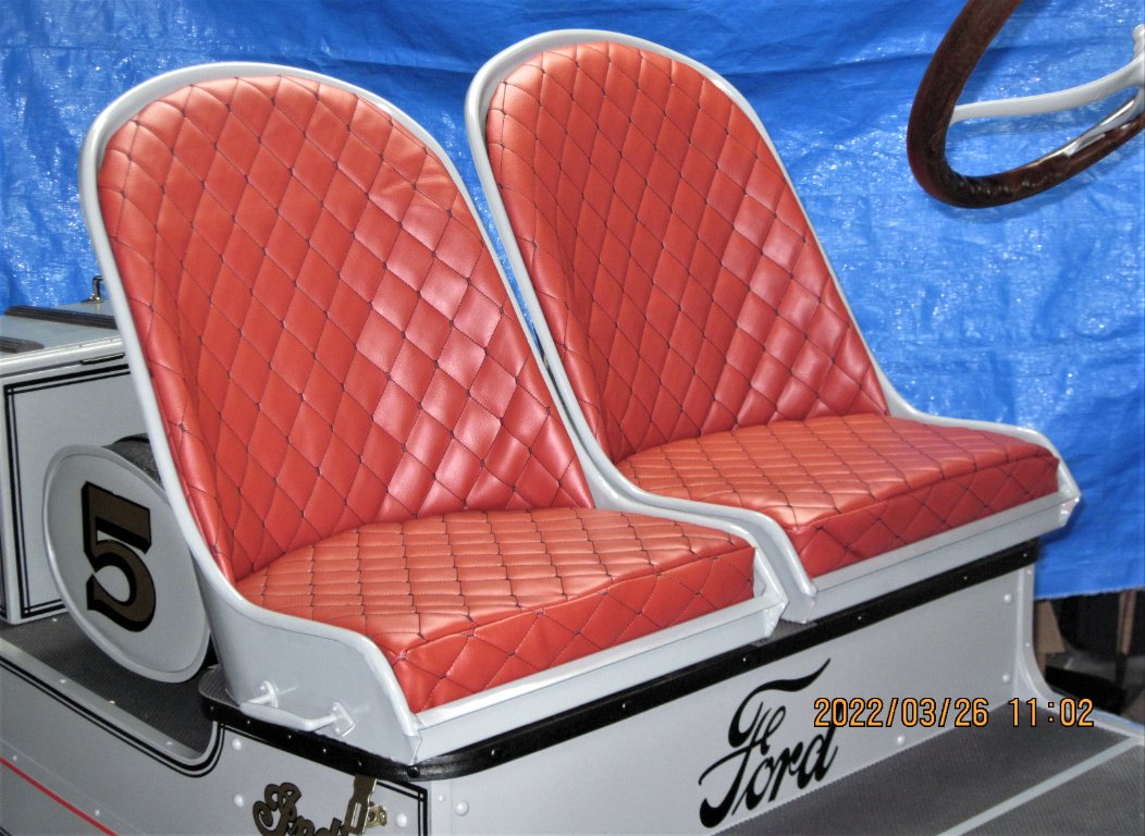

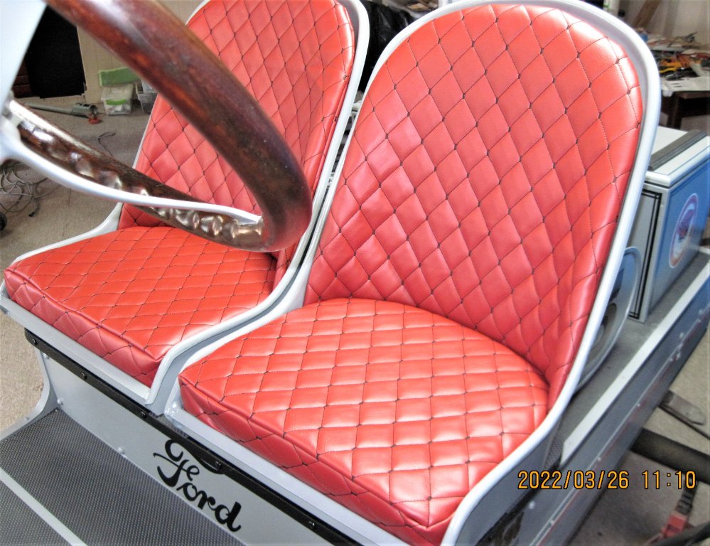

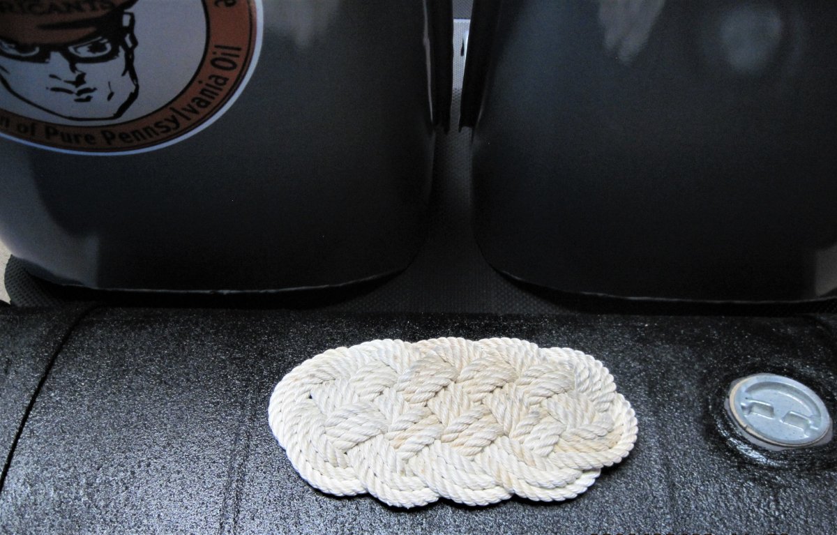

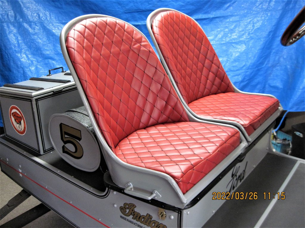

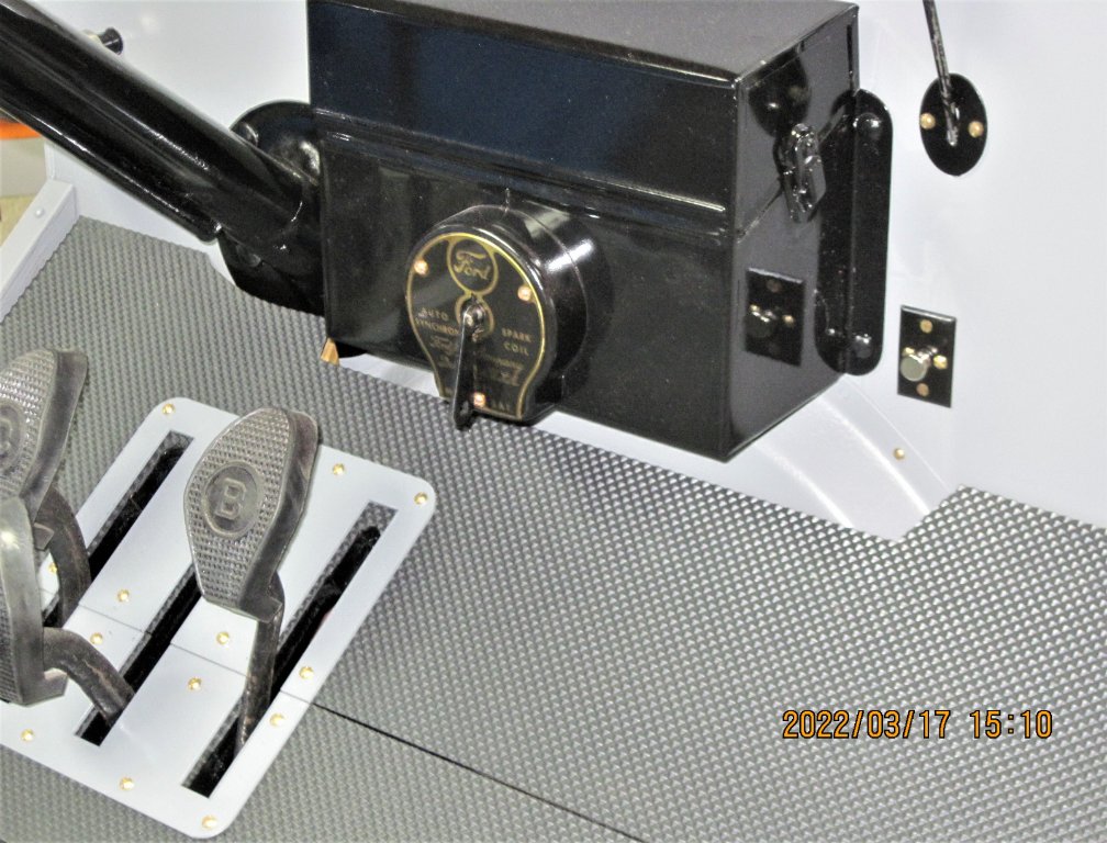

Sorry for the late reply I wanted to finish the seats before taking more pictures. My wife and 92 year old mother in-law finished the seat upholstery today (half hour ago), no snaps or staples needed, pictures show seats in the up position to access the storage under. Woven rope I did years ago stops box lid from hitting gas tank (in a picture). The original aluminum registration dash tag I found in the car so I thought I would keep with the theme and purchased a set of original tags to go with it (front tag is slotted), I'm in NC. Johnny Cash car.
Almost done, step is my next job.

Your wife and mother in law deserve two thumbs up on those seats. That color really sets off the whole car.
You could do a series of posts on how they did those seats.

Post by Caswell » Mon Mar 28, 2022 12:05 pm
Thanks Dave. Did the step yesterday along with new fuel line, all that's left is some cotter pins, safety wire, coolant and change the oil.
Time to clean up the shop, will also be listing the car in the classified area I think $7,500 is fair.
