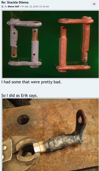

Steve, was the broken shackle one of these?

...was the broken shackle one of these?
The short answer is, I don't know. It may have been one of the really bad ones, or one that was less worn, or one that I didn't have to build up at all. Unfortunately I didn't keep track of which ones I used where.

I go through literally tons of old car parts every year, and have for almost 5 decades now. I don’t ever recall seeing a broken shackle, ever. Model T or A. I also throw away lots of stuff. That was a bad idea when you did it, and spoke up then. It was an even worse idea for a national club to print the how to article. Back in the day of ford model t, they told their mechanics to destroy stuff beyond use BEFORE it was thrown away.
If you aren’t sure which one it was, it would make sense to me replace the unknown others, so nobody is hurt or killed. Remember, we are simply caretakers of these old cars. Someone else will someday take over, and we need to be sure they are safe. Same goes for smearing JB weld on something, another pet peeve of mine. Rant over.

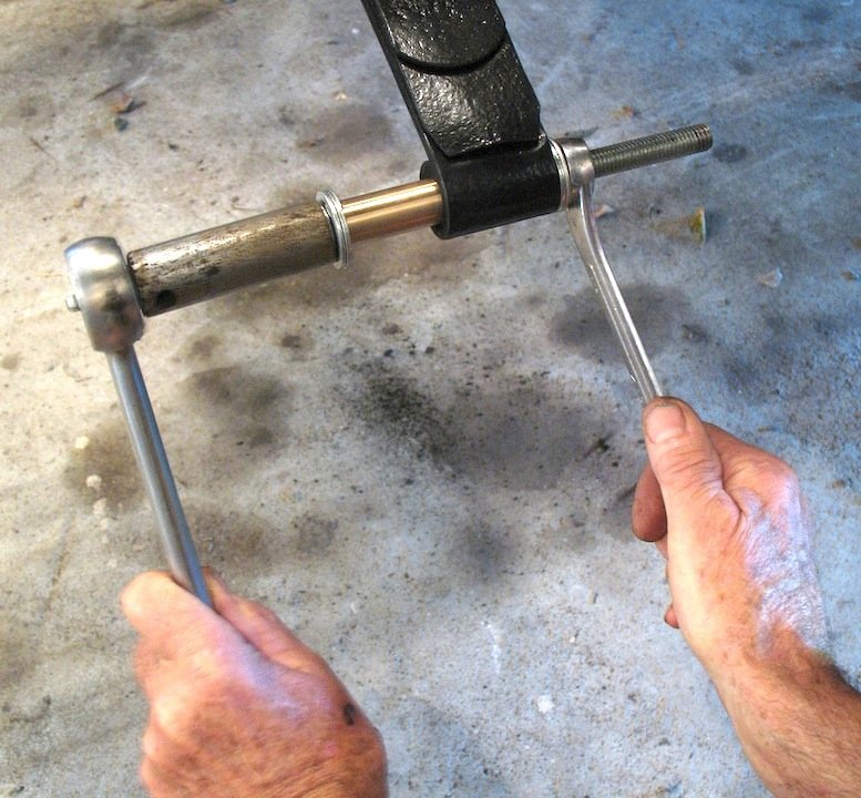

That brings up another question. Are the reproduction figure eights any good, or should I be looking for good originals instead? I'll be watching for originals, but I wonder how the quality of the new ones is.
Dropacent
Posts: 3384
Last Name: Morsher
Location: Norwalk Ohio
Re: Here I go again .... to OCF
Post by Dropacent » Wed Sep 18, 2019 3:13 pm
Steve, Chaffins have been making and selling them for many, many years. Decades ! If they weren’t any good, I’m sure we’d have been talking about injury lawsuits by now. Only a guess but they are either forged as original or cast steel. Perhaps mr Chaffin can answer that, and hope you can share the answer. Great or NOS originals of those have always been easy to find in past years around here, but as our cars get older, great reproductions may soon be the only way to go. It’s also very beneficial to use bronze sleeves, instead of fords bad idea of rolled steel.
Posts: 7411
Post by Steve Jelf » Thu Sep 19, 2019 12:31 am
Yep. I agree on the bushings.

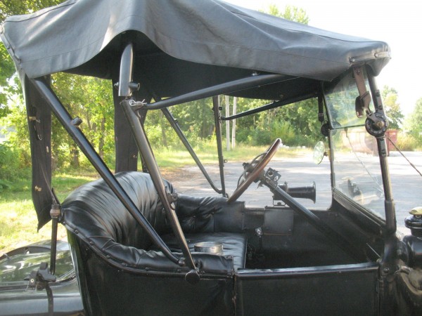

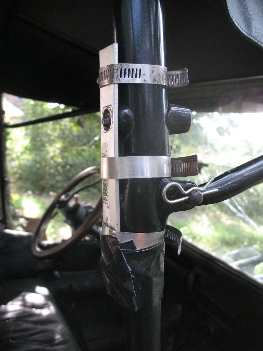

Before starting out in the morning I took some shots of my wounded top.
At this point the upright was completely broken, with the top part sitting on the bottom part.

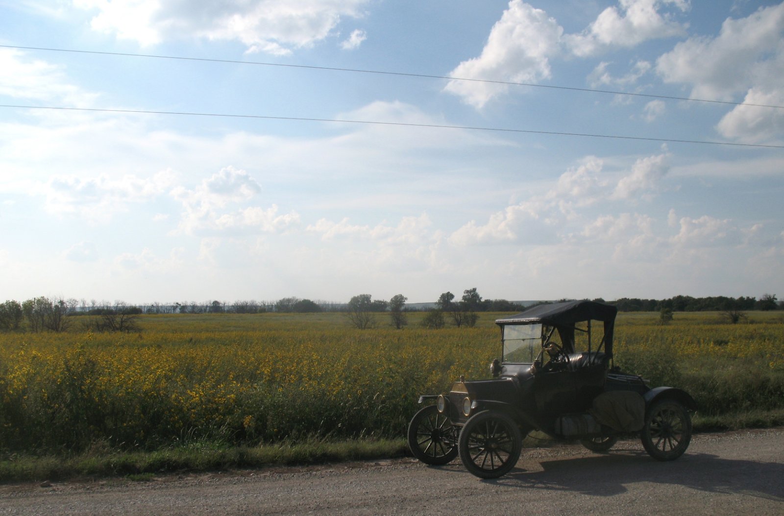

Along the road west of Moberly. September is the time for goldenrod and sunflowers.
Lots of sunflowers were out in Missouri.

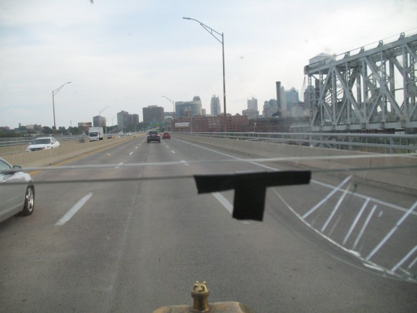

I made an afternoon stop in KC MO to visit some of the cousins, then headed south across the river into downtown. I was happy to find that after following this route last year, seeing it again made me remember most of it so I didn't have to do a lot of map checking.

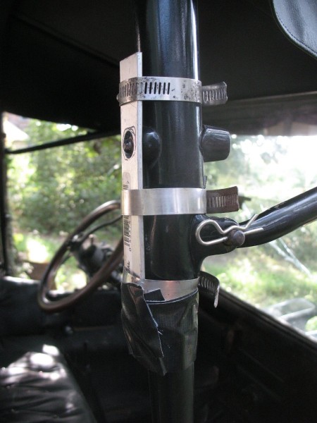

I stopped at Bud & Karen Redding's place to ask Bud if he might know of a possible top socket source I hadn't thought of. While I was there Bud applied a splint to my broken upright.
Bud's splint: a piece of angle aluminum, three hose clamps, and Gorilla tape. That will hold it until I find a replacement. I already phoned Model T Haven, and Mark said these roadster uprights are mighty scarce. Steve Lang suggested a possible source, but if that doesn't work out I may take the piece back to Bud, who says you can fix anything if you're smart enough. Actually, I think the right repair could make this piece stronger than a new one.

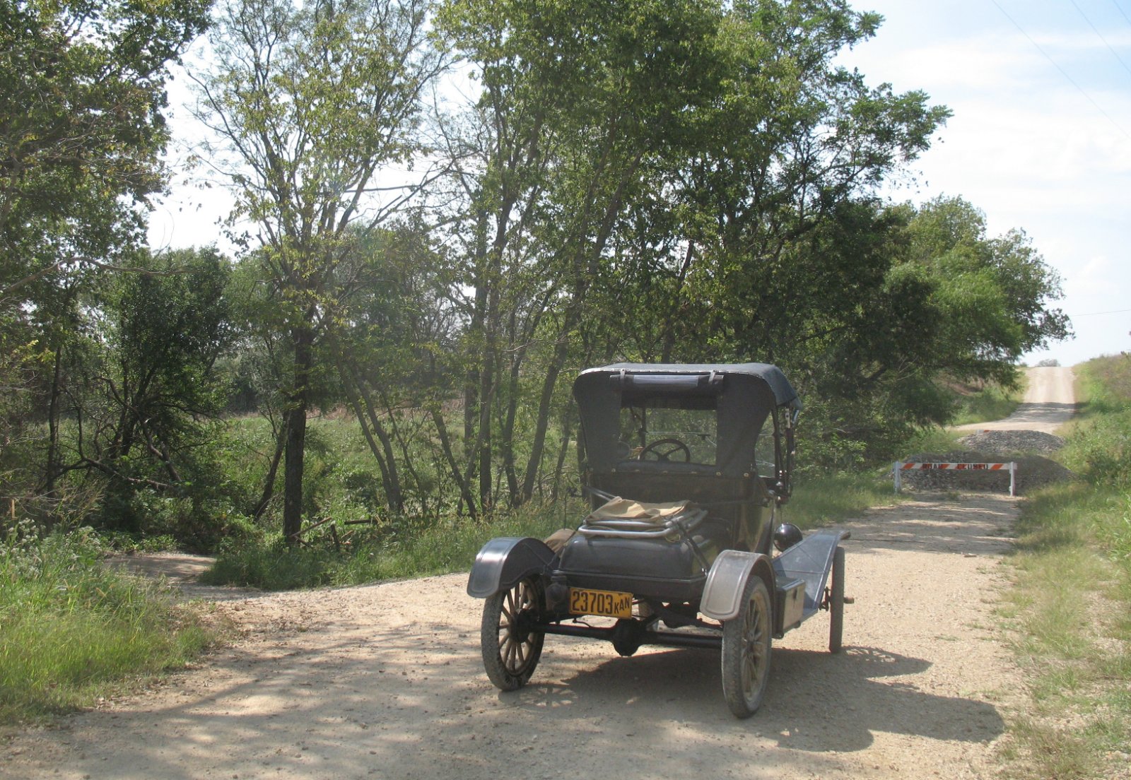

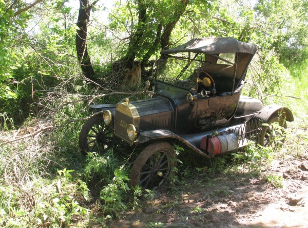

Uh-oh. It's really washed out. Fortunately the low-pedal detour down into the gully and back up to the road is dry.

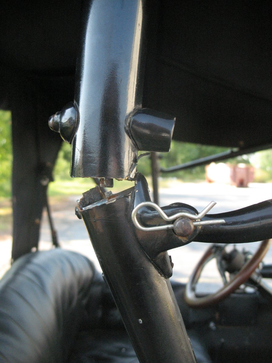

Steve, just a shot in the dark here. I have noticed that the center bow on your top looks to be too long, the top doesn't seem to fit quite right. The pictures of the break in that bow looks like it may have been cut down and welded back together at some point with the weld having been ground down which weakened it. The break is almost too straight across to have been a failure of an original bow. Have you ever done any measurements on it? Just a thought from someone that doesn't know squat about roadster tops but does have some experience with welding. :) :) Dave

Steve, Here is the “frugal fix” for your broken top iron: Take it to your engine builder. Leave the splint on it. Have him putty up all the seams and the break with babbittrite. Pour the iron full of scrap babbitt. It will be very heavy.

...the center bow on your top looks to be too long, the top doesn't seem to fit quite right.
Yes, I've wondered if the bad fit might be due to wrong top hardware. I expect the Classtique top would fit better on the correct sockets and bows. It never occurred to me that they might be wrong until I installed the new top and couldn't make it fit the way it should.
The broken upright is another story. I know exactly what happened there, and when.
May 28, 2016, was a sunny day, but recent rains had made this Marion County road a muddy mess. I was driving too fast, trying not to get stuck, and a patch of sand that had washed across the road put the car in the ditch, where it hit some branches that broke the upright. An old body man I know made it look like new, but it was weakened enough for the battering on this trip to break it again.

I remembered that post from 2016, as I read about the top piece failing on this
trip, and wondered if the two issues were related ....
