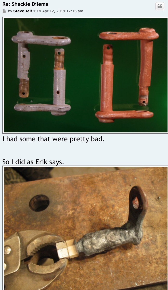

As far as the shackle goes, it wouldn't be one of those new cast ones would it? That is why I'd never buy one of those.
No, it was an original. The road was otherwise smooth, so I was moving right along, and the dips at both ends of that bridge gave it a tremendous jolt. I'm pretty sure that's what broke it. I'm glad my car has the wrong wishbone, or the wreckage might have been worse.

Steve, was the broken shackle one of these?

...was the broken shackle one of these?
The short answer is, I don't know. It may have been one of the really bad ones, or one that was less worn, or one that I didn't have to build up at all. Unfortunately I didn't keep track of which ones I used where.

I go through literally tons of old car parts every year, and have for almost 5 decades now. I don’t ever recall seeing a broken shackle, ever. Model T or A. I also throw away lots of stuff. That was a bad idea when you did it, and spoke up then. It was an even worse idea for a national club to print the how to article. Back in the day of ford model t, they told their mechanics to destroy stuff beyond use BEFORE it was thrown away.
If you aren’t sure which one it was, it would make sense to me replace the unknown others, so nobody is hurt or killed. Remember, we are simply caretakers of these old cars. Someone else will someday take over, and we need to be sure they are safe. Same goes for smearing JB weld on something, another pet peeve of mine. Rant over.

That brings up another question. Are the reproduction figure eights any good, or should I be looking for good originals instead? I'll be watching for originals, but I wonder how the quality of the new ones is.

Steve, Chaffins have been making and selling them for many, many years. Decades ! If they weren’t any good, I’m sure we’d have been talking about injury lawsuits by now. Only a guess but they are either forged as original or cast steel. Perhaps mr Chaffin can answer that, and hope you can share the answer. Great or NOS originals of those have always been easy to find in past years around here, but as our cars get older, great reproductions may soon be the only way to go. It’s also very beneficial to use bronze sleeves, instead of fords bad idea of rolled steel.

Yep. I agree on the bushings.

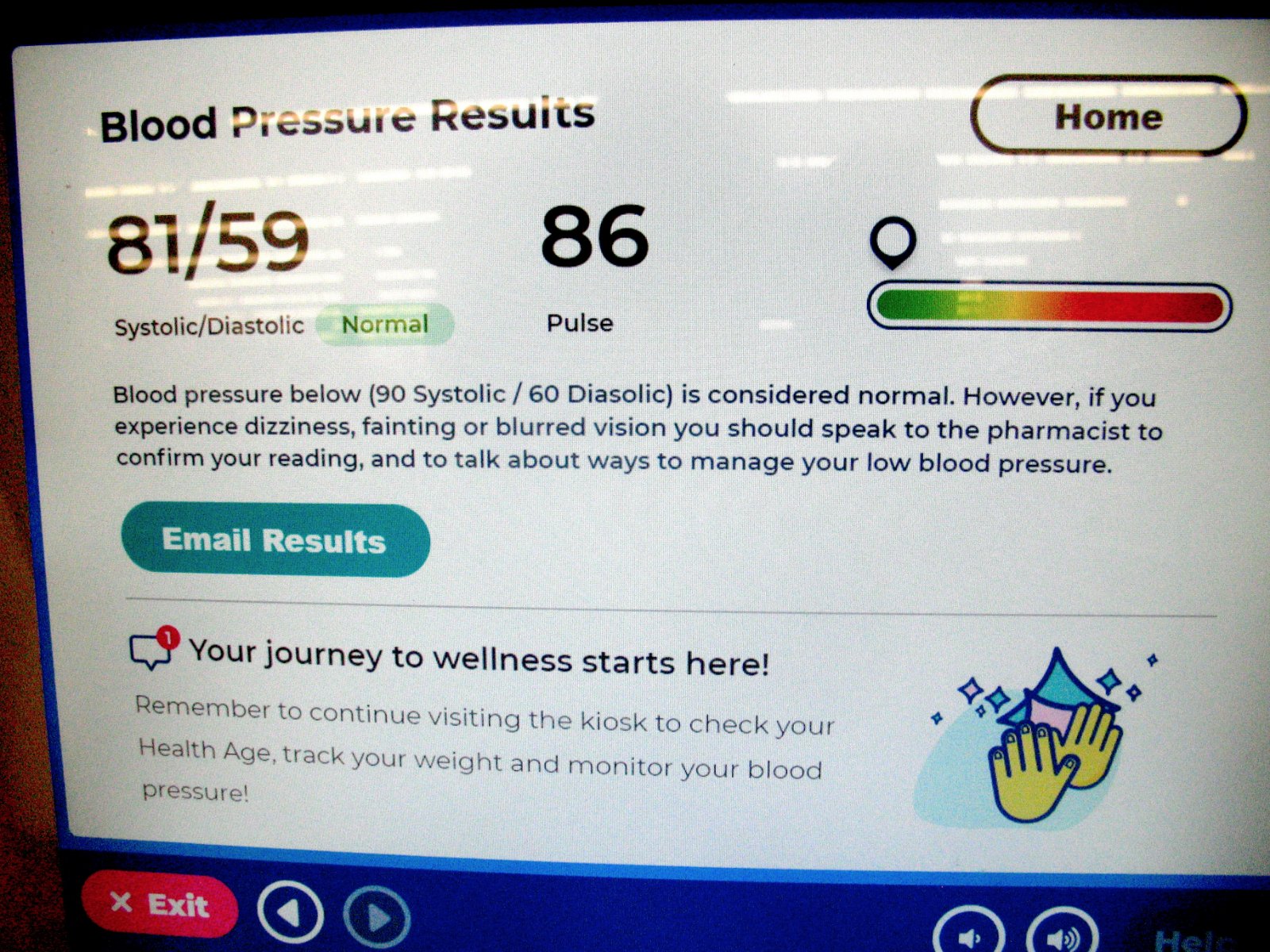

Stopping for the evening at 135th Street and State Line Road I used the test machine, and thought after our recent BP discussion some folks would be interested to see what Pursuant Health has to say on the subject.
