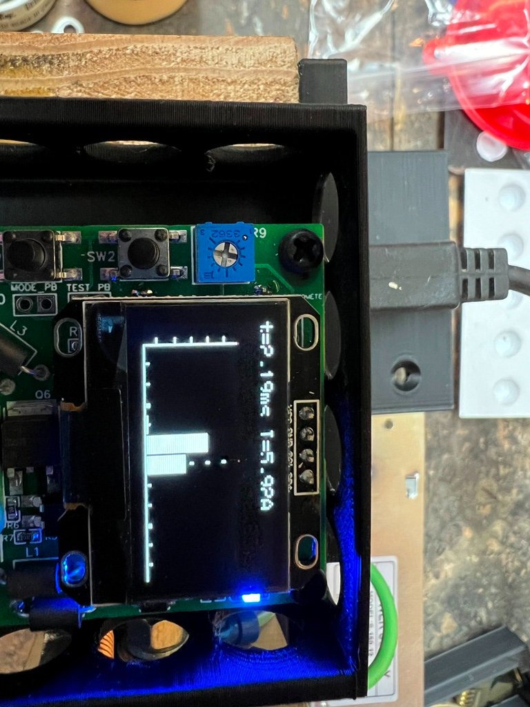

Not sure what's going on. The coils were buzzing in the car but I can't get them to buzz with the tester. I replaced the capacitor in one of them so it's showing a pass but I cannot get any of them to spark. Any ideas? What tests can I do? I have tried with a 12v battery and the 6v (9.4v) T battery.
Luke
Topic author - Posts: 617
- First Name: Luke
- Last Name: P
- Location: New Zealand
Re: A new DIY electronic coil tester.
Shawn,
I've never used one of Matt's boards so hopefully he'll turn up shortly to give some advice, however if you're able to read capacitance it suggests that at least part of the coil-tester connection is likely to be ok.
While we're waiting for Matt; it may be that the tester isn't switching properly (for example the FET could be faulty), if it were me I'd check that out with a 'scope, or possibly a suitable multimeter. Do you have either of these things?
Luke.
Luke.
Matt in California
- Posts: 823
- First Name: Matt
- Last Name: G
- Location: California
Shawn,Myxr6turbo wrote: ↑Mon Oct 02, 2023 10:18 pmNot sure what's going on. The coils were buzzing in the car but I can't get them to buzz with the tester. I replaced the capacitor in one of them so it's showing a pass but I cannot get any of them to spark. Any ideas? What tests can I do? I have tried with a 12v battery and the 6v (9.4v) T battery.
The joy of troubleshooting at a distance! From what you say, I assume the controller powers up and you see info on the display.
Spark LED
There are three LEDs: +5VDC, +12VDC and a Spark LED. The Spark LED should blink every time the Arduino sends out the pulse, so you should see it blink every time spark should be released. If there is a blinking spark LED then the issue is in the power circuit. Perhaps the Power is too low.
Power Supply
You should have 12 VDC input. If it is under 8 VDC the MOSFET will not work. What type of battery are you using?
After I hear, back on this we can discuss what next.
Matt

Thanks Matt for the reply. No the spark LED isn't flashing. The other 2 LED's are on. I used my 12v 700A car battery. I have 5 FACT boards so I ordered a new Arduino and screen but same problem. I'm looking to buy a 240VAC to 12VDC power supply. How many Amps does the FACT need to operate?
Thanks again,
Thanks again,
Matt in California
- Posts: 823
- First Name: Matt
- Last Name: G
Shawn,Myxr6turbo wrote: ↑Wed Oct 04, 2023 11:57 pmThanks Matt for the reply. No the spark LED isn't flashing. The other 2 LED's are on. I used my 12v 700A car battery. I have 5 FACT boards so I ordered a new Arduino and screen but same problem. I'm looking to buy a 240VAC to 12VDC power supply. How many Amps does the FACT need to operate?
Thanks again,
The unit doesn't use much current. I have found small 12 VDC 7Ah lead cell batteries are more than enough. I have also used various AC/DC adapters...
The two power LED show that you have voltage at 12/5VDC. You should see the third LED partially hidden under the display when you press SW2.
It looks like we have need to focus on the digital side of the circuit. From your earlier post I assumed that you were able to test capacitance, thus the Arduino/display are working, but your last post states otherwise.
When you load the program on the Arduino, do you get error messages?
What version of Nano are you using?
When I hear more, I hope to narrow down the issue.
Matt

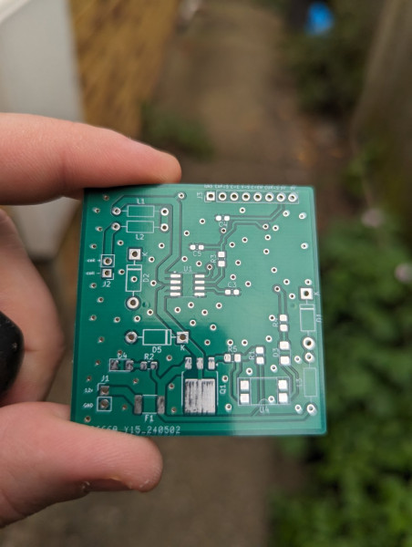

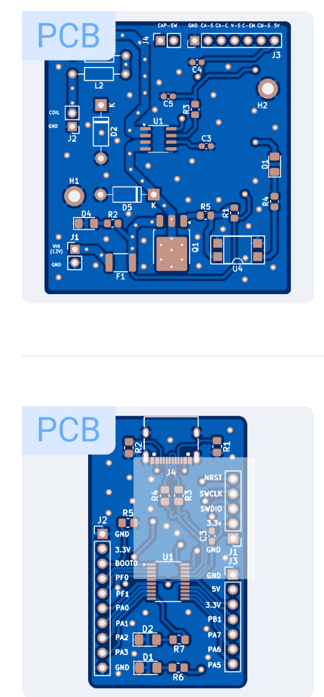

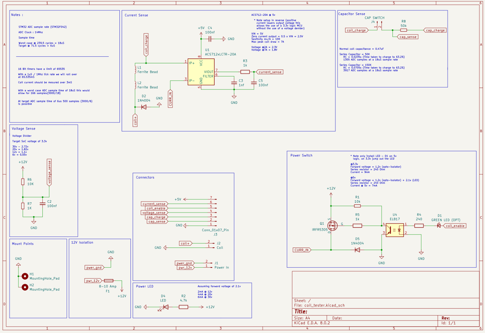

Currently starting a build of a FACT coil tester, my aim is to make 2 new versions.
1) generic board with the MOSFET driver + current sensing + capacitor sensing components that can be connected to any 5V MCU (picture below)
2) an "all in one" PCB that has an STM32 TSOP20 package that should have an even lower BOM total than using a nano (and should have better ADC resolution and sampling rates)
Very early draft of the generic board

PCB all made up, all waiting to assemble it inside the casing

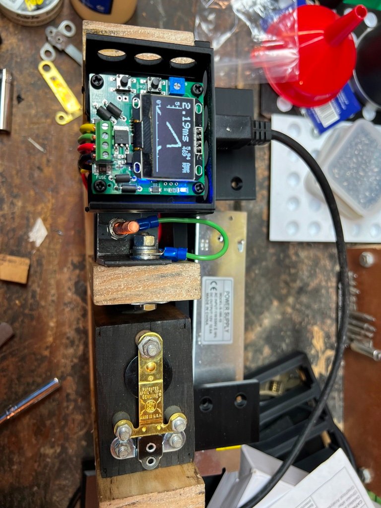

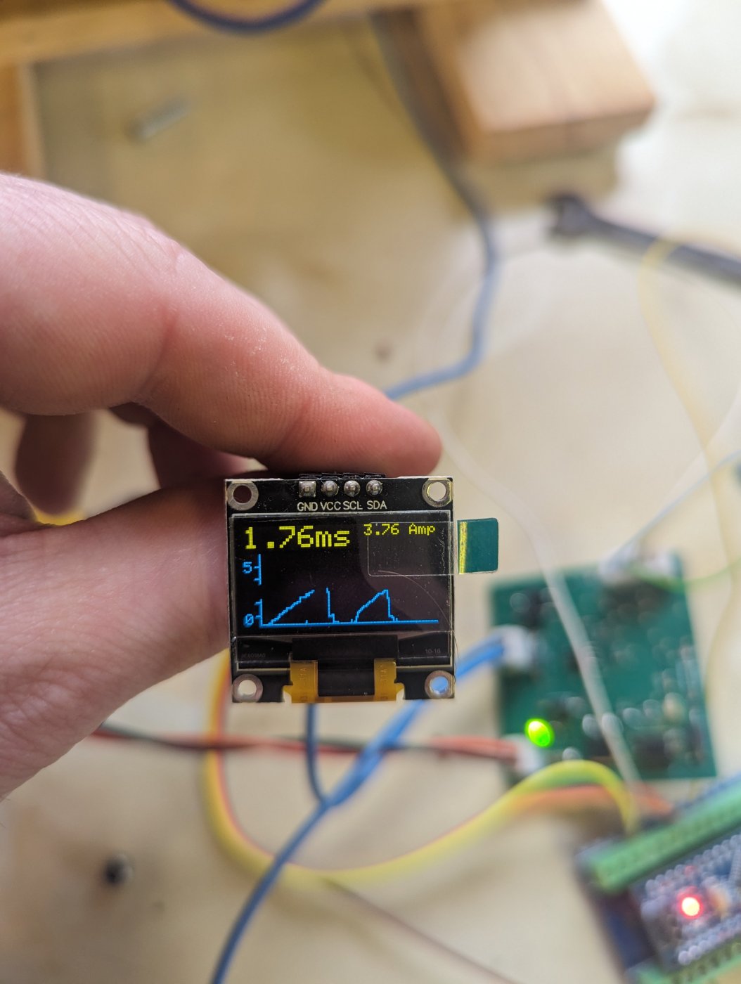

Ignore the low current reading (I have the 30amp sensor and forgot to update the configuration) it actually is around 5.5amp peak.
But is this an example of a double spark situation?

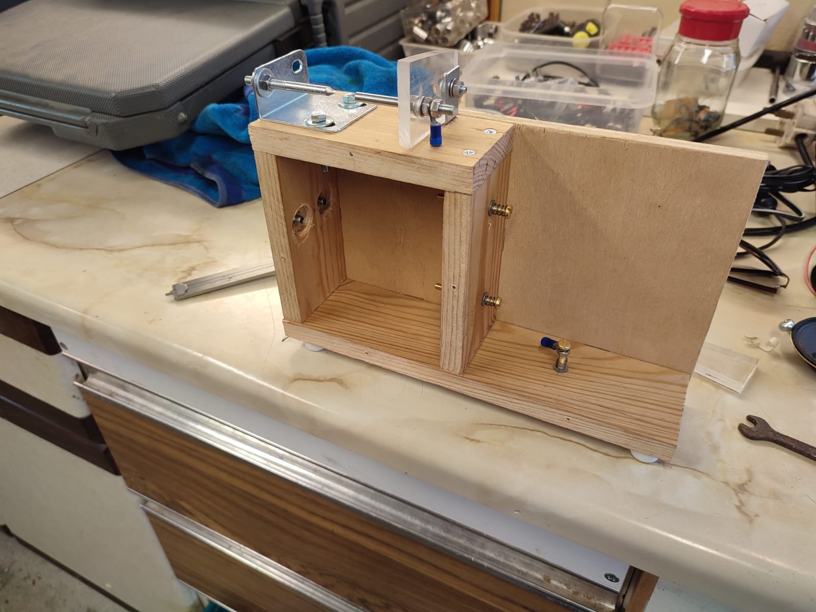

Seems no-one else is going to respond ... if you have a look at page 2 of this thread you'll see various images showing different coil responses as they appear on a 'scope and/or OLED display. Hopefully you'll find something useful there wrt to what you're seeing?
Will be interested to see your integrated design. Some time ago I briefly stuck something together using a Nextion screen which allowed interaction and control of operating parameters, along with a much better voltage/current sensor, so there are certainly further improvements that can be made.
Luke.
Luke.

Thanks for the reply, my plan is to get a full set of coils tuned in at 2ms TTF on the known working device.
Then I'm going to move to a STM32 MCU (48Mhz) with USB support. It should give the following advantage.
- Faster ADC reads at around 10-15 micro seconds (currently the audrino implementations takes around 25 microseconds) should give better sampling resolution.
- Better time tracking +/- 1 microsecond using a 1Mhz internal timer.
However I think the current Arduino implementation has already shown why the car I have access to ran poorly.
All 4 coils had a double spark and non where the same TTF, fastest was 1.8ms, slowest was 2.4ms

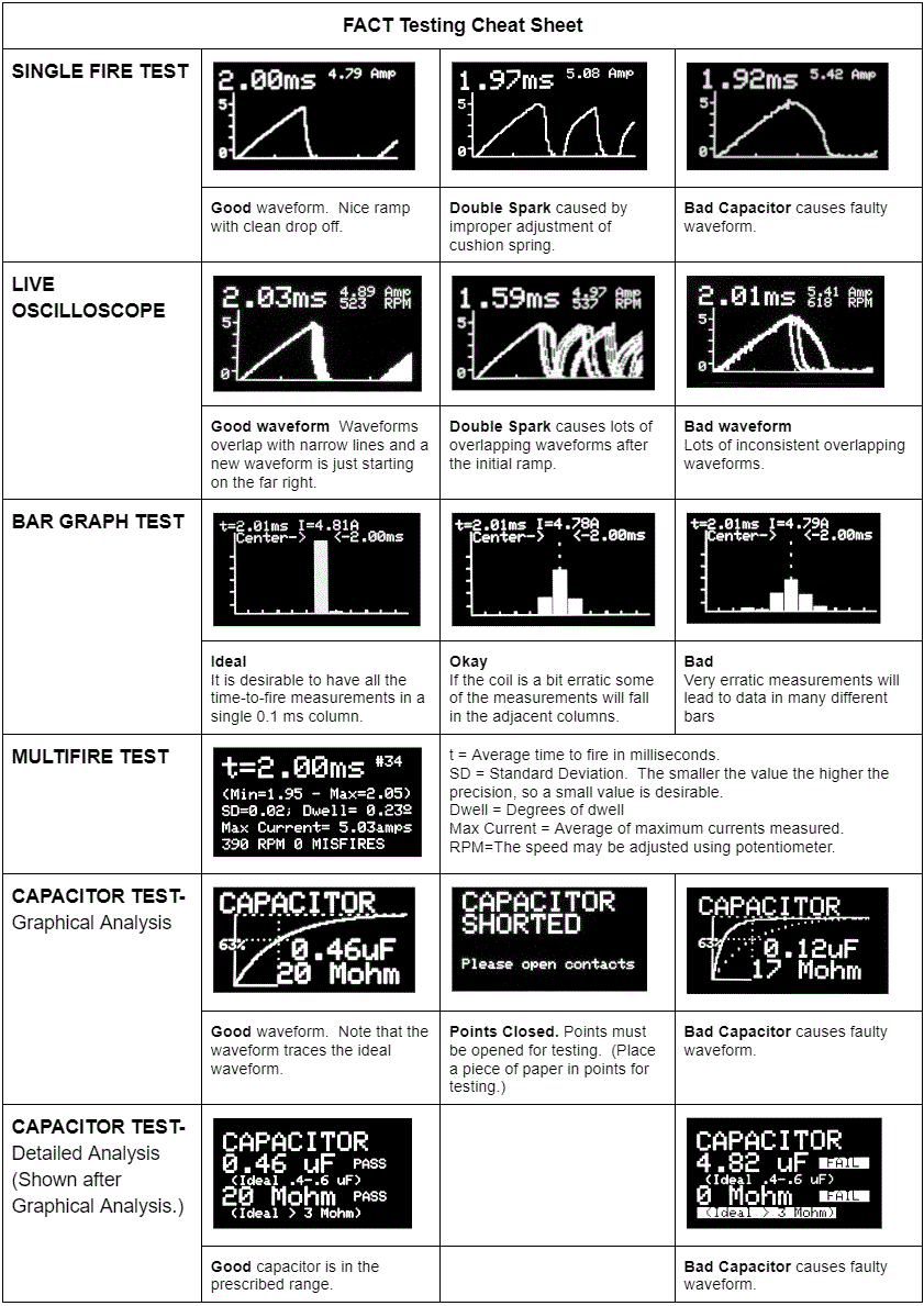

I didn't double check, but I thought I had posted the manual here. Here is the FACT Cheat Sheet: For myself I really find the Oscilloscope function, either single fire or continuous, to be the most useful. I hope this is helpful.BuzzBumbleBee wrote: ↑Wed May 15, 2024 12:11 pmBut is this an example of a double spark situation?
Here is a pdf of the manual.
I have not invested much time on the forum lately. If you have questions feel free to send me a message using email. Perhaps we could have a phone conversation, just include your phone number and when to call/time zone.

Thanks for the info Matt, I was able to get all 4 coils running very well - all 2.0ms (+/- 0.05ms)
I have ordered a 2nd revision of my coil driver board and a small STM32 based breakout board (see below)
These should be with me in the next few days, hopefully I'll have a working STM32 version of the firmware in a week or two.

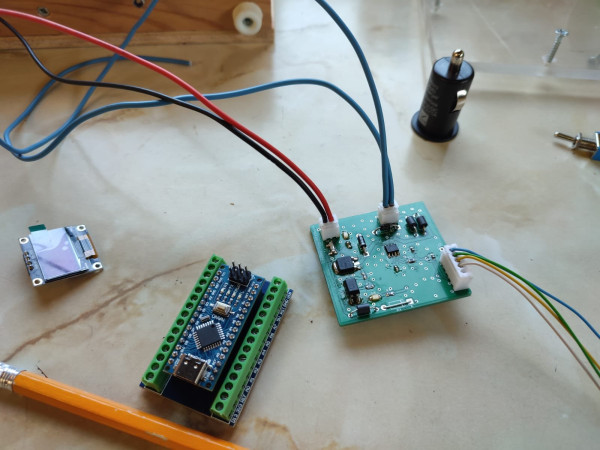

Here is the schematic for my PCB, it should be compatible with both 3.3 and 5v logic (with the placement of 1 extra LED)
I have also included the kicad files if anyone wants to make there own or modify what i have made

I just wanted to mention that the tester works great! I put it together as a small winter project and used it to adjust my coils. Big thanks to all of you, it's a fantastic project!

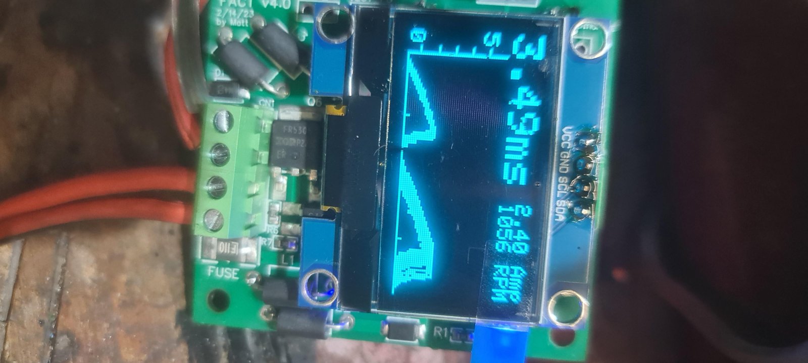

I ordered the PCBs from pcbway and the components from LCSC. Since my job has to do with electronics, I soldered the PCB myself. I highly recommend ordering the PCBs pre-assembled for anyone else. Without soldering experience and a hot air soldering station, it’s quite difficult.
As for the programming, Arduino is not new to me, so it wasn’t a problem.
I just unfortunately didn’t notice that many displays have VCC and GND swapped; one display had to suffer because of that
I replaced the capacitors and the points of my coils and then set them to 2ms. Only one coil had double sparking; the others were very easy to adjust, just time-consuming.
I also designed and 3D printed an enclosure for the tester:
https://www.printables.com/model/123849 ... oil-tester
Moritz
