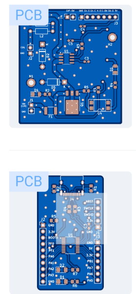

Yes, seems as though the new version of the PCB and BOM is different to the original and they had all the parts. The total was $81 then $40 shipping for 5 units fully loaded.

Great to hear things are moving along with purchasing the boards! It is good to hear all parts are available. In the earlier version of the board parts that were selected were discontinued. Now out of the tens of thousands of choices the best ones are hopefully chosen.
Regarding the software the following is correct for: the newest version of the board, with the SH1106 OLED and the Nano Every. (I use the Nano Every because it has a higher performance and is cheaper, but a standard Nano should be just fine. I have used generic Nanos with success, but some issues, so I don't recommend it.) This is the hardware that I recommend using. But I hope that you could see where to make the changes near the top of the code after the comments:
//****ATTENTION!!!**** CHANGE HARDWARE VERSION TO YOUR CONFIGURATION!!! ****ATTENTION!!!****
#define Hardware_Version 4 // 1= v1.0x; 2=v2.0x; 3=v3.0x; 4=v4.0x *This changes pin out
#define Display 2 // 1 = SSD1306; 2 = SH1106; 3 = ST7789
#define Bar_Graph_Adjustment 2 // 1 = RPM adjustable; 2 = Center of bars adjustable with potentiometer
#define Micro_Processor 2 // 1 = ATmega328; 2 = ATMega4809(Nano Every); 3 = SAMD21 (Nano 33) //#3 untested
Please let me know if you have any questions.

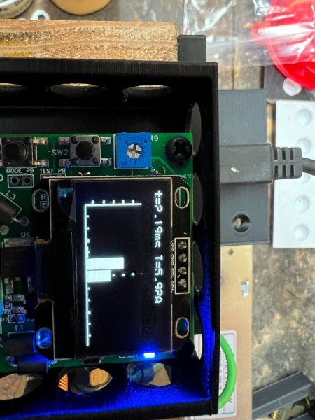

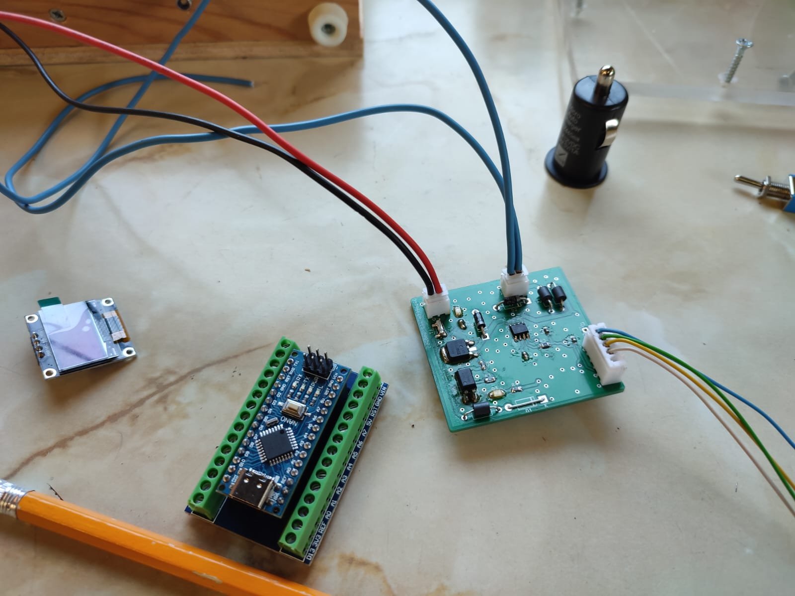

Not sure what's going on. The coils were buzzing in the car but I can't get them to buzz with the tester. I replaced the capacitor in one of them so it's showing a pass but I cannot get any of them to spark. Any ideas? What tests can I do? I have tried with a 12v battery and the 6v (9.4v) T battery.
Luke
Posts: 617
Joined: Fri Dec 13, 2019 1:04 am
First Name: Luke
Last Name: P
* REQUIRED* Type and Year of Model Ts owned: 1926
Location: New Zealand
Re: A new DIY electronic coil tester.
Post by Luke » Tue Oct 03, 2023 9:33 pm
Shawn,
I've never used one of Matt's boards so hopefully he'll turn up shortly to give some advice, however if you're able to read capacitance it suggests that at least part of the coil-tester connection is likely to be ok.
While we're waiting for Matt; it may be that the tester isn't switching properly (for example the FET could be faulty), if it were me I'd check that out with a 'scope, or possibly a suitable multimeter. Do you have either of these things?
Luke.
Matt in California
Posts: 784
Joined: Sun Jan 06, 2019 5:42 pm
First Name: Matt
Last Name: G
* REQUIRED* Type and Year of Model Ts owned: 1926 Touring, 1926 Fordor Project, TT C-cab flatbed farm field find, TT dump truck project
Location: California
Post by Matt in California » Wed Oct 04, 2023 1:29 am
Myxr6turbo wrote:
Mon Oct 02, 2023 10:18 pm
Shawn,
The joy of troubleshooting at a distance! From what you say, I assume the controller powers up and you see info on the display.
Spark LED
There are three LEDs: +5VDC, +12VDC and a Spark LED. The Spark LED should blink every time the Arduino sends out the pulse, so you should see it blink every time spark should be released. If there is a blinking spark LED then the issue is in the power circuit. Perhaps the Power is too low.
Power Supply
You should have 12 VDC input. If it is under 8 VDC the MOSFET will not work. What type of battery are you using?
After I hear, back on this we can discuss what next.
Matt
Myxr6turbo
Posts: 89
Joined: Sat Jul 17, 2021 2:40 am
First Name: Shawn
Last Name: Barnard
* REQUIRED* Type and Year of Model Ts owned: 1926 coupe
Location: Australia, Victoria
Post by Myxr6turbo » Wed Oct 04, 2023 11:57 pm
Thanks Matt for the reply. No the spark LED isn't flashing. The other 2 LED's are on. I used my 12v 700A car battery. I have 5 FACT boards so I ordered a new Arduino and screen but same problem. I'm looking to buy a 240VAC to 12VDC power supply. How many Amps does the FACT need to operate?
Thanks again,
Matt in California
Posts: 784
First Name: Matt
Last Name: G
Post by Matt in California » Thu Oct 05, 2023 2:30 am
Thanks again,
Shawn,
The unit doesn't use much current. I have found small 12 VDC 7Ah lead cell batteries are more than enough. I have also used various AC/DC adapters...
The two power LED show that you have voltage at 12/5VDC. You should see the third LED partially hidden under the display when you press SW2.
It looks like we have need to focus on the digital side of the circuit. From your earlier post I assumed that you were able to test capacitance, thus the Arduino/display are working, but your last post states otherwise.
When you load the program on the Arduino, do you get error messages?
What version of Nano are you using?
When I hear more, I hope to narrow down the issue.
Matt
Myxr6turbo
Posts: 89
First Name: Shawn
Last Name: Barnard
Post by Myxr6turbo » Thu Oct 05, 2023 4:54 am
Great news. I have it working. If I plug in a 5v charger to the arduino and 12v into the FACT it works! Thanks again Matt for helping out. Now I need to read up how to fix the double spark and I'll have 1 good coil :D

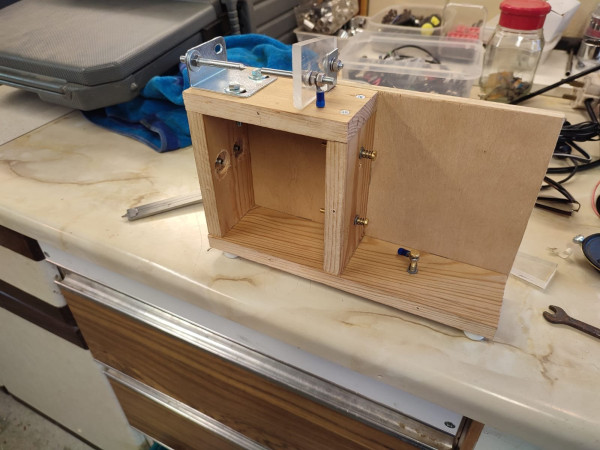

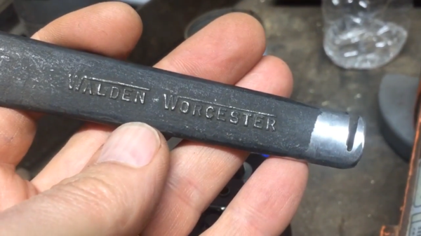

Lovely! I have a video of the tool I use to adjust the coils:
https://youtu.be/CWCJyA8rR4A?feature=shared
This tool works for both the upper and lower bridge.
I have made some updates since the video on this tool for the upper bridge adjustment, but it seems to be MIA at the moment.

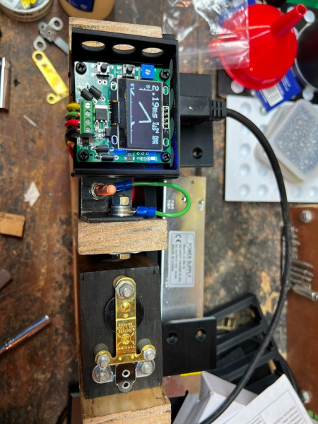

Here is a quick video showing how to use the tester:
https://youtu.be/LrtVXkEvRSw?feature=shared
I have used the unit that way, but it is designed to work off 12VDC. The good thing is that you can test coils with 6VDC in this configuration to get them ready for hand crank starts.
That said, I believe you may have an issue with either the +5VDC going into your Arduino or a issue with the regulator on the Arduino.
What version of Arduino did you have? I have used a generic units the original Arduino Nano and the Arduino Every. What recently I have focused on the Arduino Every.

Currently starting a build of a FACT coil tester, my aim is to make 2 new versions.
1) generic board with the MOSFET driver + current sensing + capacitor sensing components that can be connected to any 5V MCU (picture below)
2) an "all in one" PCB that has an STM32 TSOP20 package that should have an even lower BOM total than using a nano (and should have better ADC resolution and sampling rates)
Very early draft of the generic board

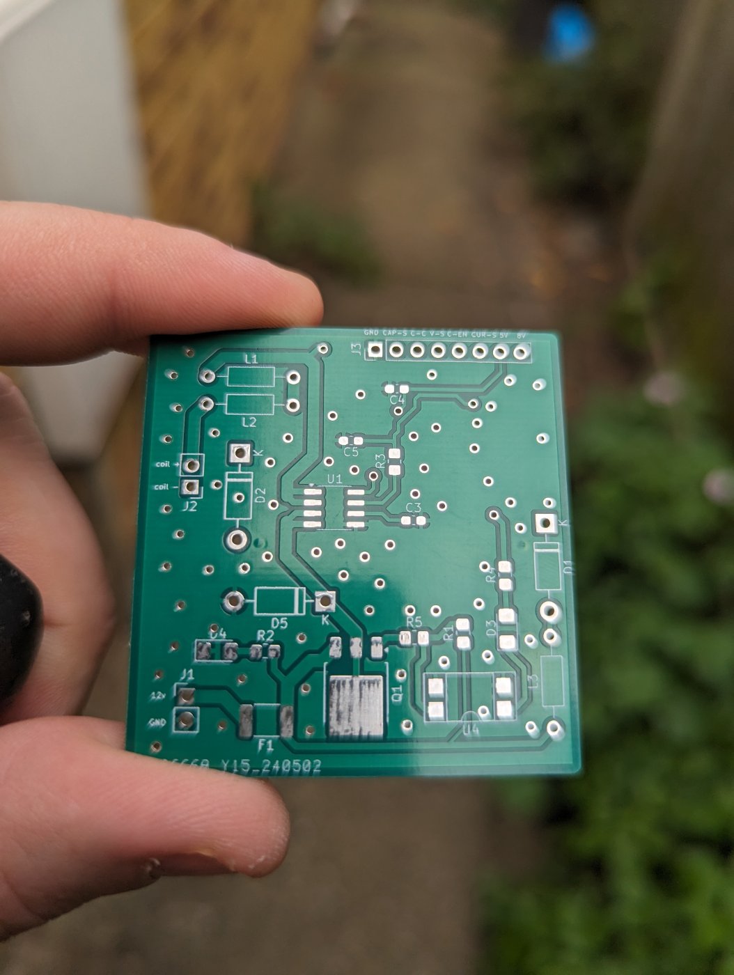

PCB all made up, all waiting to assemble it inside the casing

Post by BuzzBumbleBee » Wed May 15, 2024 12:11 pm

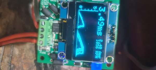

Ignore the low current reading (I have the 30amp sensor and forgot to update the configuration) it actually is around 5.5amp peak.
But is this an example of a double spark situation?

Seems no-one else is going to respond ... if you have a look at page 2 of this thread you'll see various images showing different coil responses as they appear on a 'scope and/or OLED display. Hopefully you'll find something useful there wrt to what you're seeing?
Will be interested to see your integrated design. Some time ago I briefly stuck something together using a Nextion screen which allowed interaction and control of operating parameters, along with a much better voltage/current sensor, so there are certainly further improvements that can be made.
Luke.

However I think the current Arduino implementation has already shown why the car I have access to ran poorly.
All 4 coils had a double spark and non where the same TTF, fastest was 1.8ms, slowest was 2.4ms

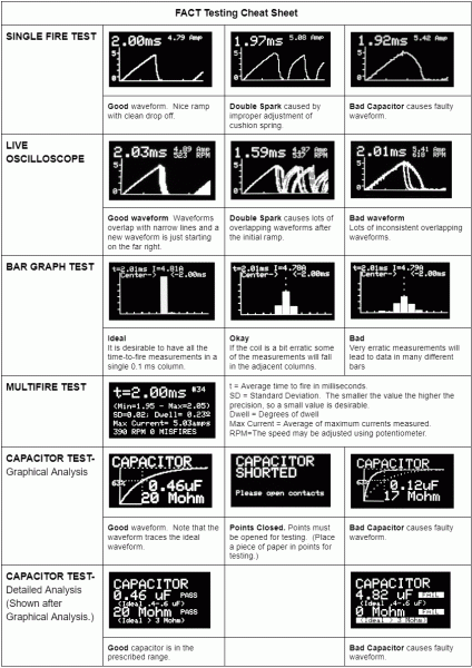

I didn't double check, but I thought I had posted the manual here. Here is the FACT Cheat Sheet:
For myself I really find the Oscilloscope function, either single fire or continuous, to be the most useful. I hope this is helpful.
Here is a pdf of the manual.
Model T FACT Adjustment.pdf
(3.45 MiB) Downloaded 141 times

Here is the schematic for my PCB, it should be compatible with both 3.3 and 5v logic (with the placement of 1 extra LED)
I have also included the kicad files if anyone wants to make there own or modify what i have made
coil_tester.zip
(205.57 KiB) Downloaded 105 times
