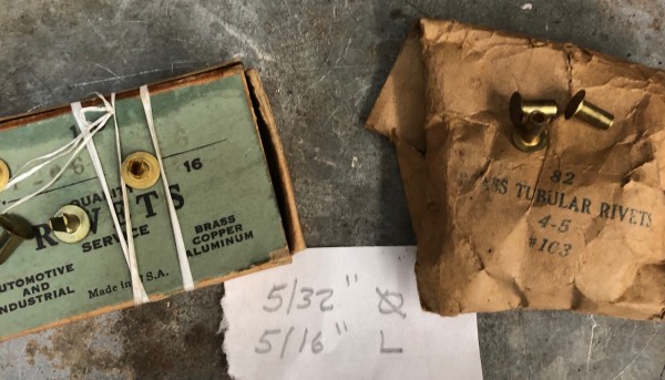

Have used the vendors emergency brake shoe linings. These are brass wire filled stiff material, comes cut to length and right width.
Used brass tubular rivets , countersink the head 1/2 way into the lining, crimp on backside of metal shoe.
Transmission linings are woven, no wires, and less stiff. Use split rivets in those, brass only, not steel, and fold split into fabric lining.
Tubular and split are approximately same size for each application.

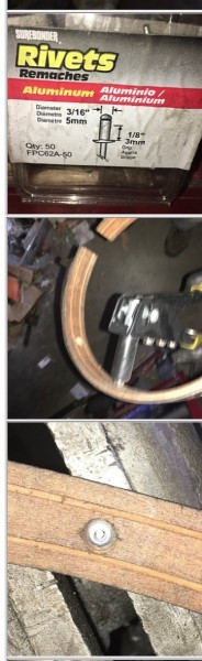

Using stainless pop rivets could be useful, but alum ones are strong too. Have used alum pop rivets on wood linings. As for s.s. on brake shoes, the heads are sunk deep, only huge lining wear would allow the smaller steel head on steel rear brake drum. Original Ford early shoes are cast iron on steel drums ;)
