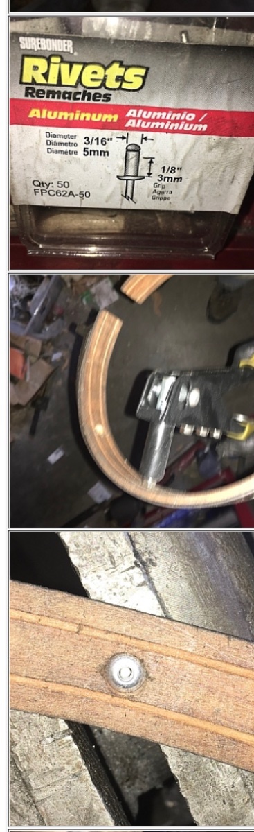

Using stainless pop rivets could be useful, but alum ones are strong too. Have used alum pop rivets on wood linings. As for s.s. on brake shoes, the heads are sunk deep, only huge lining wear would allow the smaller steel head on steel rear brake drum. Original Ford early shoes are cast iron on steel drums ;)
Alum Pop rivets, photo courtesy of Terry Horlick
