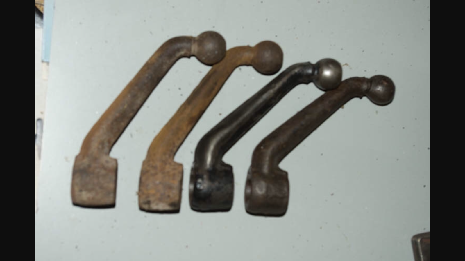

While I agree all steering arms appear to have a taper, they are not all the same. I believe the very early Ts with a short steering column use a different angle than later models. I suspect the 1912 torpedo used yet a different design and I suppose the Improved cars yet another.
Four different steering arms.
I didn’t take this picture but two years ago I was very interested in such items and saved a picture from an earlier thread.
