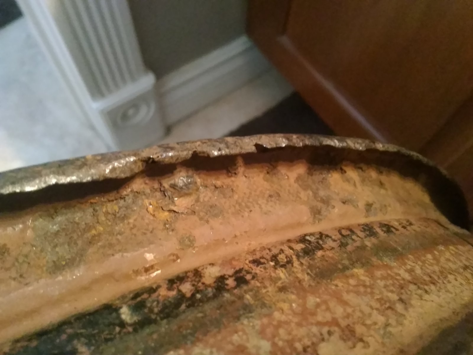

hello everyone, i am changing tires on my T and the rims are really sharp and jagged in some places, and i am going on a trip this weekend in it, so i need to get it fixed asap. should i just grind it down? this picture is the worst spot on the worst rim, and the rest of it is not that bad. maybe a temporary fix would be nice? just to get me through the trip?

You need to replace the rim. If you leave it alone, it will cut into the tire, and if you grind it you risk having the tire fall off while driving. It is unsafe. You need to find a swap meet where they have Model T parts and look for a better one. New ones are available, but are very high priced.

I agree that the pictured rim is toast. Too dangerous to use. Maybe somebody in your local club has a rim (or rims) they can lend you for the weekend. Then you can take some time to find good replacements. New rims cost $255 each, but you can often find good originals at swap meets for about $60 or less. If you happen to hit the right auction you sometimes can get them for under $20.

could i possibly use J B weld to fix it temporarily?

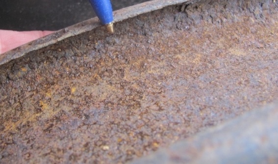

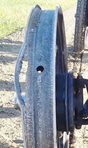

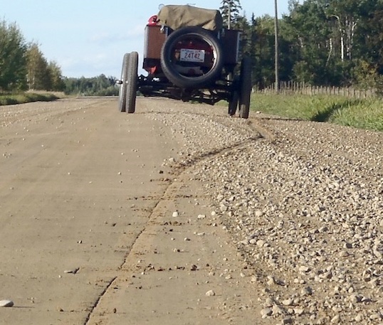

NO. Any temporary fit will last for a short ride down the road and then this will happen.
Un-safe at any speed.

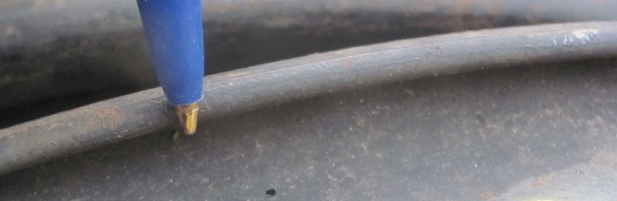

Your clincher rim must be 1/8" thick at the edges (width of a ball point pen nose) and smooth!
Bad rim Bad rim, do not use!

...could i possibly use J B weld to fix it temporarily?
I agree with Dan, but I would put it this way: NO!
This rim is too far gone to be worth fixing. I wouldn't try serious metal work on it, and JB Weld would be useless for this. The only realistic way I see that you'll be able to use the car this weekend would be with borrowed wheels or rims, or if somebody in Clark County has what you need ready to sell right now.

Unfortunately, unless you can borrow some wheels, the car HAS to stay parked. We do not want to see you hurt. Every one of us had had that day when our car was out of commission and we could not drive it. It is just part of life.

Do not drive on that rim. Some of the most knowledgeable people on this forum have told you it's a bad idea and given you some alternatives. If you can't make one work....park it until you get a good rim. Tire / rim failure on a Model T can lead to a lot more trouble than the inconvenience of sitting on the side of the road.

These guys are right but so far I have not seen anyone tell you just how dangerous this rim is. Don't even think about putting air in it or it will destroy the tire and tube but even worse it is very possible it will blow off the side of the rim and could hit you while you are putting the air in it. If it did hold air it wont make it more than a few blocks at best. Be safe out there, don't chance it with this one.
