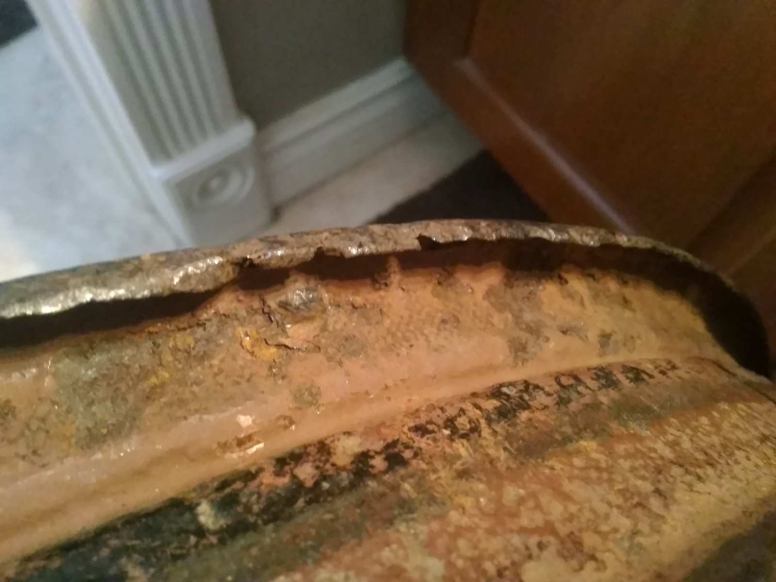

hello everyone, i am changing tires on my T and the rims are really sharp and jagged in some places, and i am going on a trip this weekend in it, so i need to get it fixed asap. should i just grind it down? this picture is the worst spot on the worst rim, and the rest of it is not that bad. maybe a temporary fix would be nice? just to get me through the trip?
Re: model t tire rims
Post by Norman Kling » Wed Mar 11, 2020 11:04 am
You need to replace the rim. If you leave it alone, it will cut into the tire, and if you grind it you risk having the tire fall off while driving. It is unsafe. You need to find a swap meet where they have Model T parts and look for a better one. New ones are available, but are very high priced.

I agree that the pictured rim is toast. Too dangerous to use. Maybe somebody in your local club has a rim (or rims) they can lend you for the weekend. Then you can take some time to find good replacements. New rims cost $255 each, but you can often find good originals at swap meets for about $60 or less. If you happen to hit the right auction you sometimes can get them for under $20.

could i possibly use J B weld to fix it temporarily?

Post by DanTreace » Wed Mar 11, 2020 2:56 pm

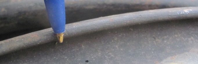

NO. Any temporary fit will last for a short ride down the road and then this will happen.
Un-safe at any speed.
Your clincher rim must be 1/8" thick at the edges (width of a ball point pen nose) and smooth!
Bad rim Bad rim, do not use!

...could i possibly use J B weld to fix it temporarily?
I agree with Dan, but I would put it this way: NO! :o
This rim is too far gone to be worth fixing. I wouldn't try serious metal work on it, and JB Weld would be useless for this. The only realistic way I see that you'll be able to use the car this weekend would be with borrowed wheels or rims, or if somebody in Clark County has what you need ready to sell right now.
