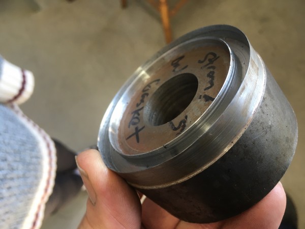

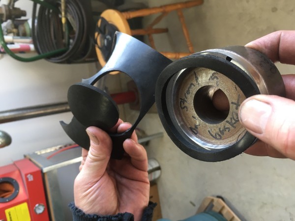

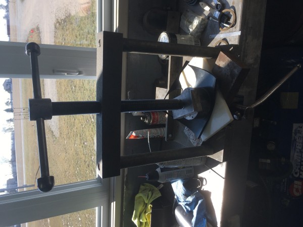

Running glass bowl stromberg carb and always had a problem with the cork gasket shrinking. Bought BUNA rubber nitrile gasket material and have been busy making a die and then gaskets. Will see how they hold up

Nice job on the die. (For those that don't know, same with using a hole punch) When using it put a sheet of something like the plastic cutting board material under the material you are cutting, which is what you have done.
A piece hard wood would work too. You could also use the cork/BUNA nitrile gasket material, it is pretty shrink proof and holds up to modern gas.
