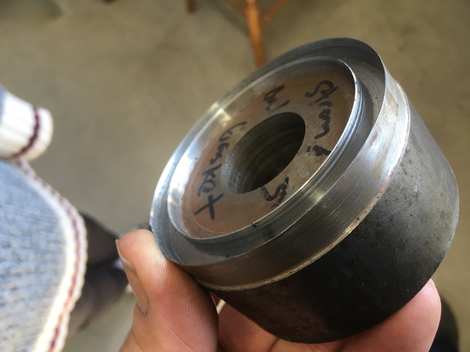

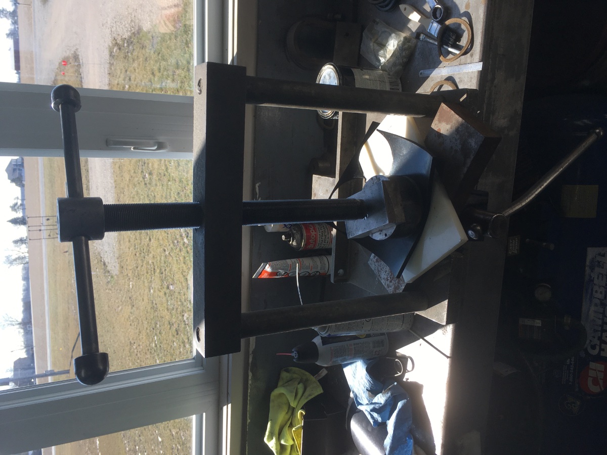

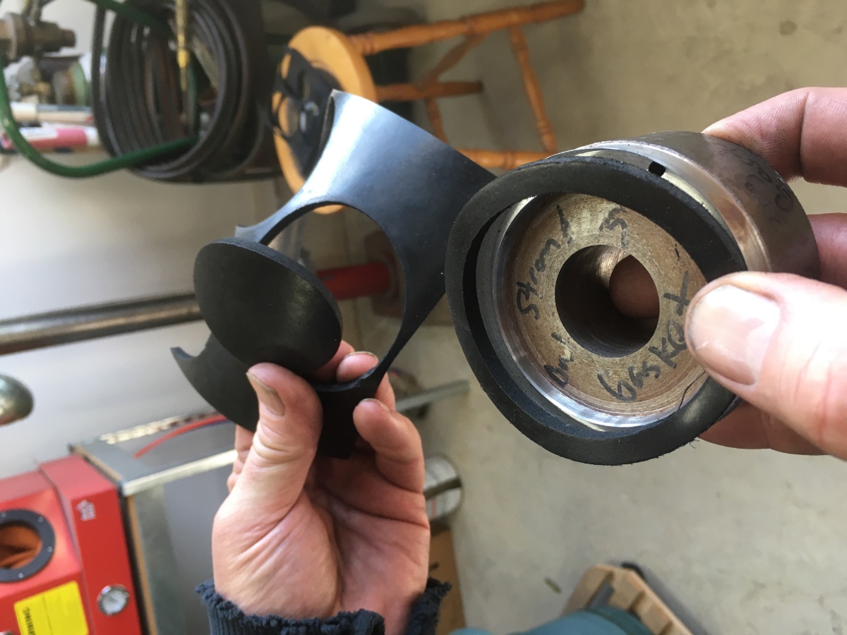

Running glass bowl stromberg carb and always had a problem with the cork gasket shrinking. Bought BUNA rubber nitrile gasket material and have been busy making a die and then gaskets. Will see how they hold up

Nice job on the die. (For those that don't know, same with using a hole punch) When using it put a sheet of something like the plastic cutting board material under the material you are cutting, which is what you have done.
A piece hard wood would work too. You could also use the cork/BUNA nitrile gasket material, it is pretty shrink proof and holds up to modern gas.

Jim buna nitrile is according to the manufacture impervious to fuel/greases and ethanol. So fingers crossed,have the gaskets installed,fuel in the carb and am waiting to see what happens.
Mark did not know about the cork/buna,went to the parts store but they knew of nothing go figure.
Back in the early 70's every spring with the hot rods etc running Holley,s you had to regasket because the gaskets would shrink,Holley finally used the material I would suspect you are talking about.Need to find a supplier for sheets of it
Cheers Pete
