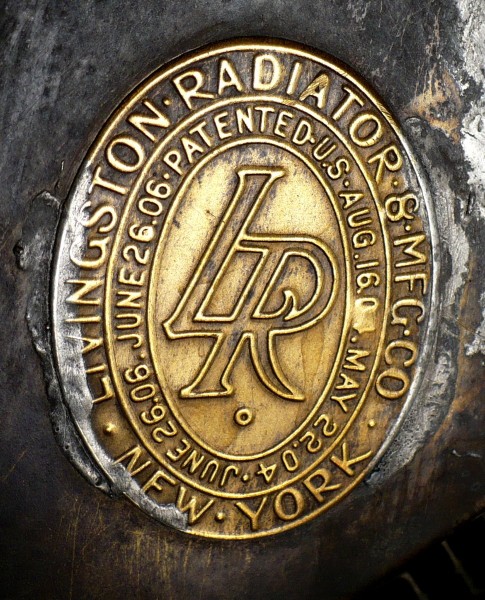

Original Livingston's normally exhibit the tapered front tank and normally an oval emblem on the face of that tank.

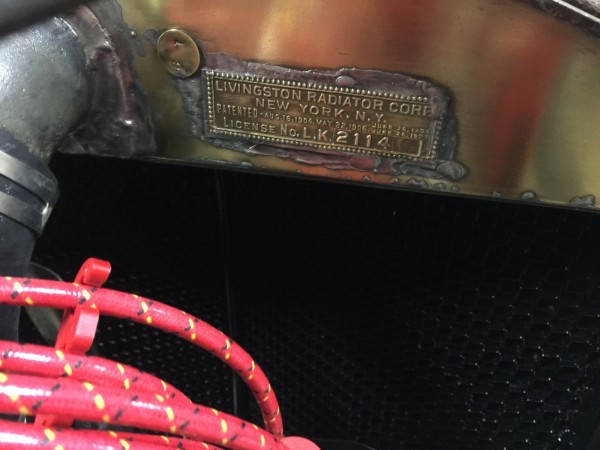

They had a couple of tags on the early ones.

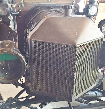

I suggest that your radiator is teens but the shell is modern.
Mine needs a new shell. Oval spot is where the tag was soldered on.
