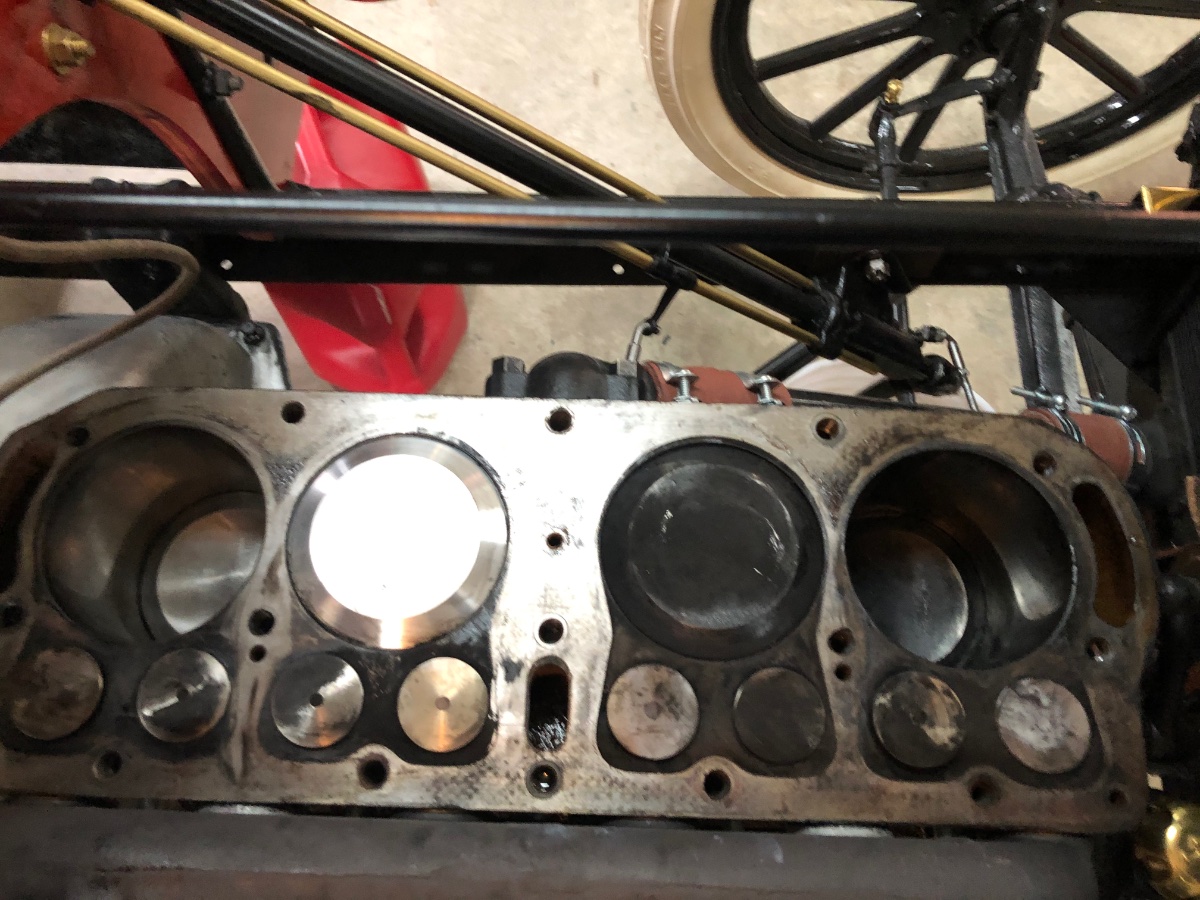

I have had my 11 engine started but it misses on numbers three and four. It came to me newly rebuilt. I had the coils rebuilt and the carb rebuilt. Shorting those cylinders out makes no noticeable in the rpm’s. I have switched coils around no difference. I thought it was an intake leak because spraying brake clean at the intake port slowed or stalled the engine. I have replaced the intake glands and copper rings twice. The glands are not too wide, the manifold is not being held out by the glands,and the manifolds are straight. After replacing the manifold gaskets the last time, same problem I now think I was getting a false reading by spraying thru the plastic nozzle, as it took a steady spray to affect the rpms. Today I took the head off and the numbers one and two pistons are black the problem numbers three and four are shiny and clean. At a loss here, Art

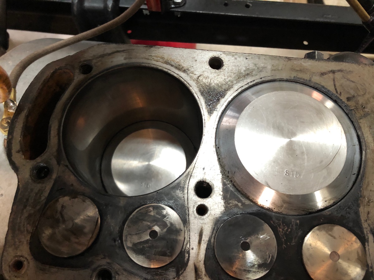

I had suggested a different intake manifold in lieu of the original aluminum dog-leg intake manifold? Did you try that?
And, what were the compression readings prior to taking off the head?
A pair of cylinders side by side, that clean, leads me to a hellacious vacuum leak or a manifold obstructed by a rag.

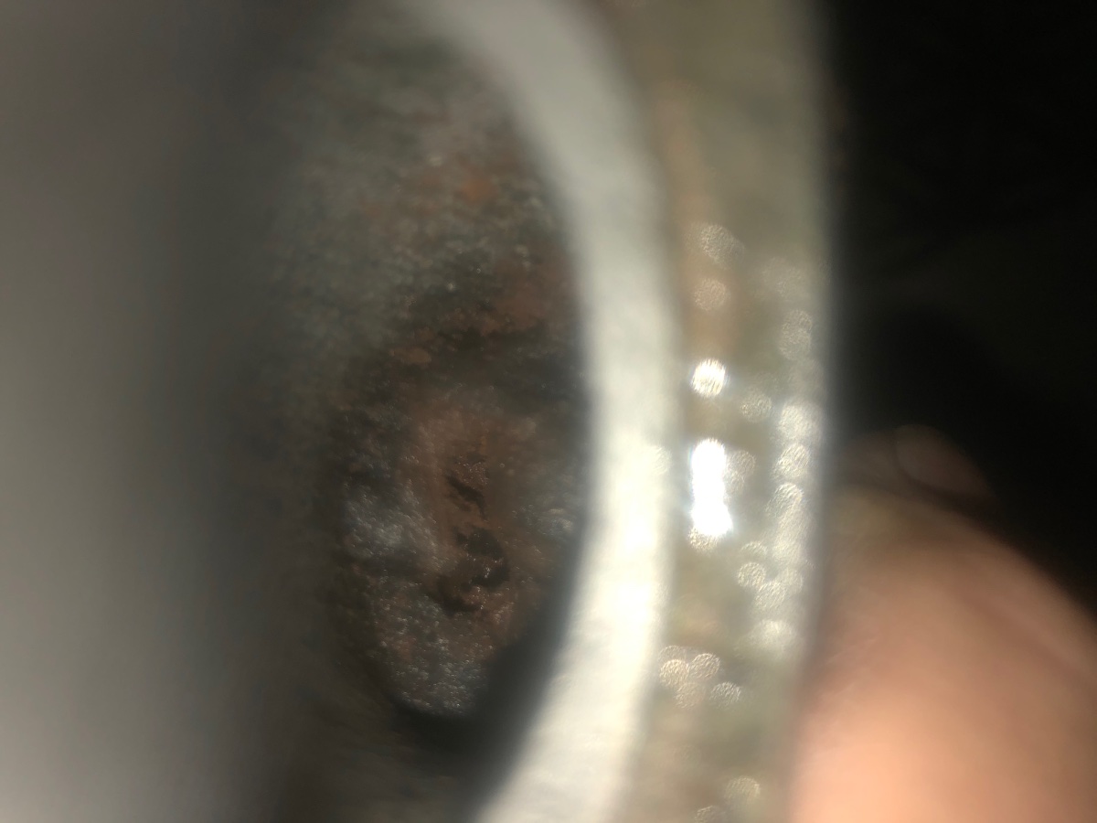

This sounds ridiculous, but if the engine's been sitting awhile you may have a mouse nest in the rear side of the intake manifold. You wouldn't be the first that that's happened to.
I have no experience with the original two piece timer, but I have heard of problems with them. I have also heard that the problems are easily fixed. Someone with experience will have to kick in his two cents.

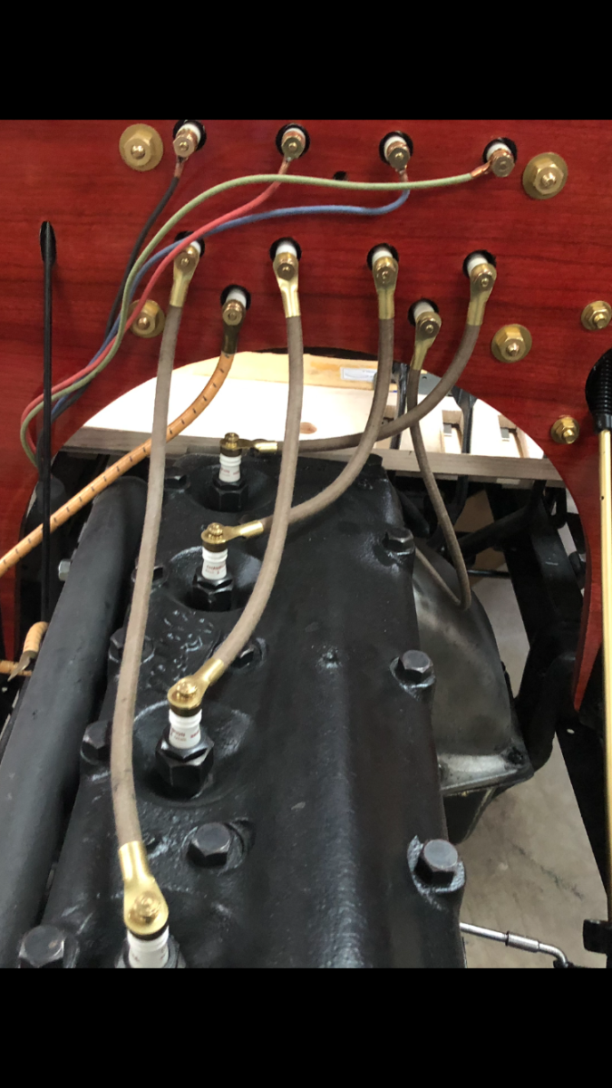

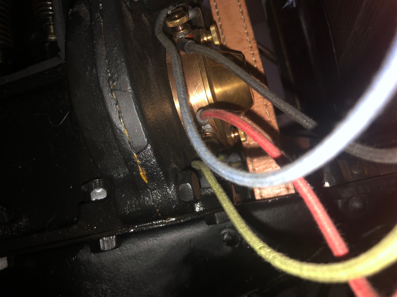

Two thoughts by looking at top photo. Spark plug wires appear to be very close to throttle linkage control rod. Perhaps shorting out? Also, might wait 'till dark and from what you say, engine does run on two cylinders. With engine running in pitch dark tonight, look for errant sparks.

Timer wires running to/from the coil box look close to number one spark. But it may be the picture. I have clips keeping mine well away from except where they need to go.

I am ordering a new head gasket. When the head is back on I will do a compression test and post he results. and when it's running correctly I will post the solution so we can have a winner. Could the cylinders being washed out clean make the rings not want to seat creating low compression. This is a new not broken in rebuild. Grasping at straws, Art

John, I have been told you can't use a different timer on the 1911 unless you change the timing gear cover. Otherwise I would try a new day timer. Art

Are your valves set, in the picture they all look closed. Maybe 3 and 4 weren’t done??

Art, after years of struggling with a two piece timer I gave up, changed the timing cover and switched to a brush style timer. No more problems. Unfortunately, the early timing cover for the two piece timer can't be used and if you want to keep the spring loaded fan set up you will need very early timing cover.

Russ, I am not using the spring loaded fan set up. I believe that was a little earlier than my car. Mine has an adjusting bolt and nut. What timing gear cover should I use to go with a brush style timer? Art

I do not believe for a second that you have a timer problem if you are getting sparks at each cylinder. Do not be kidded into replacing the cover just to put on a cheap timer which will do nothing better than what you have.
Dear God, the things I've heard taken apart because something doesn't run well. Just because it has a nut on it doesn't mean that trouble lies just below it.
Two piece timers are extremely well built and with care outlast their owners.
Look somewhere else.

Scott i do not see why that timer is not doing the job, one would think the roller is bouncing but why not 1 and 2 does not make sense could be a combination of issues I already suggested timer wiring on another forum as have you. Art will persevere and get this.

you misunderstand me. I'm betting the timer is doing just fine. I am trying to keep him from removing the FRONT OF THE ENGINE to swap it for a newer style.

While the head is still off, have a look at the valve seats in #3 & #4 and see if you can determine whether or not the valves are contacting the seats for the full 360 degrees. Though the engine has not run for long, you should still see indications of contact on the seats and on the valves. Also, check the valve lash to be certain you have clearance in the intake & exhaust valves when the valves are down/closed.
All of these potential problems will ultimately be revealed during a compression test, but if you find them now, you'll have saved a new head gasket from being used up needlessly.

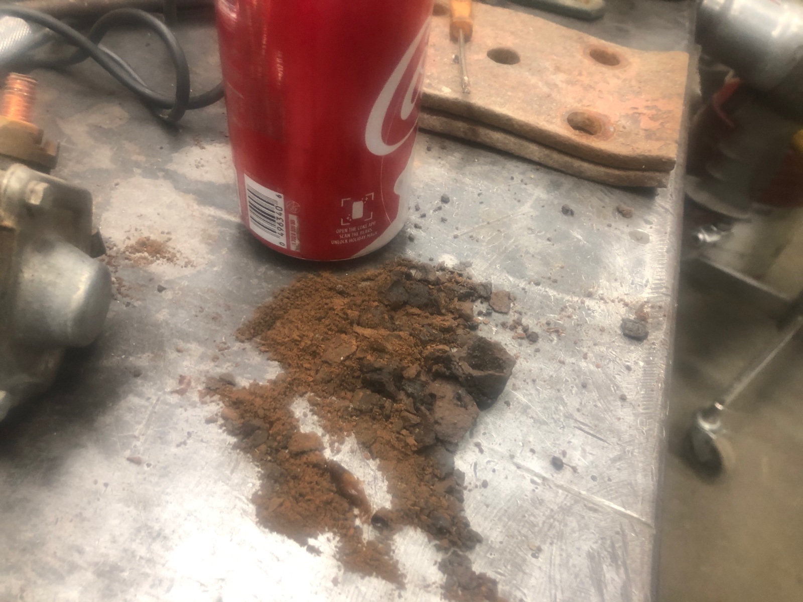

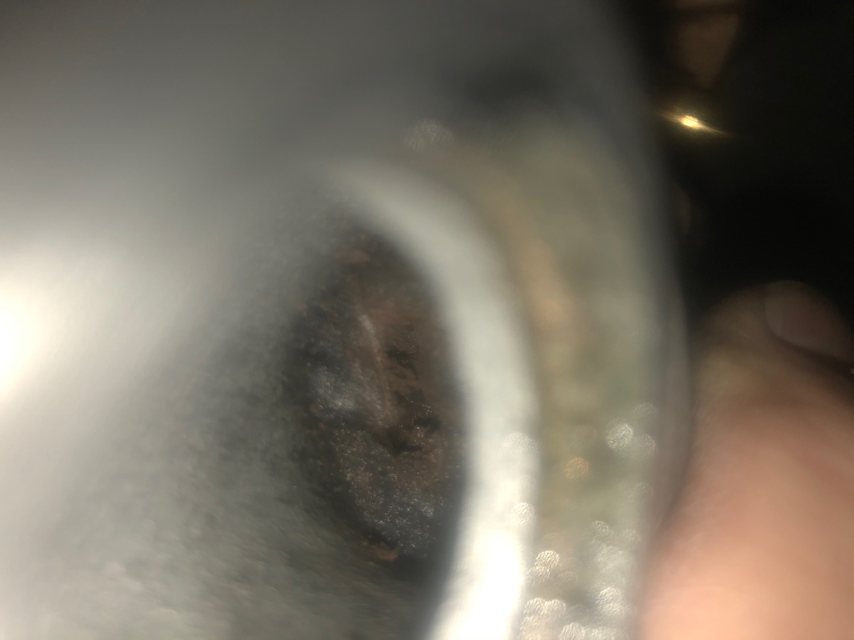

And the winner is! RV, I think you got it! I can not get my pinky down the rear leg of the manifold. Here is a picture of a solid restriction. Next is to break it out to determine what it is.R.V.Anderson wrote: ↑Sun Apr 12, 2020 2:59 pmThis sounds ridiculous, but if the engine's been sitting awhile you may have a mouse nest in the rear side of the intake manifold. You wouldn't be the first that that's happened to.
Art Ebeling
Topic author - Posts: 509
- Joined: Sun Jan 06, 2019 10:43 am
- First Name: Art
- Last Name: Ebeling
- * REQUIRED* Type and Year of Model Ts owned: 1911 touring 14 runabout
- Location: Hillsboro IL
Re: Engine miss
Mud dobber nest, solid restriction, have to break it out. Thanks to all who gave advice. Art

Art glad you found it you definitely want that thing really clean, that is a lot of crud.
- Posts: 4243
Re: Engine miss
I guess it wasn't just the coils buzzing! Wow!

Congratulations Art are RV. I was betting on the valves not closing. That car came from just south of San Francisco. It was stored in a shed and there were parts from that car in other sheds and barns on the property. I know the engine was never run and was probably rebuilt 25-30 years ago. God only knows how where that manifold came from, the previous owner was a very long time collector of T stuff. Glad you got it sorted out.

Three pulls with choke and one with the key on! Here is a link to a video. https://youtu.be/JicWYpdZuL0
