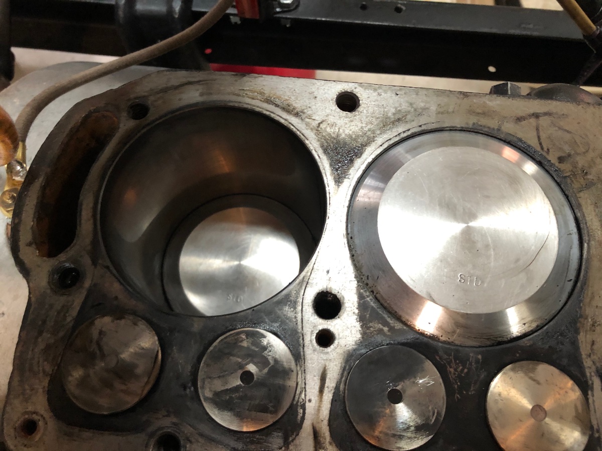

I have had my 11 engine started but it misses on numbers three and four. It came to me newly rebuilt. I had the coils rebuilt and the carb rebuilt. Shorting those cylinders out makes no noticeable in the rpm’s. I have switched coils around no difference. I thought it was an intake leak because spraying brake clean at the intake port slowed or stalled the engine. I have replaced the intake glands and copper rings twice. The glands are not too wide, the manifold is not being held out by the glands,and the manifolds are straight. After replacing the manifold gaskets the last time, same problem I now think I was getting a false reading by spraying thru the plastic nozzle, as it took a steady spray to affect the rpms. Today I took the head off and the numbers one and two pistons are black the problem numbers three and four are shiny and clean. At a loss here, Art

Art, did you not have this same line of questions on another thread?
I had suggested a different intake manifold in lieu of the original aluminum dog-leg intake manifold? Did you try that?
And, what were the compression readings prior to taking off the head?
A pair of cylinders side by side, that clean, leads me to a hellacious vacuum leak or a manifold obstructed by a rag.

The plugs fire in the proper order with them out and laying on the head when I would hand crank it with the key on. After installing the manifolds I gave it four quarter turns while choking it and got a free start when I turned the key on. I thought It was going to be alright but it still had the miss on three and four. It might have even gotten worse after warming up. Art

Two thoughts by looking at top photo. Spark plug wires appear to be very close to throttle linkage control rod. Perhaps shorting out? Also, might wait 'till dark and from what you say, engine does run on two cylinders. With engine running in pitch dark tonight, look for errant sparks.

Are your valves set, in the picture they all look closed. Maybe 3 and 4 weren’t done??

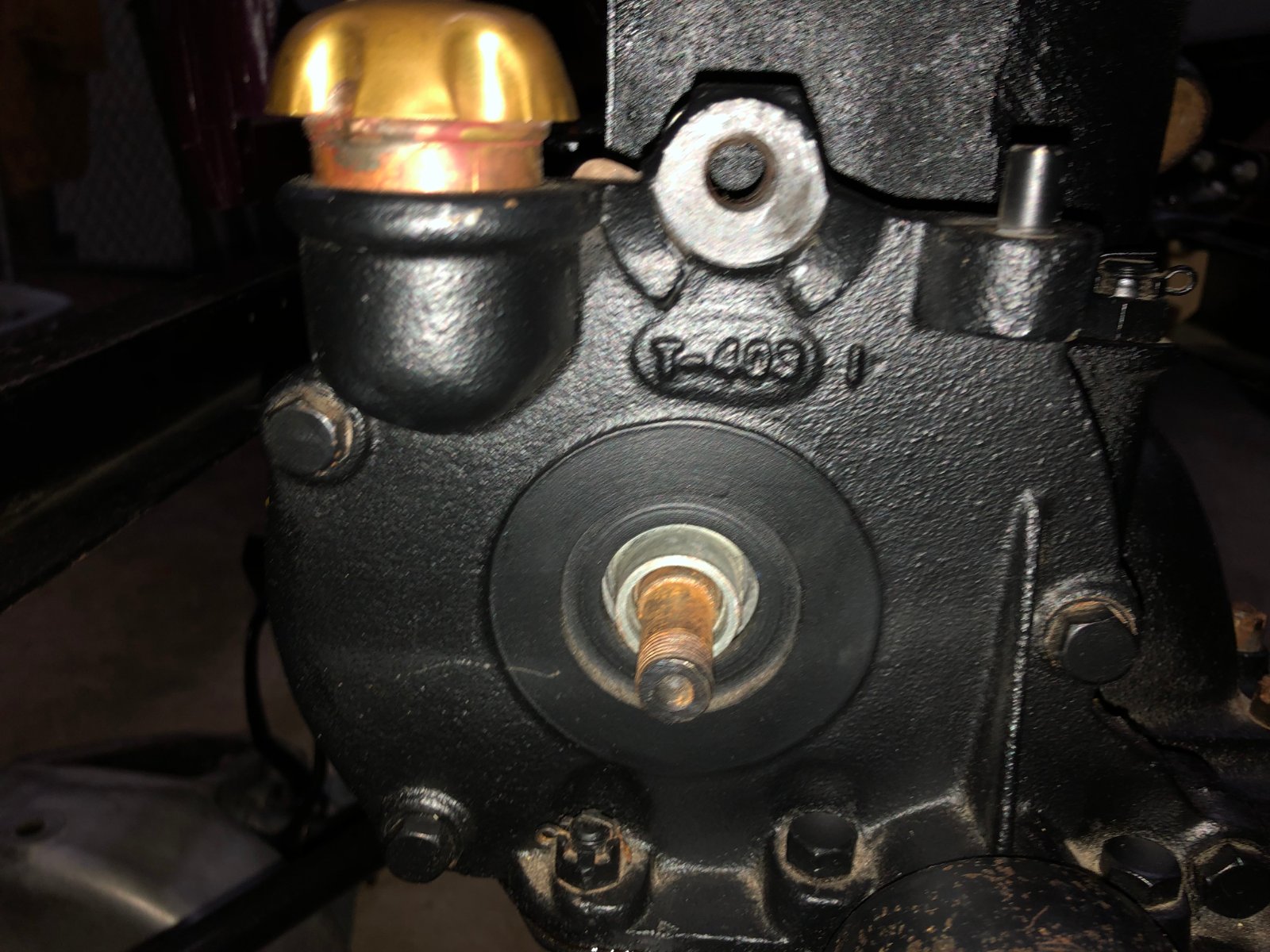

Post by Art Ebeling » Mon Apr 13, 2020 8:55 am
Can a different timer be used withe this timing gear cover? Art

Re: Engine miss
Post by Russ T Fender » Mon Apr 13, 2020 9:50 am
Art, after years of struggling with a two piece timer I gave up, changed the timing cover and switched to a brush style timer. No more problems. Unfortunately, the early timing cover for the two piece timer can't be used and if you want to keep the spring loaded fan set up you will need very early timing cover.

Post by Art Ebeling » Mon Apr 13, 2020 10:26 am
Russ, I am not using the spring loaded fan set up. I believe that was a little earlier than my car. Mine has an adjusting bolt and nut. What timing gear cover should I use to go with a brush style timer? Art

Post by Mark Gregush » Mon Apr 13, 2020 10:43 am
While it would not be correct and the points police might get after you :D , any cover made after the one with oil filler built into the timer up to 1919ish for non generator engine should work.

Post by John kuehn » Mon Apr 13, 2020 11:32 am
Might be a reason Ford changed to the later style timer that was pretty reliable for many years. Won’t be much of a job to get the later Generator cover and timer to see if it works. Easier to do than tearing the engine down. But that’s me. Probably was done way back when since Ford made parts that mostly would interchange. If it doesn’t work then you would know for sure for the next step.

Post by Scott_Conger » Mon Apr 13, 2020 2:05 pm
I do not believe for a second that you have a timer problem if you are getting sparks at each cylinder. Do not be kidded into replacing the cover just to put on a cheap timer which will do nothing better than what you have.
Dear God, the things I've heard taken apart because something doesn't run well. Just because it has a nut on it doesn't mean that trouble lies just below it.
Two piece timers are extremely well built and with care outlast their owners.
Look somewhere else.

While the head is still off, have a look at the valve seats in #3 & #4 and see if you can determine whether or not the valves are contacting the seats for the full 360 degrees. Though the engine has not run for long, you should still see indications of contact on the seats and on the valves. Also, check the valve lash to be certain you have clearance in the intake & exhaust valves when the valves are down/closed.
All of these potential problems will ultimately be revealed during a compression test, but if you find them now, you'll have saved a new head gasket from being used up needlessly.

Hi Agree with Scott, don't removing the front of the engine yet. The issue is more about the valve set #4 & # 3 I thought. Please double check in the side of the intake too.
Art if it is possible making a little video when you hand crank the engine, it will may gave some further indications...

Post by Art Ebeling » Fri Apr 17, 2020 12:09 pm

And the winner is! RV, I think you got it! I can not get my pinky down the rear leg of the manifold. Here is a picture of a solid restriction. Next is to break it out to determine what it is.
