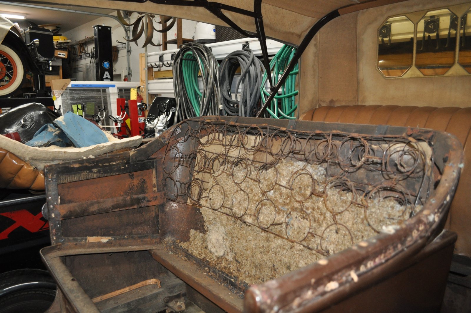

You're right; it will. Just ask my poor '23 roadster. I had only enthusiasm when I restored it 34 years ago; zero knowledge. It has been a very reliable runner but a couple finish-type things still make me wince when I look at it.

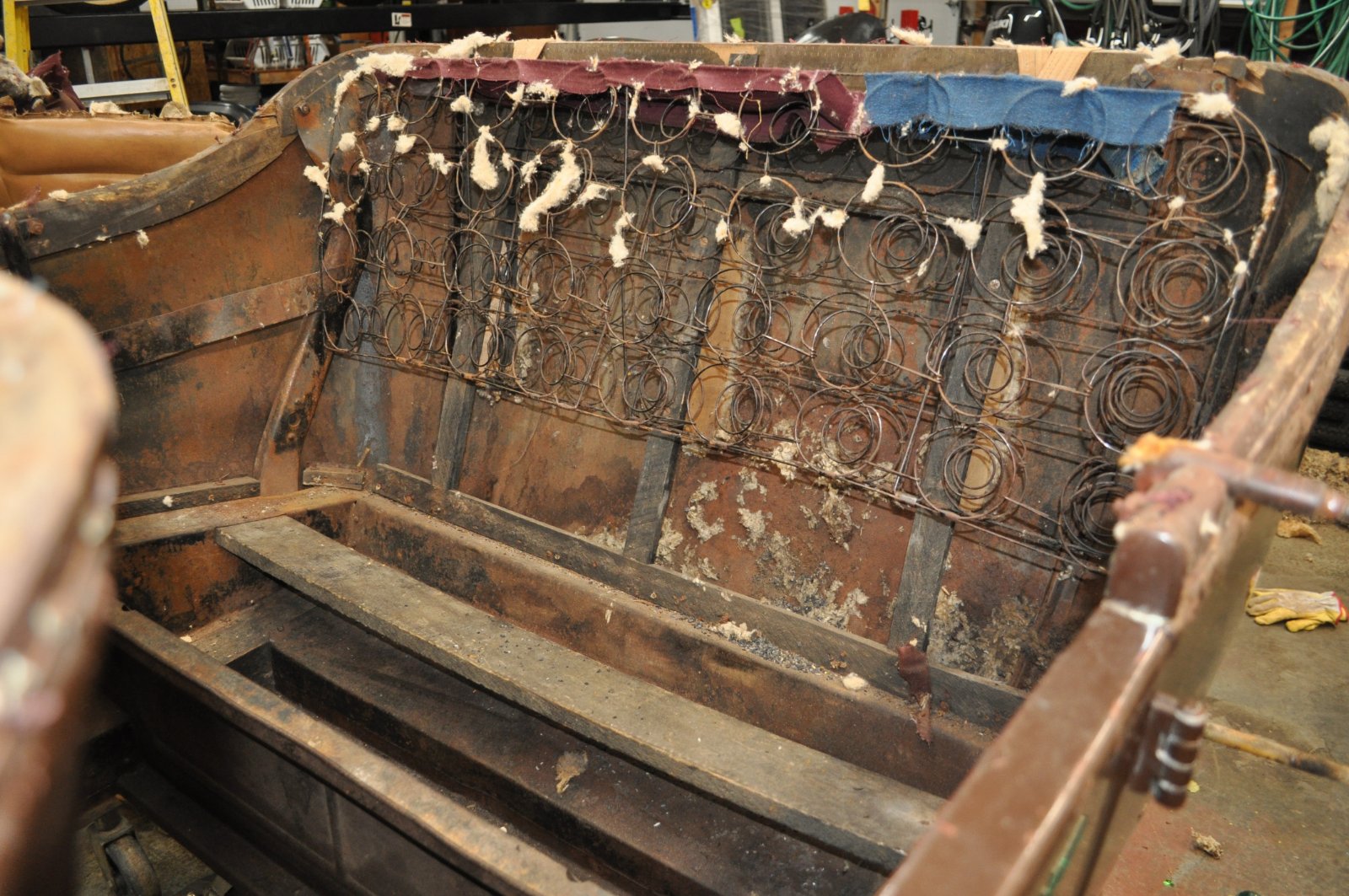

Anyway, FWIW, here is a photo of the untouched rear tub of a 1920 touring. Your '24 may be different.

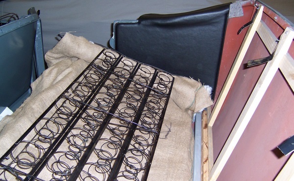

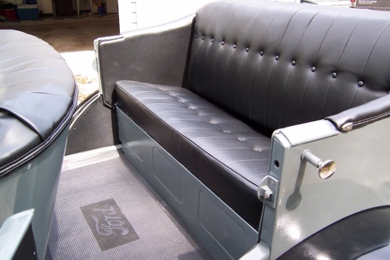

You'll only want to hang that backrest spring when you have your upholstery for it. Plus you should already have fitted the seat bottom upholstery over its spring. That way you have the seat to be sure your backrest upholstery is properly positioned so the seat tucks in nice and firm, and not loose.
The upholstery kit will have stuffing to use to make a nice level between the spring top and the top of the body. And, yes, for the front seat the straps for hanging the front backrest spring hang from the tack rail.
As Dan mentioned, use a nice tough material for hanging the backrest spring, vinyl works, as you will likely tack and re-tack it to position correctly.
This is a '27 touring, but the install methods are similar.

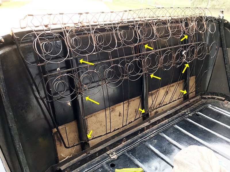

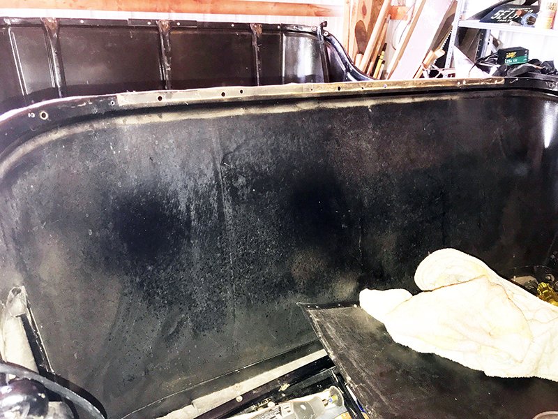

I'm re-doing my upholstery right now. I have a 1917 so I probably won't be of much help. My rear seat has three metal strips with little bent clips (yellow arrows) that the springs drop into. I've added a photo showing the arrangement. The bottom of the springs sits above the area taken up by the bottom cushion.
My front seat is just bare sheetmetal. I assume it originally had springs but there are none now nor is there any evidence of a supporting structure. I have no plans to install springs (maybe a little foam) as their absence gives me a little more room behind the steering wheel.
