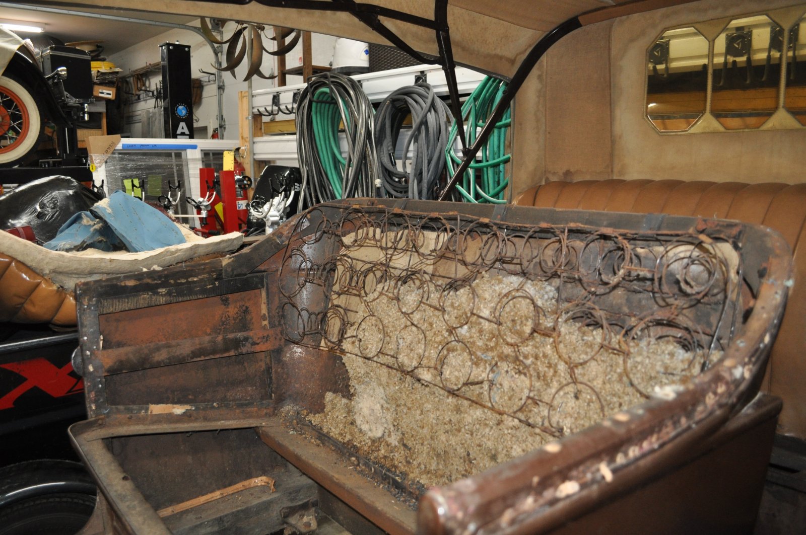

You're right; it will. Just ask my poor '23 roadster. I had only enthusiasm when I restored it 34 years ago; zero knowledge. It has been a very reliable runner but a couple finish-type things still make me wince when I look at it.
Anyway, FWIW, here is a photo of the untouched rear tub of a 1920 touring. Your '24 may be different.
