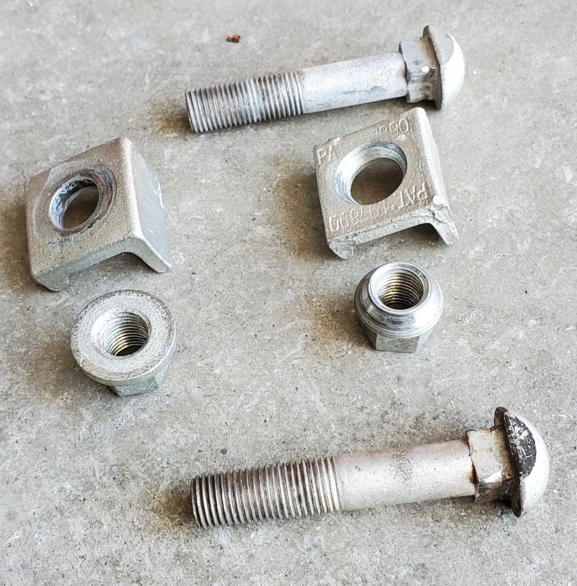

I am learning about these wheels that I have on our 1923 Canadian Coupe
There are 2 different kind of lugs, ones with a flat nut and ones with a conical nut.
One side of the car has the flat ones the other side the conical ones.
Which one is correct or are both correct?

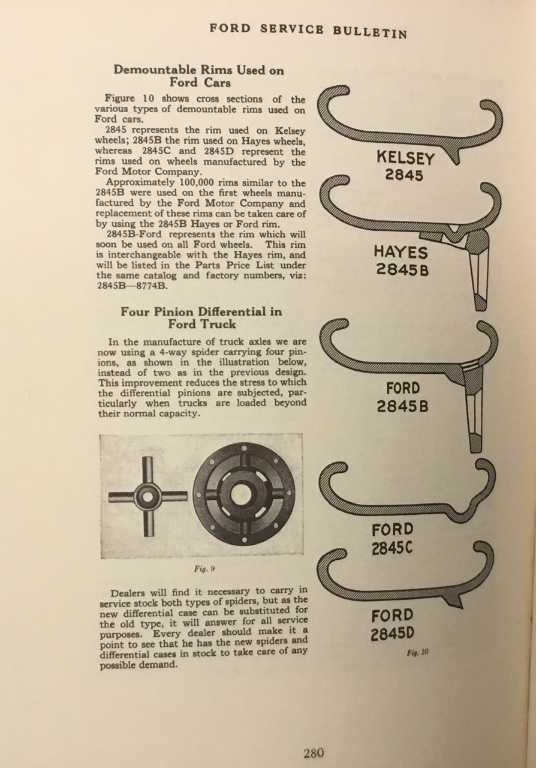

right now mine has a pair of Ford 2845C, and a pair of Ford 2845D rims. the spare rim was a 2845D also, but is bent so badly I took it off the car.
I'd like to have a set of 5 of the Kelsey 2845 rims
what rims are on your car ?

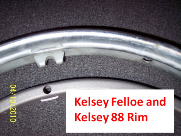

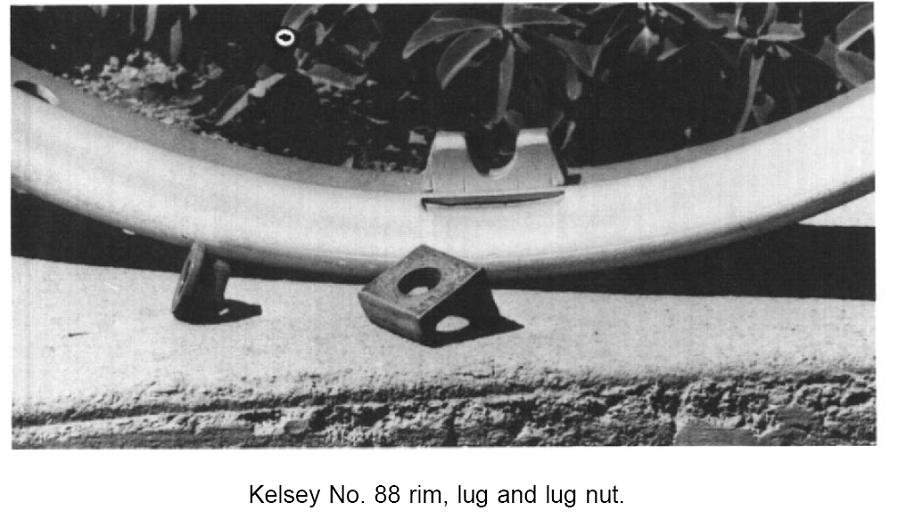

Kelsey wheels use loose lugs with flat back nuts and have felloes and rims like this:

I wonder if a prior owner cut a taper into some of your loose lugs so that they would work with the cone nuts.
If you want to switch to all flat nuts, the vendors sell modern reproductions of the lugs and nuts. Unfortunately the modern lugs will not have the embossing.

Re: Kelsey loose-lug wheels
http://www.mtfca.com/discus/messages/50 ... 1434340728
link to previous thread with chart showing rim styles. below that is part numbers for lugs, but no pictures.

Not all Kelsey 88 rims have that rolled in groove which clamps down on the wheel felloe. These have that slot in the rim where the loose lug engages. This lets water in and makes rust a problem. The discontinuity in the surface on which the lug engages also leads to premature wear if the lugs are not kept tight.
The better Kelsey 88 rims have a flat base where the tyre fits, and a continuous steel band around the rim which engages on the felloe. These rims are easier to mount truly using the band as a reference in relation to the felloe. They do not have the same rust problems and the land for the lug is easily repaired if necessary.

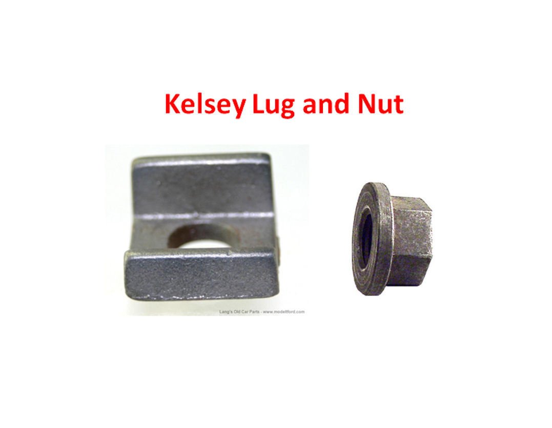

Short answer: As mentioned above the flat sided demountable rim nut (part number 2848B – Kelsey wheels USA and Canada) goes with the flat sided loose lug (also called Clamp in the Ford Price List of Parts) (part number 2846B).
The demountable rim nut with the tapered shoulder (part number 2848) were first used with the Hayes fixed lug style rims and wheels. They were also used later with the Ford USA supplied fixed lug rim and wheel. Still later they were used with loose lug rims part number 2845-D used with the loose lug or loose clamp part number 2846-D that had the recess for the tapered shoulder to fit into.
Caution: While some of the parts will fit other wheels – sometimes that is NOT safe. For example, you can attach a Ford 2845-B loose lug Rim or a Ford 2846-B loose lug Rim to a Kelsey felloe. But, the Kelsey felloe normally will NOT have a cup around the valve stem to keep the 2845-B rim or 2845D rim from rotating on the wheel. Front wheel without brakes or engine torque is not as big an issue. But on the rear wheels the rim rotates when you apply hard braking or acceleration and the valve stem is cut. Not a safety issue if you have a flat as you come to stop in your drive way. But if you are going 30 mph, brake hard and the rear wheel goes flat at 25 mph etc. – you could loose control of the car.
Recommend you study the prior postings or take photos of each fellow showing if the valve stem does or does not have a cup around it. A photo of each rim – does it have a lug around the valve stem that fits into the felloe cup? Or does it have the Kelsey lug that fits over the rim bolt to keep it from moving or turning on the felloe?
Do you have all the same type of rim? And if so which type? My recommendation would be to have a set of wheels and rims where you could put any rim on any wheel. It simplifies flats later on. For 1923 the Canadian production line would have had Kelsey demountable rims, Kelsey demountable rim nuts and Kelsey wheels.
And remember there were aftermarket companies as well as other cars (Ford USA, Chevy, etc. that also used 30 x 3 1/2 inch clinchers).
That your wheels have the Canadian style spokes is promising. Ford USA did not do that to my knowledge. So that increases the chances that the wheel/felloes are Canadian Ford. (But as mentioned above Kelsey supplied other makes also.)
Some photos showing the wheel felloes, rims, should help clear this up. The previous posting contains enough information to solve the questions – but they are not all neatly put in one location. (That is on my “when I get retired “to-do-list.” Hopefully someone will beat me to that.

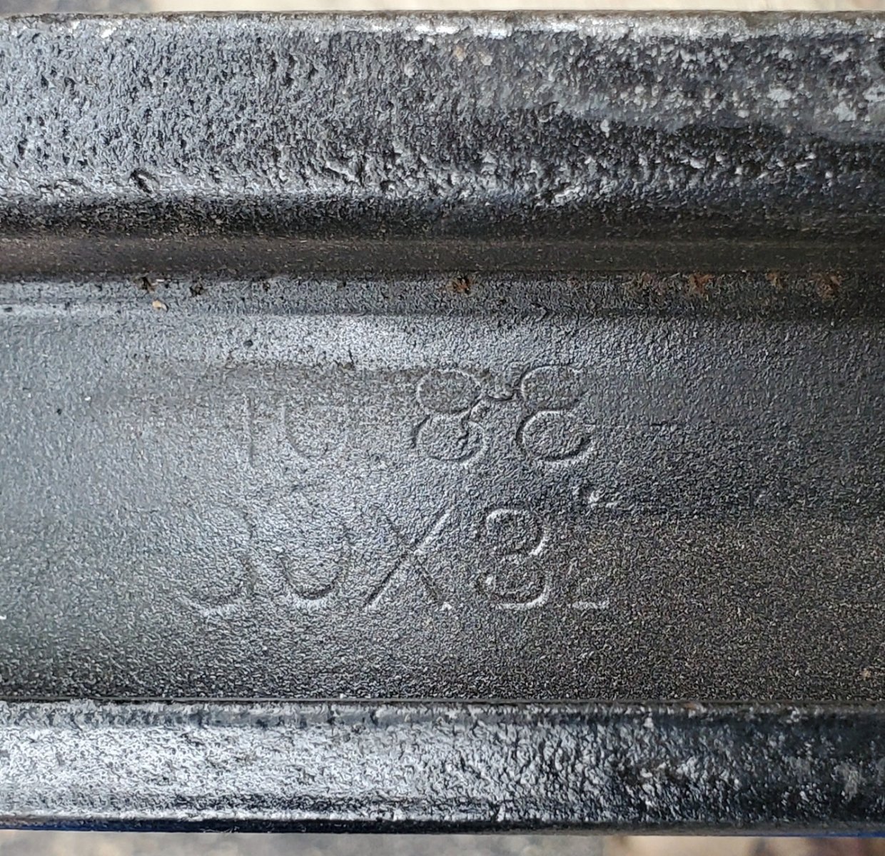

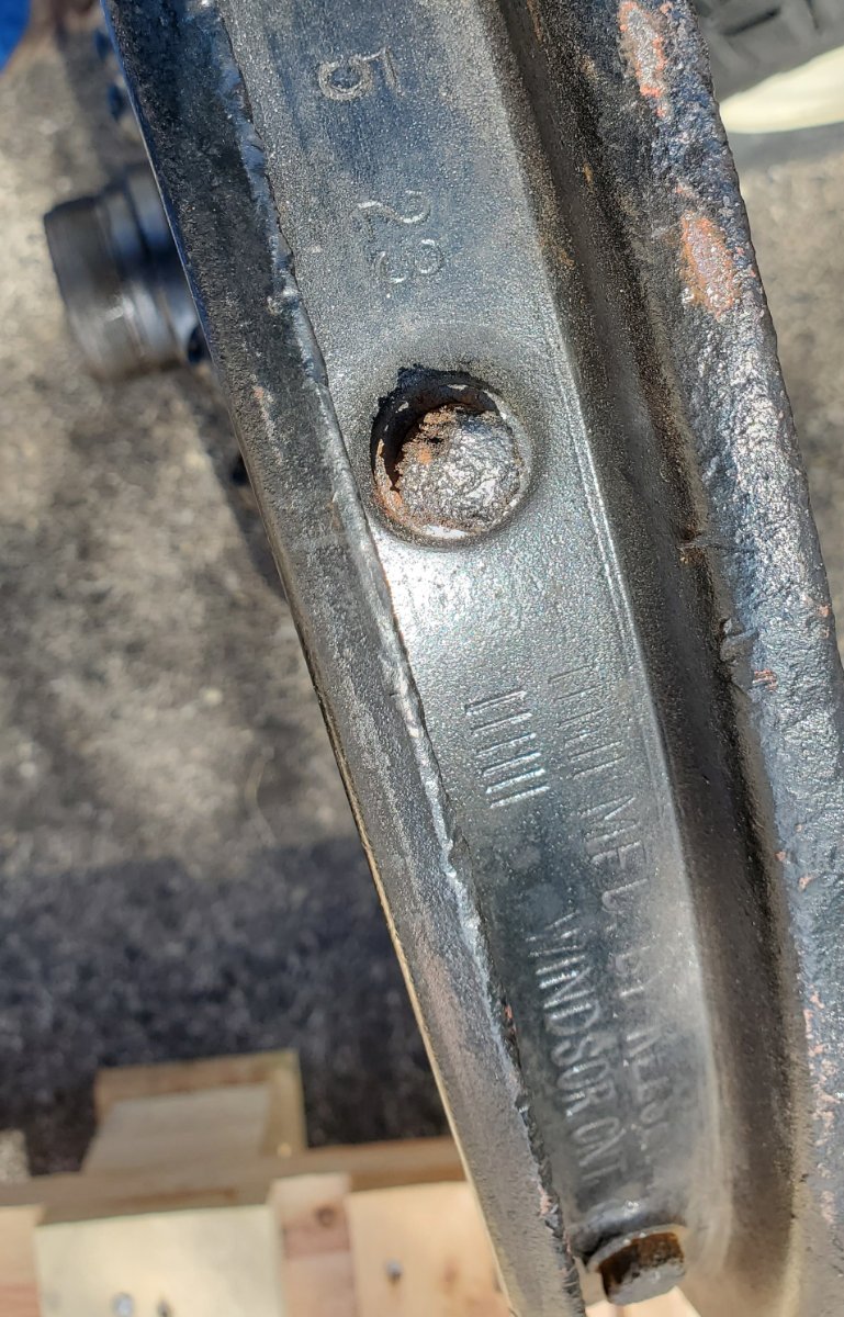

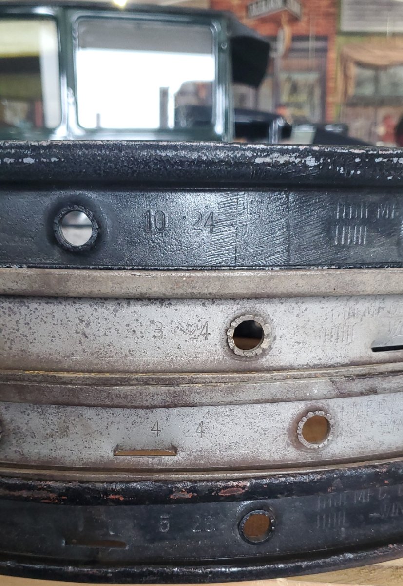

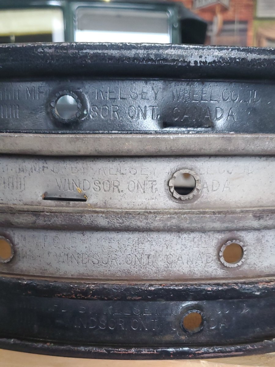

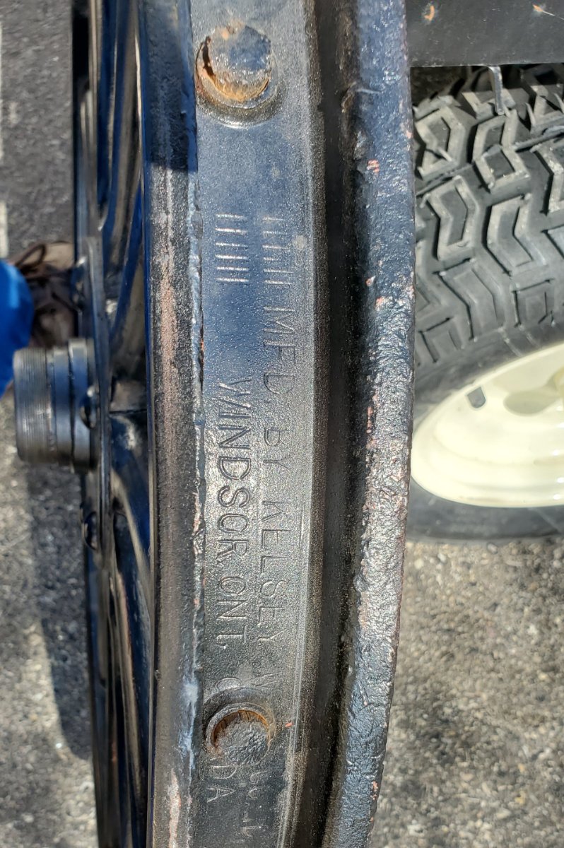

Here are a couple pics of the felloe.
Notice the date- 5 23
Also Kelsey Wheel
Windsor Ontario Canada
I have 3 of the Kelsey 88 rims.
Also Kelsey Wheel

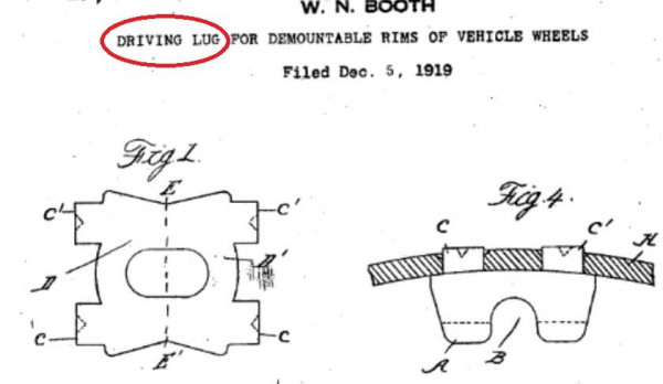

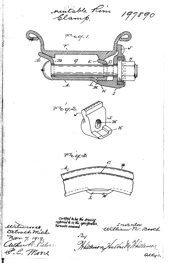

Look what I found.
Canadian Patents Database / Patent 197890 Summary
(12) Patent: (11) CA 197890
(21) Application Number: 197890
DEMOUNTABLE RIM CLAMP
Chris Brancaccio
MTFCA Webmaster
MTFCA Forum Admin

More on the Canadian patent 197890
Looks like a 1919 US patent filed in Canada in 1920
https://www.ic.gc.ca/opic-cipo/cpd/eng/ ... sic_search
(72) Inventors :
WILLIAM N. BOOTH (Not Available)
(73) Owners :
(45) Issued: 1920-03-09
The patent clearly shows a flat nut, not the conical ones I have. The patent does not even show both sides of the clamp.
It seems to be patenting the L-shape of the clamp more than anything else, to prevent the lug from turning.
(72) Inventors :
(73) Owners :

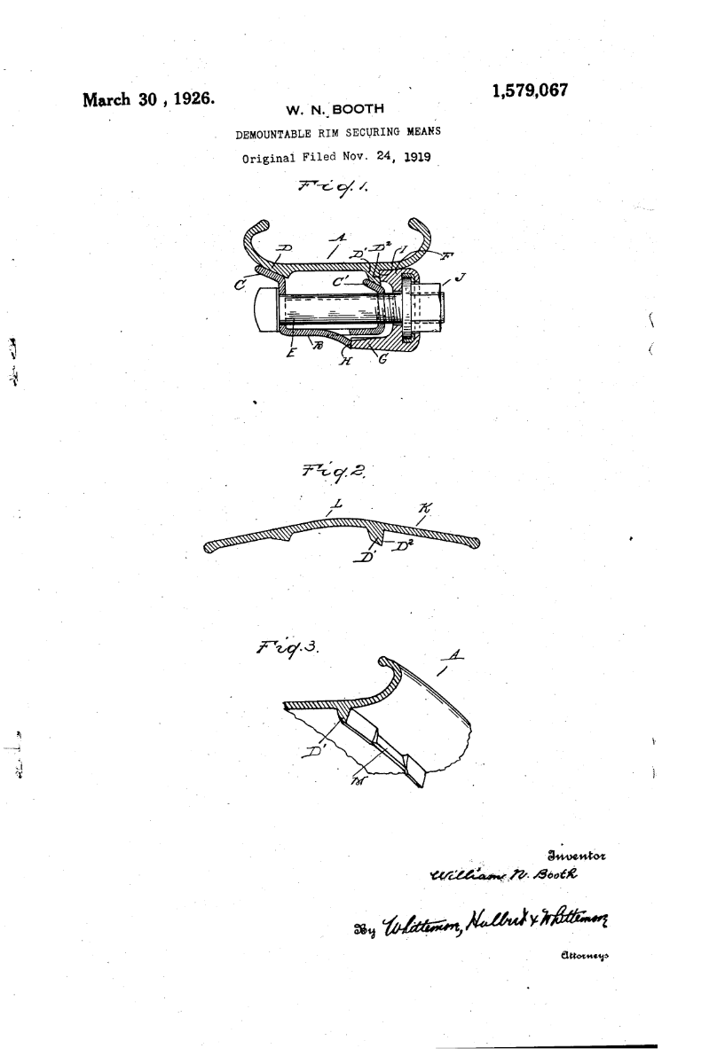

Found the equivalent US patent 1,579,067 but this one dated 1926

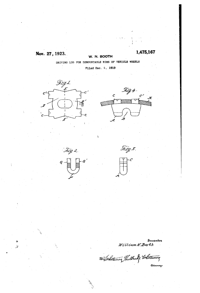

Found US patent 1,475,167 for what looks like the driving lug on the Kelsey 88 rim.

Found more interesting stuff.

- Posts: 7279
Chris, the term "driving lug" is quite misleading. Is that description part of the patent paperwork? The purpose of that lug is simply to stop the rim spinning on the felloe If the lug bolts get loose. Other brands used a collar around the valve stem hole and a corresponding smaller collar around the valve stem hole on the rim. On fixed lug rims neither was necessary.
On all clincher rims the "drive" is catered for by the wedging effect of the rim on the felloe. All the four bolts/lugs/nuts have to do is maintain the tension to keep the wedge tight. On badly worn rims/felloes, the fixed lugs on that type of rim can register on the outer edge of the felloe. In such cases, the four lugs do become 'drive' lugs. I have seen this on loose lug rims too. When this happens, the bridge lug wears and also cuts a groove in the bolt over which it is fitted.
Hap_Tucker
- Posts: 409
- First Name: Hap
- Last Name: Tucker
- Location: Sumter, SC
Allan,
Yes, the patent application used the term "Driving Lug" for that part. See the expanded view from Chris' earlier posting:
Ref you question of when were the fixed lug Kelsey rims introduced in Canada's production. The MTFCI Seventh Edition for the 1920-1924 state "Kelsey rims, with removable tabs..." For 1925 they have they had, "Kelsey rims used with demountable rims..." They dropped the "with removable tabs" from the entry.
From memory (not nearly as good as written or photograph information) I believe it was Roger Gardner author of "Ford Ahead - A History of The Colonial Motor Company Limited" (New Zealand) who shared something along the following: That he believed Ford of Canada tended to ship the older style parts to the countries overseas and used the newer style parts in Canada's production first. That was based on his observations.
Additionally, when Ford of Canada introduced a new part -- there would have been many of the older style parts already in the overseas countries as well as some older style parts that had recently been shipped. That would have happened even if they did not purposefully send all or most of the remaining older style parts overseas to get rid of them.
And in many cases, there would be an overlap period when both old style parts and new style parts were used. For example, there was approximately a six month overlap during USA production when both the two-door valve cover engine block and the single valve cover engine block were being produced and installed in new cars.
In the case of Ford of Canada wheels 1924-1925 -- they would need to make sure that all four wheels and 5 rims would be for the same style wheel and rim (Kelsey loose lug or Kelsey fixed lug). But I suspect there would have been some overlap when production used either style but the same single style on any individual car. I would assume that similar cases of overlap occurred in New Zealand, Australia etc.
Respectfully submitted,
Hap l9l5 cut off
Hap l9l5 cut off

Thanks Hap. So officially, it is a driving lug, even though it does not serve that purpose.
Your thoughts on the 1925 adoption of the fixed lug rims by Canada is in line with the fossil evidence of which I was aware. I was not aware of the late 1925 adoption of same, attributing fixed lug rims to all our 25 models.

Another discovery - No. 88 30 x 3 1/2 on inside of felloe

And yet another discrepancy, 2 different felloes, one weighs 6 lbs. and the other type weighs 8 lbs.
The heavier 2 are stamped Kelsey and have date codes, the other 2 have no markings.

Chris, I presume both ave the stamped in rests on which the loose lugs engage. Is the inside land on the felloe the same width? Are they exactly the same diameter? The fixed lug felloes on US wheels are slightly smaller diameter on the inside, which means the spokes the vendors sell are too short to use when rebuilding Canadian loose lug wheels.

On closer inspection the lighter ones do in fact have Kelsey Wheel stamped on them.
I believe the important dimensions are the same - ie. where the rim meets the felloe front & back.

I now have 4 matching felloes (or is it felly?)
The dates are from the top 10-24 3-24 4-24 5-23

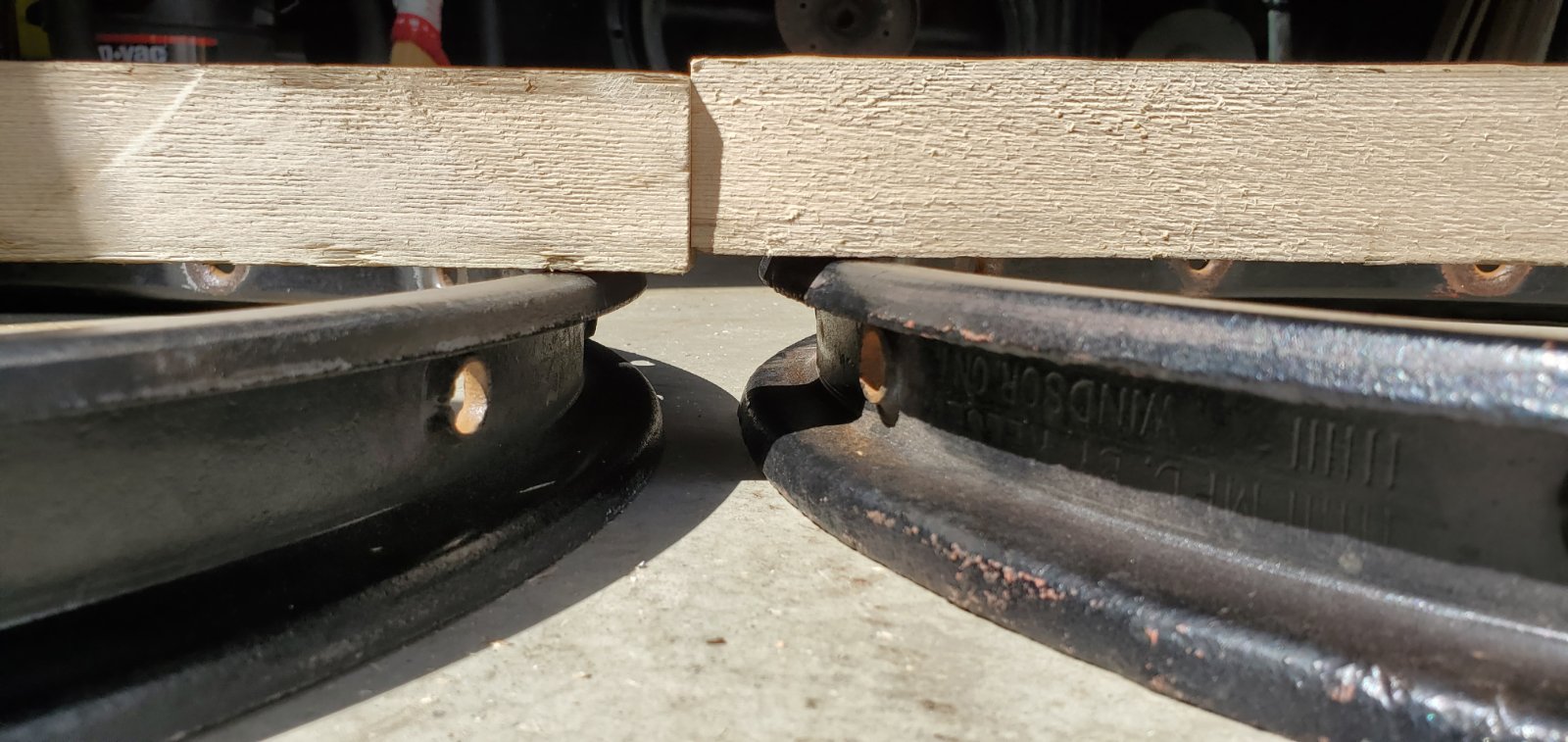

Chris, somewhere in these posts reference was made to how the rims contact the felloes on the outside and the inside edges. In my observations of Kelsey loose lug rims and later fixed lug rims used on our 1925 models, neither type binds on both edges of the felloe.
On sound Kelsey loose lug felloes, a rim in good condition is wedged onto the outer felloe land as the lug nuts are tightened. This jamming is what gives the rim its 'drive'. It is quite easy to insert a credit card between the rim and the inner land on the felloe.
On fixed lug type wheels, the inner land on the felloe is wider than the outer land. As the lug nuts are tightened the rim is jammed onto the wider inner land, and this gives it its 'drive'. When both rim and felloe are in good condition, the fixed lug sits proud of the outer face of the felloe and the credit card will insert between the felloe and rim on the outer edge. On some felloes, the outer land has even been eliminated, as it serves no purpose in mounting the rim.
Just remember, if you are rebuilding Canadian wheels, the new spokes on offer do not have the front to back, alternating taper at the hub. Also, the Kelsey loose lug spokes are longer than the usual US spokes used in fixed lug rims.
Hope this helps,
Hope this helps,

Looking at the dates on the felloes above and my serial # C414,xxx it seems that only 1 of them could have came on the car.
Canadian production number snippet
May 31, 1923 C412,290
Jun 30, 1023 C419,611
Doing a little math, my car was built on June 10, 1923

Chris, I have never taken notice of dates stamped in felloes before. Next time I have the rims off Henrietta I will take a look. I did note the rim dates. Four were dated 3 25 and the fifth was 2 25.

Chris, I have one photo of a 3 - 25 rim on my new phone, but I need you to take me through the upload process again!
The dates are just like the ones posted in your felloe photos. The No 88 and 30 x 3 1/2 is set out in the same way. Having the stampings in a rim is a reasonable indication that the rim is a good one. Being the mobile rust traps that they are, the lettering is usually beyond being readable.

Page 280 of the Ford Service Bulletin Essentials book on the various demountable rims. Jim Patrick
