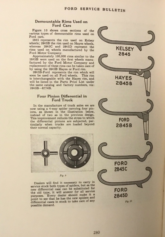

Kelsey wheels use loose lugs with flat back nuts and have felloes and rims like this:

I wonder if a prior owner cut a taper into some of your loose lugs so that they would work with the cone nuts.
If you want to switch to all flat nuts, the vendors sell modern reproductions of the lugs and nuts. Unfortunately the modern lugs will not have the embossing.

Not all Kelsey 88 rims have that rolled in groove which clamps down on the wheel felloe. These have that slot in the rim where the loose lug engages. This lets water in and makes rust a problem. The discontinuity in the surface on which the lug engages also leads to premature wear if the lugs are not kept tight.
The better Kelsey 88 rims have a flat base where the tyre fits, and a continuous steel band around the rim which engages on the felloe. These rims are easier to mount truly using the band as a reference in relation to the felloe. They do not have the same rust problems and the land for the lug is easily repaired if necessary.
Chris, being a Canadian car, do the spokes have the alternating tapers, outside to inside, on the hub end of the spokes. All our Australian ones do.

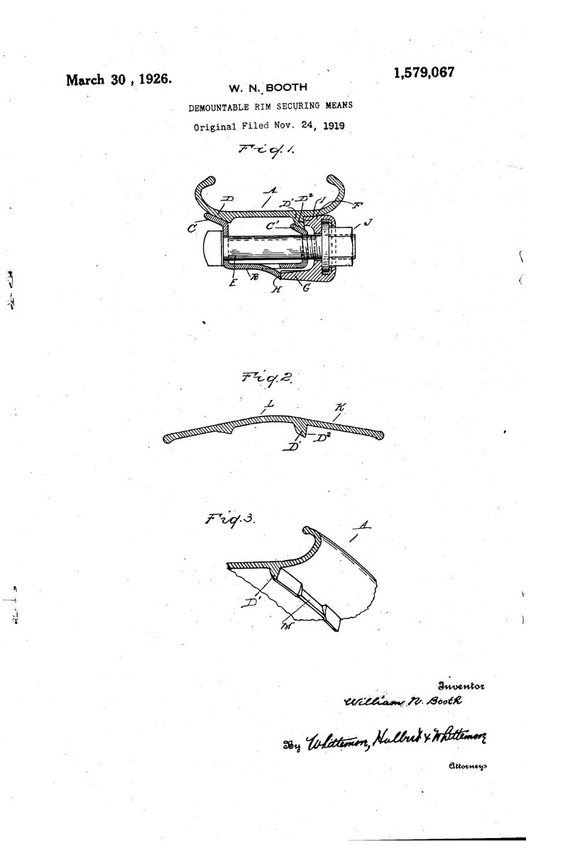

Look what I found.
Canadian Patents Database / Patent 197890 Summary
(12) Patent: (11) CA 197890
(21) Application Number: 197890
DEMOUNTABLE RIM CLAMP

More on the Canadian patent 197890
Looks like a 1919 US patent filed in Canada in 1920
https://www.ic.gc.ca/opic-cipo/cpd/eng/ ... sic_search
(72) Inventors :
WILLIAM N. BOOTH (Not Available)
(73) Owners :
(45) Issued: 1920-03-09
The patent clearly shows a flat nut, not the conical ones I have. The patent does not even show both sides of the clamp.
It seems to be patenting the L-shape of the clamp more than anything else, to prevent the lug from turning.

Found the equivalent US patent 1,579,067 but this one dated 1926

Found US patent 1,475,167 for what looks like the driving lug on the Kelsey 88 rim.

Chris, the term "driving lug" is quite misleading. Is that description part of the patent paperwork? The purpose of that lug is simply to stop the rim spinning on the felloe If the lug bolts get loose. Other brands used a collar around the valve stem hole and a corresponding smaller collar around the valve stem hole on the rim. On fixed lug rims neither was necessary.
On all clincher rims the "drive" is catered for by the wedging effect of the rim on the felloe. All the four bolts/lugs/nuts have to do is maintain the tension to keep the wedge tight. On badly worn rims/felloes, the fixed lugs on that type of rim can register on the outer edge of the felloe. In such cases, the four lugs do become 'drive' lugs. I have seen this on loose lug rims too. When this happens, the bridge lug wears and also cuts a groove in the bolt over which it is fitted.
- Posts: 397
- First Name: Hap
- Last Name: Tucker
- Location: Sumter, SC
Re: Kelsey loose-lug wheels
Allan,
Yes, the patent application used the term "Driving Lug" for that part. See the expanded view from Chris' earlier posting:

Page 280 of the Ford Service Bulletin Essentials book on the various demountable rims. Jim Patrick
