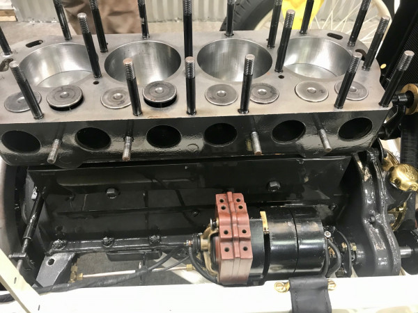

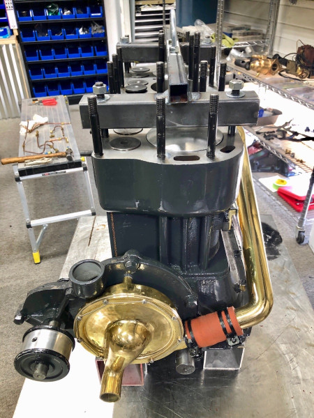

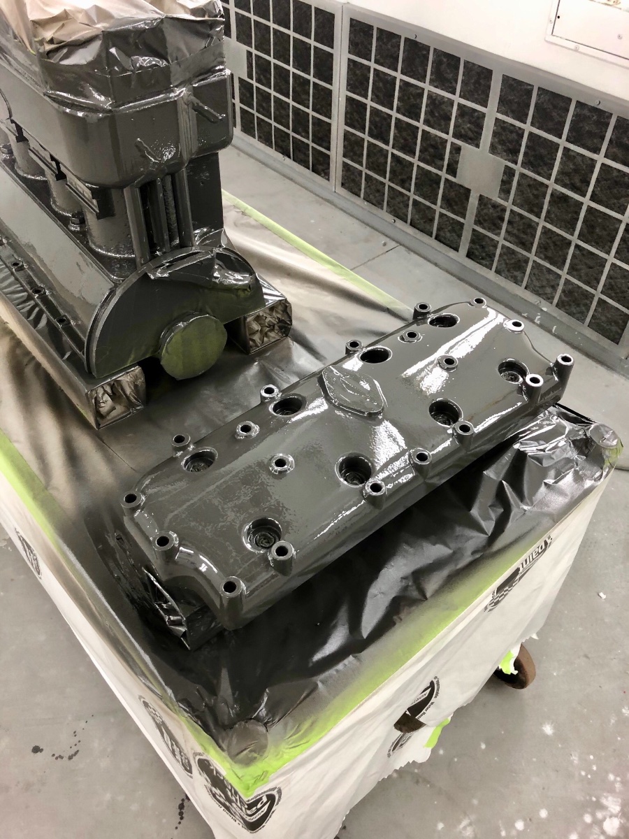

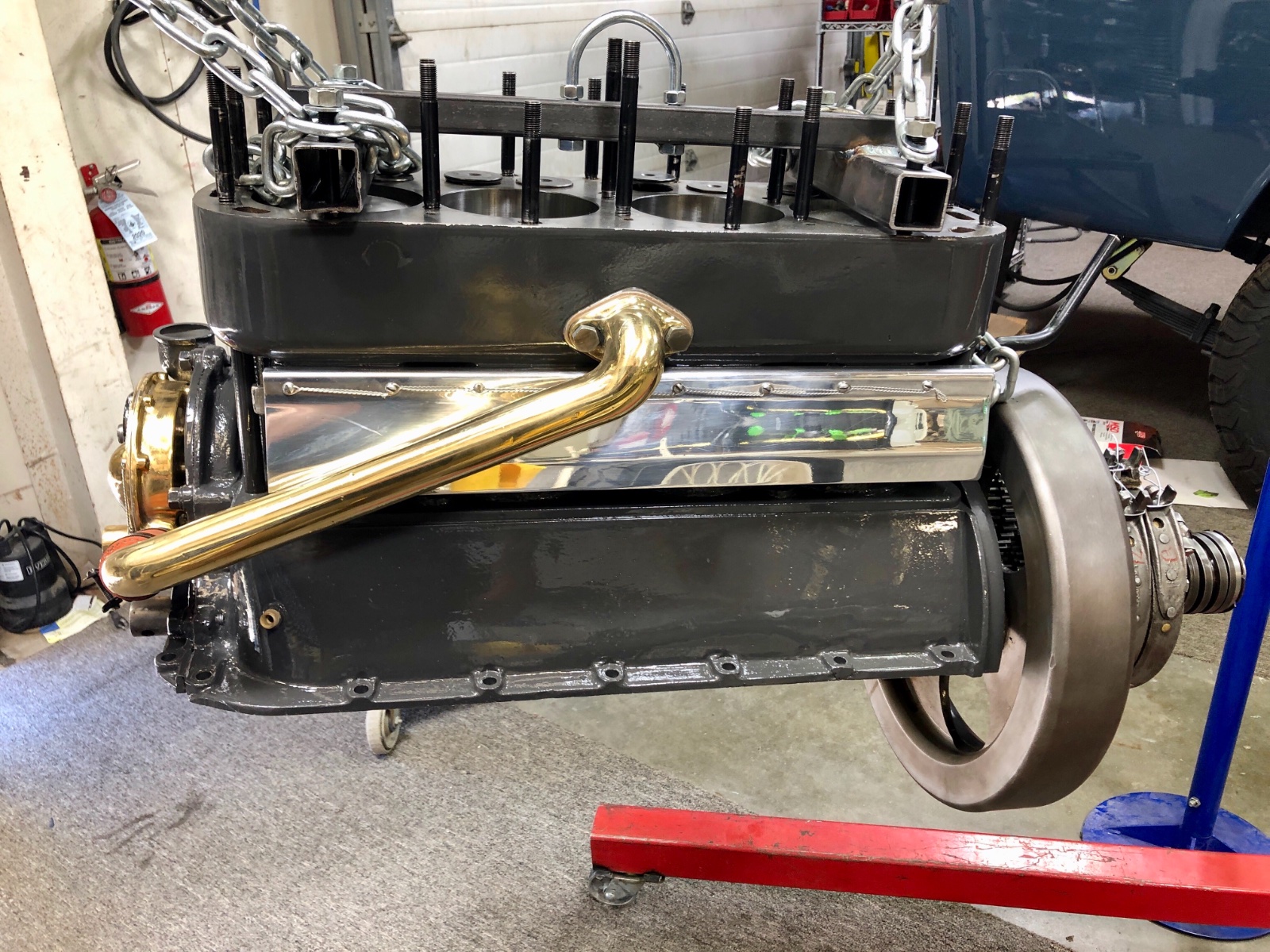

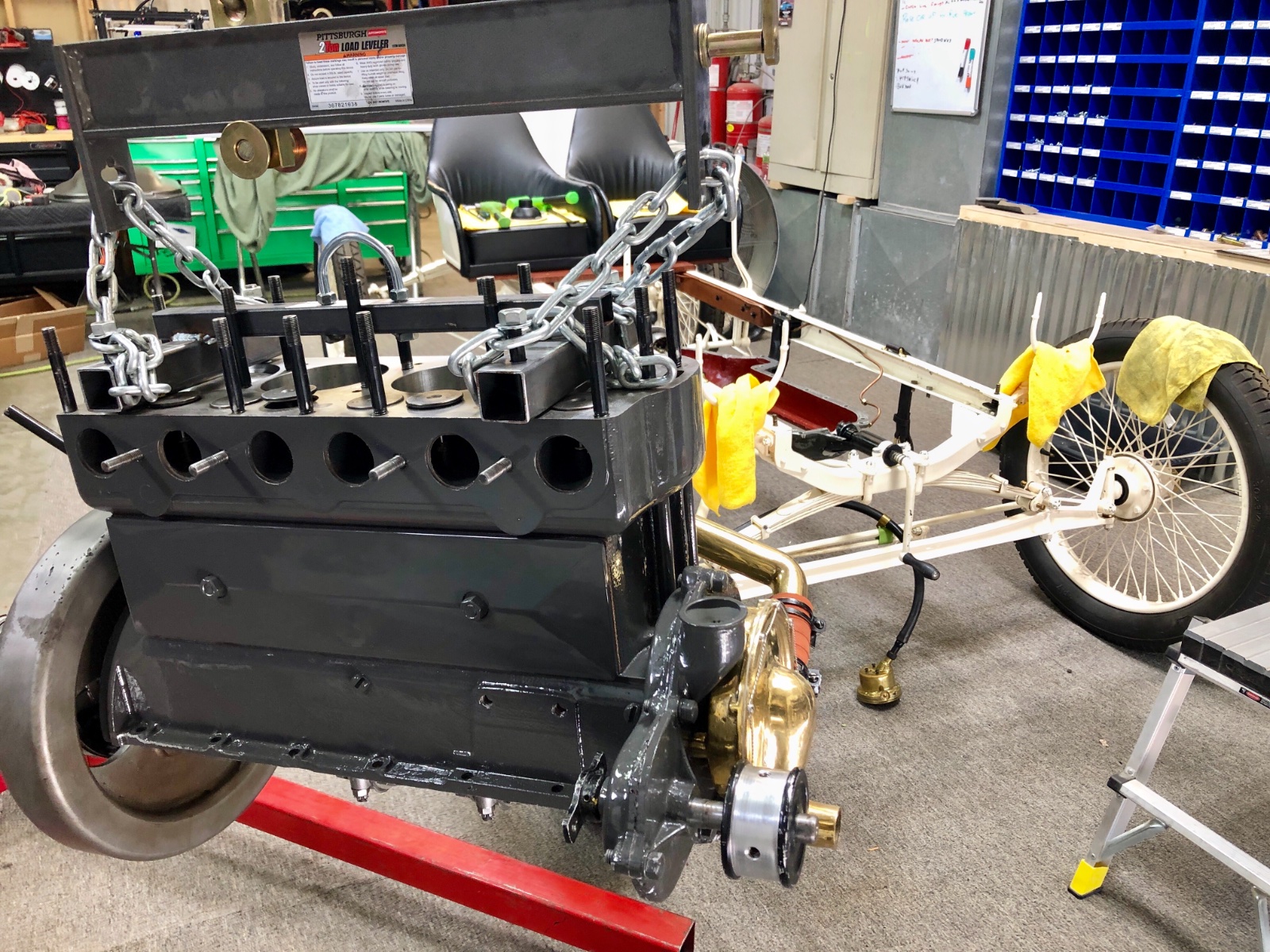

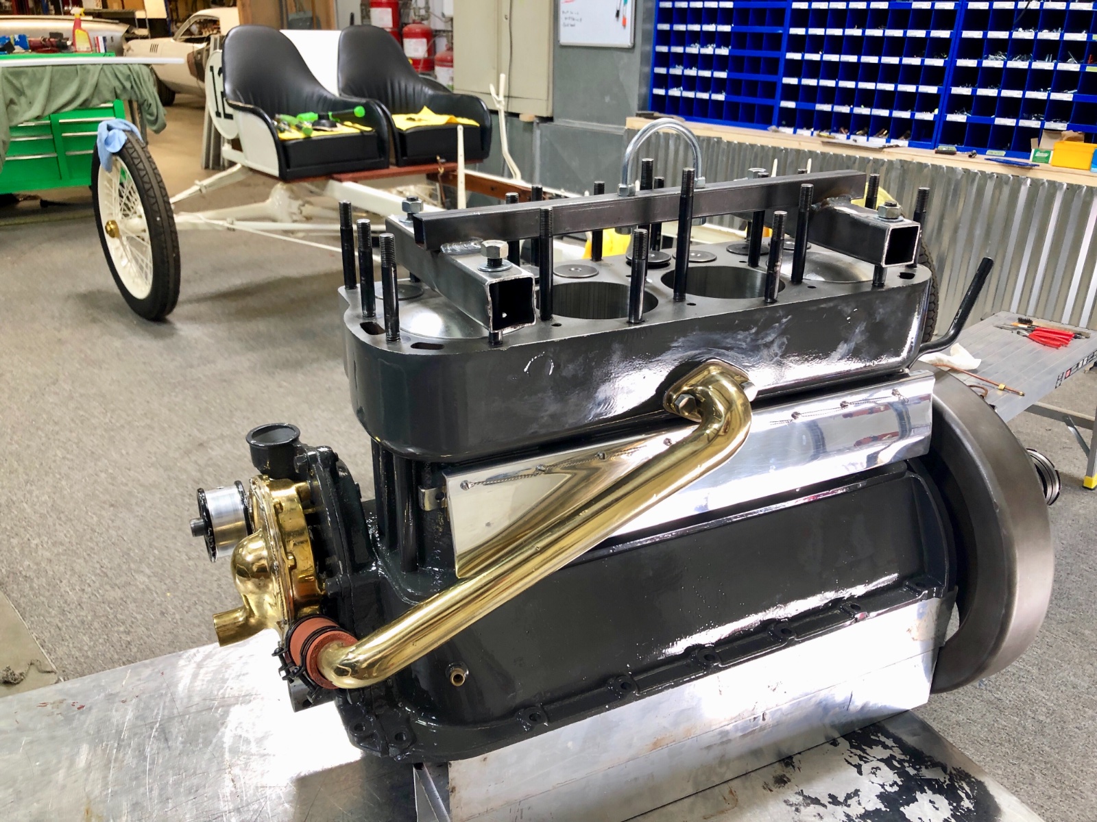

Our 300 cu in motor is almost finished. Tony Schafers, lead instructor at our local college took on the motor after some damage last summer. This is how it looks now. Awaiting the headgasket, then back together and into the car. We’ve had tremendous support with this project, from Fawcett Restoration in Canada, Dean Yoder, Mike Vaughn and Bruce Van Slone with electrical and transmission, and Ben at No Coast Custom and Rod. Stan Howe rebuilt the big five ball carb, and we’re about to put it on the road again.

Such a big beautifull beast that motor...

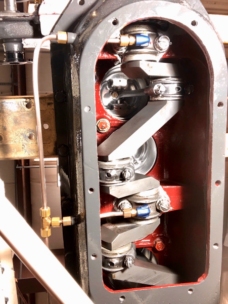

were those extra oil lines an original fixture or did you add them for safety ?
Thanks for sharing the pictures !

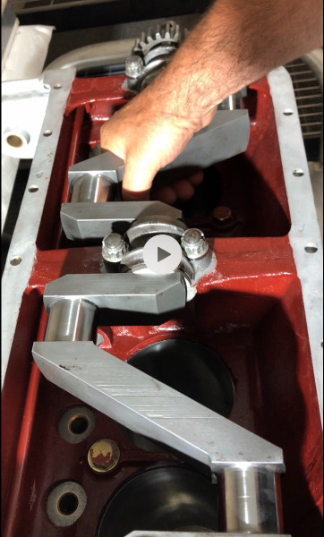

I think I overheated the motor last summer, and there was scoring on the pistons and cylinder walls. Fortunately we were able to hone the cylinders, but needed new pistons. When Tony got into the motor, the crankshaft also didn’t turn well (videos below) and was binding. The shaft was straight and the bearings were fitted, but evidently not in line. He did a little sanding and brought everything into line.
Before:
https://www.dropbox.com/s/aaydr5fc7f9ye ... M.mov?dl=0
After:
https://www.dropbox.com/s/72b7r9chw7nje ... M.mov?dl=0
Screenshot of before video:
Before:
After:

Now Rob. Was that a test to see if we noticed in the first video that you tightened the nuts on the bearings too tight and forgot the shims, and then you left off the bearings and nuts in the second video so it would spin so well? Everything looks so nice and clean. Does Tony scrub that shop down every night?

LOVE those bucket seats! jburns79se@aol.com

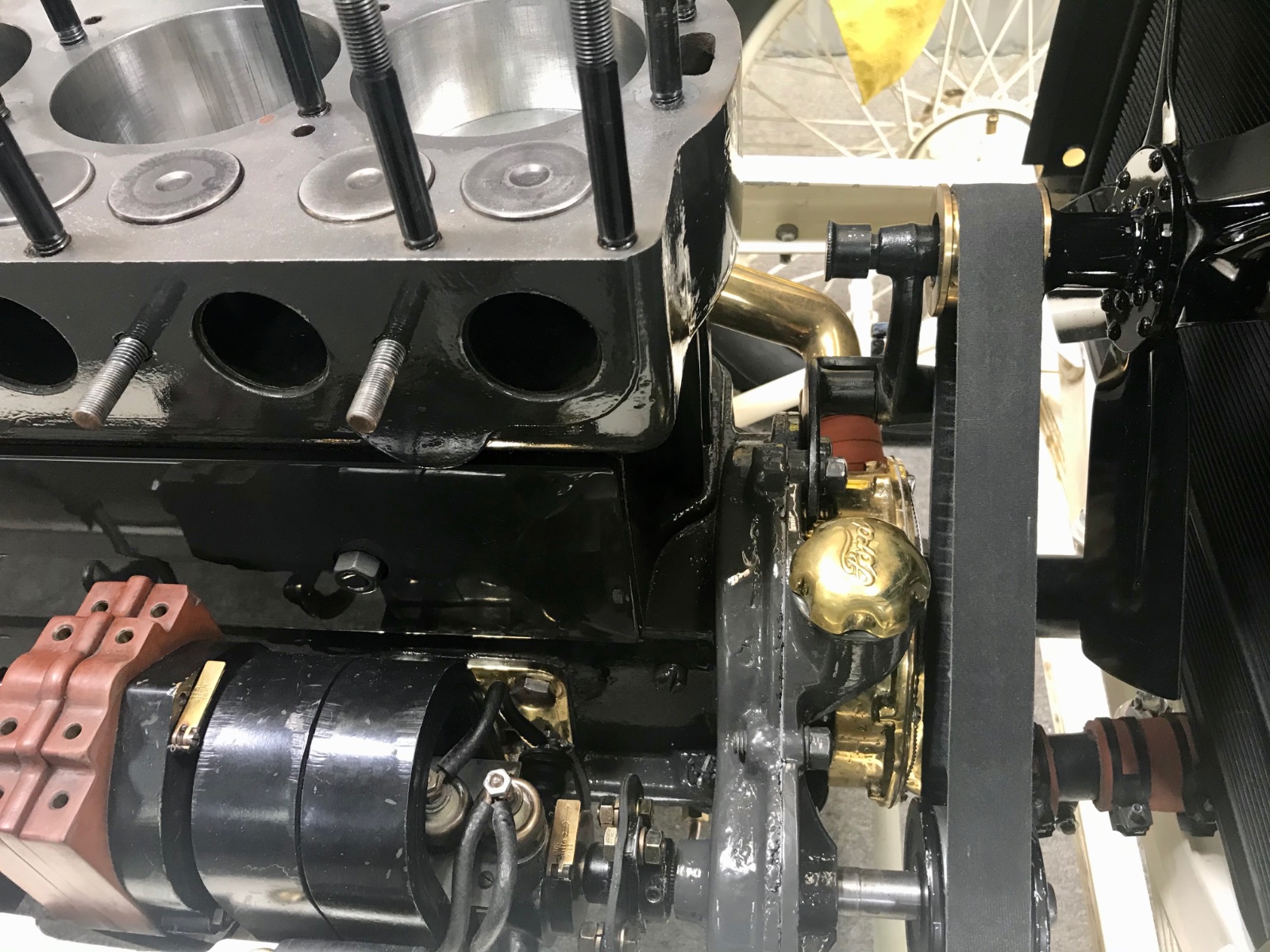

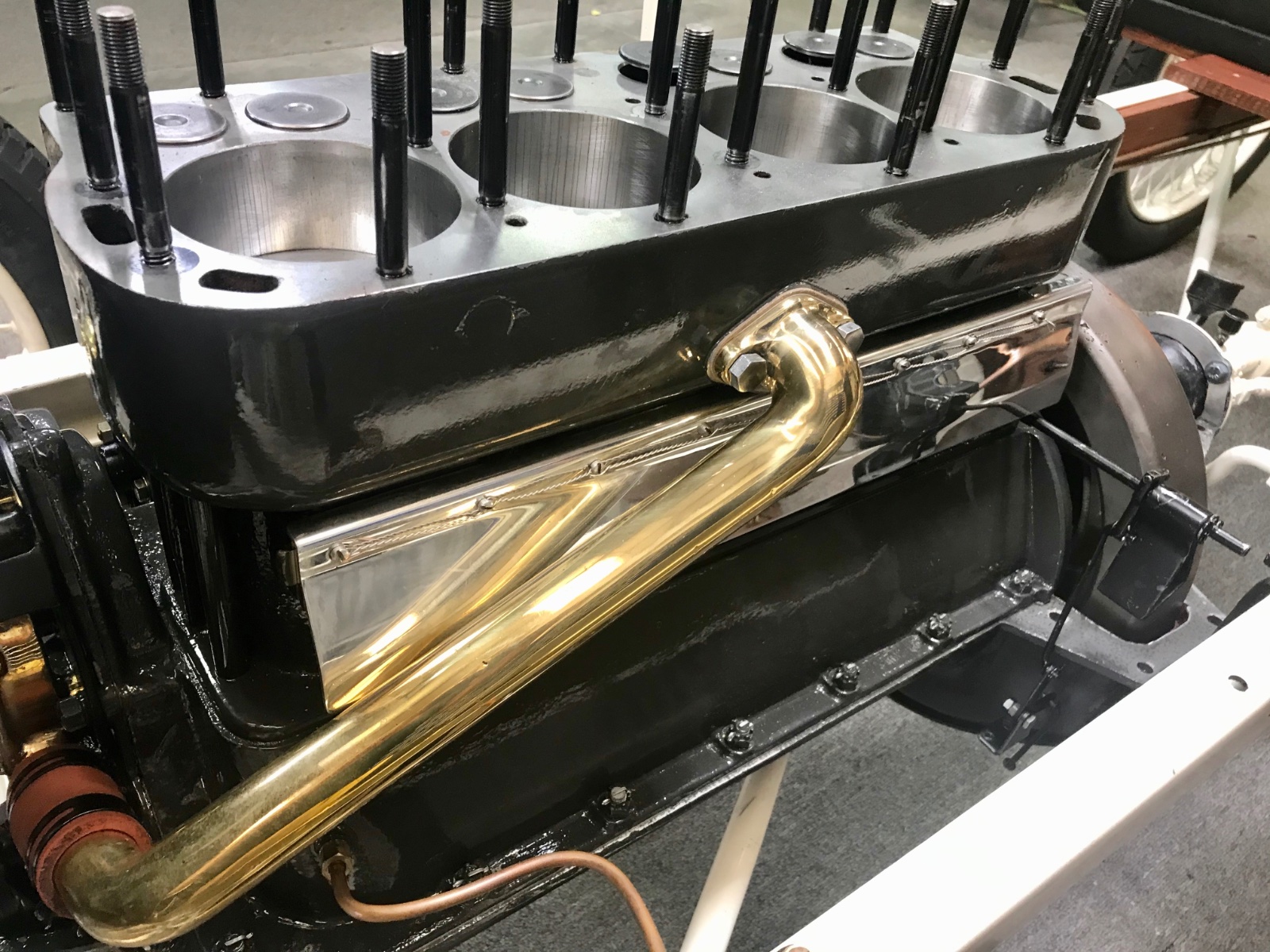

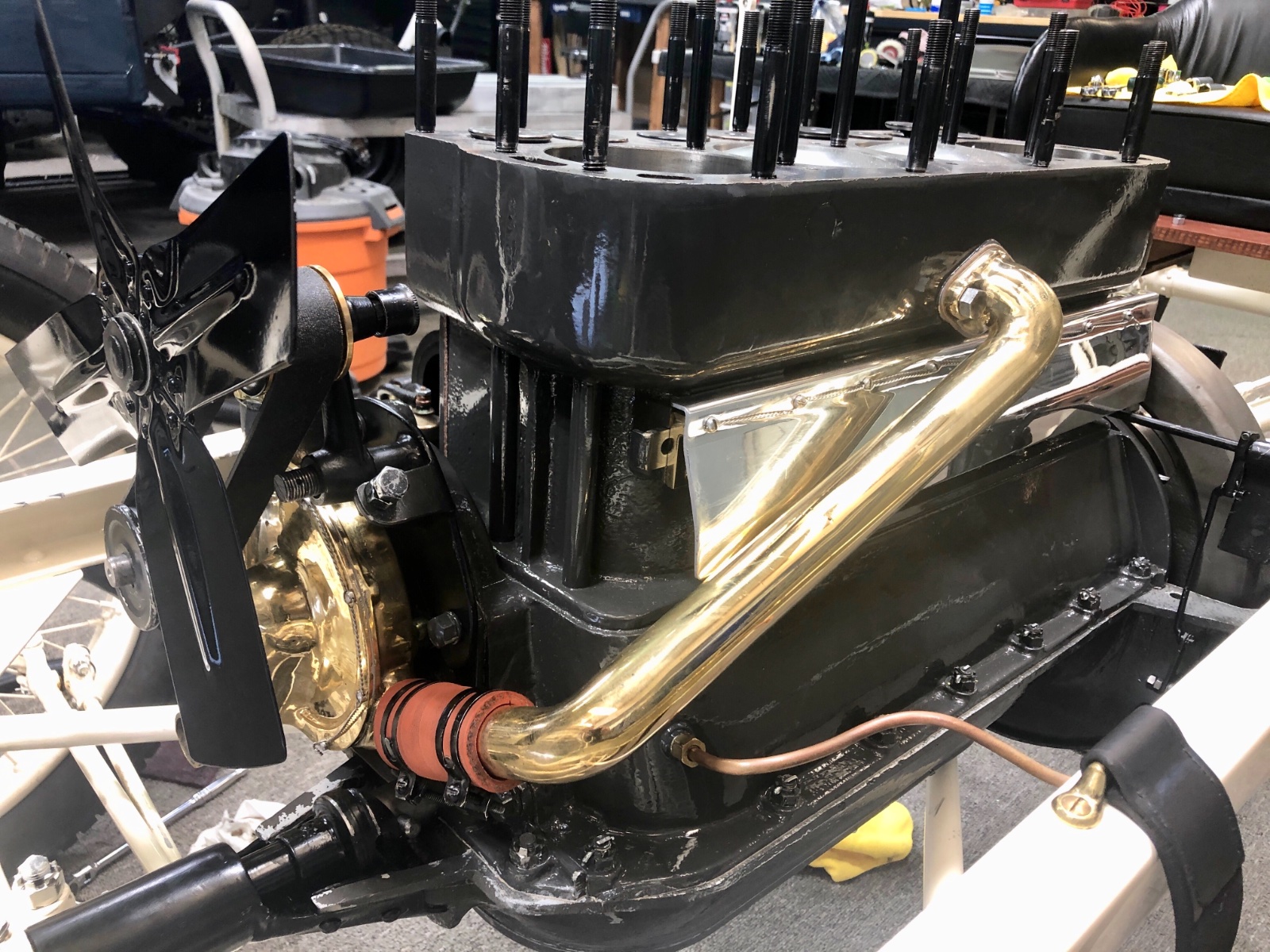

Stopped in today to check on a few things. Pics include the 09 style waterpump, magneto drive with dual spark Bosch mag and deflector shield over auxiliary exhaust ports:

I want to know where you found the dual spark Bosch... all the dual spark goodies are getting hard to find any more, even the formerly somewhat common Delco Dual Distributor setups aren't easy to put ones hands on.

Susanne, the dual spark was with the motor/project. It’s similar to the one on the 410 cubic inch Ford Special racer at THF. I don’t know if it was with the motor originally, or found and added to the project at some point in time.
