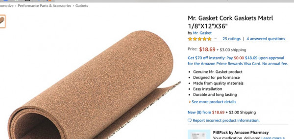

There are no Model T motor kits with cork anymore.
But sheet cork gasket material (aviation grade) is made. I keep a roll in the drawer for making gaskets for things that don't have 'em. :)

I too prefer cork in some places and have made my own forever. Especially tin covers of any kind but I seldom use sealant.
Head down to your favorite parts store also for cork rolls.

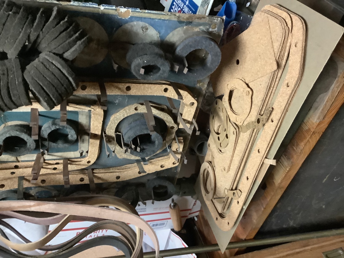

Are you wanting a specific gasket in cork, or a set Dan ? I think Mr Morsher cleaned me out.

Yup! Dave’s got a memory like a steel trap

Lotsa nice goodies!
