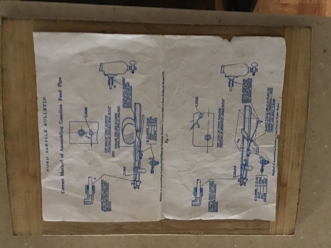

Took my gasline out while ago and cant remember if the new one goes over or under the hump cross frame? Does it even matter?

Here’s the routing information. Hope it helps. I also have a 24 Coupe and this is the way I did it.

I saw this but tought it did not show what I needed. But when you sent it I looked at it closer and realized it does show what I need. If you had not sent I would still be out in the ozone still looking around. Thanks

Yes the gas line goes over the hump. When I bought the gas line a few years ago it came with the reprint from Ford about installing the gas line.
I found out that my car didn’t have the gas line clamp and it was missing. So I had to order the clamp. Iv’e had the car over 50 years and it had been taken off before I inherited it in 1959.
If you look closely at the print you can see the clamp.
