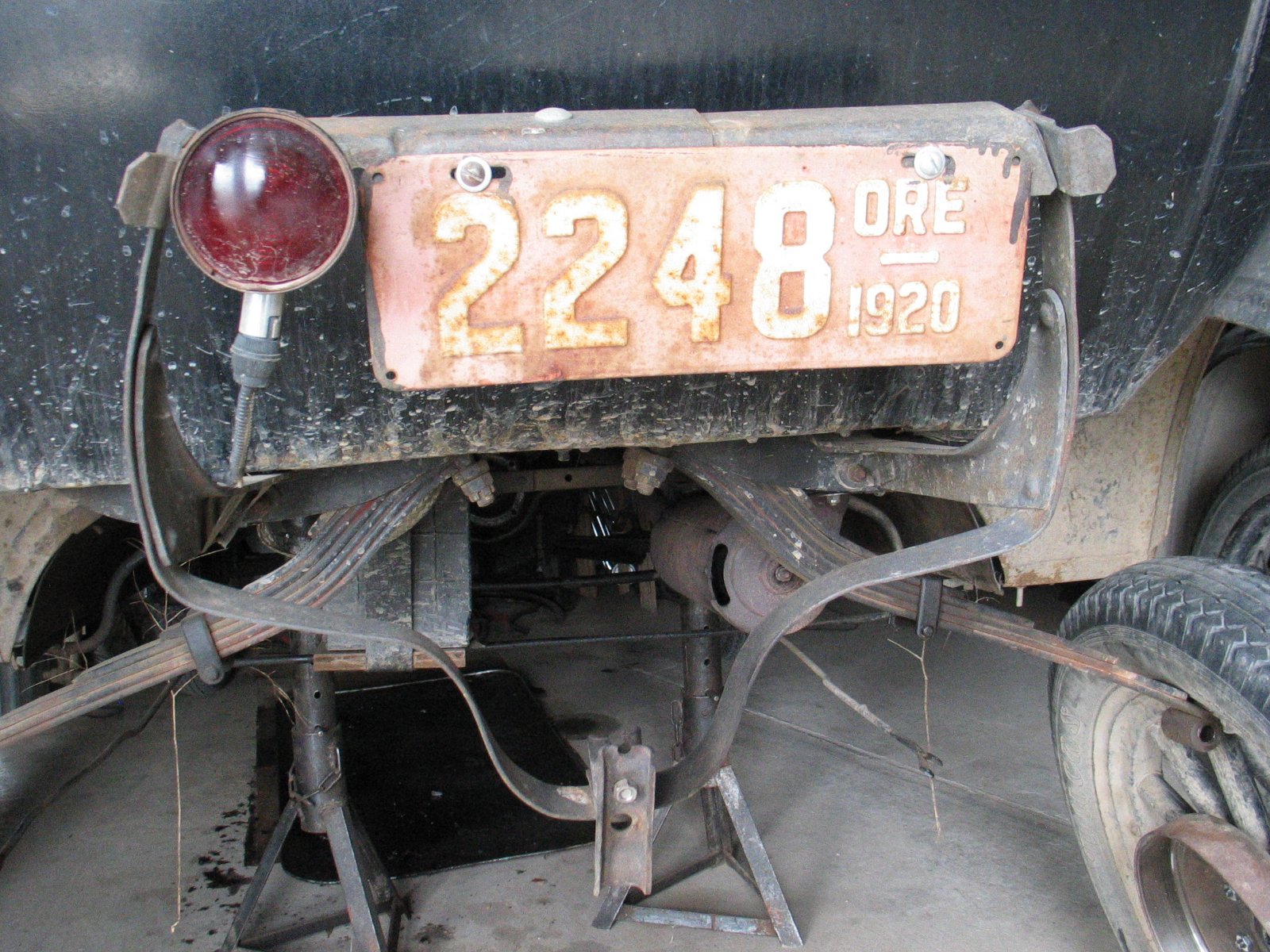

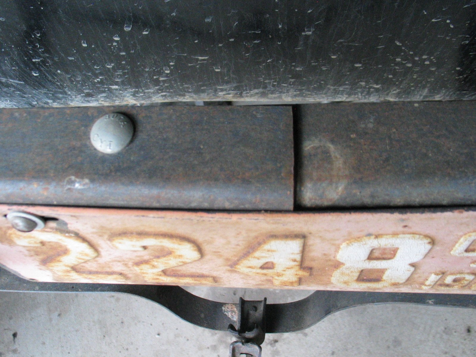

This is how I modified a 30x3 1/2 carrier to except a 21 in spare and it can be reversed if you want to.
