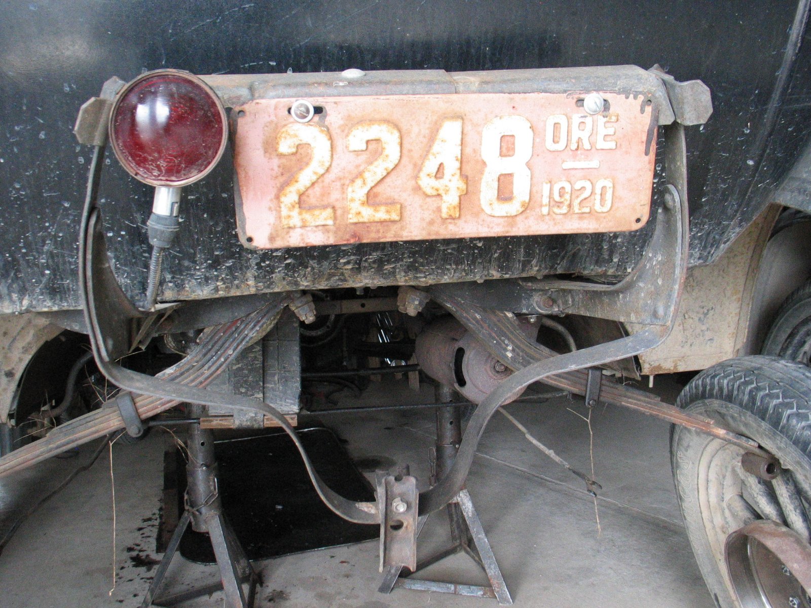

- Posts: 404
- First Name: Dennis
- Last Name: Prince
- Location: Madras Oregon
Re: Modifying Rear Spare Carrier
This is how I modified a 30x3 1/2  carrier to except a 21 in spare and it can be reversed if you want to.
