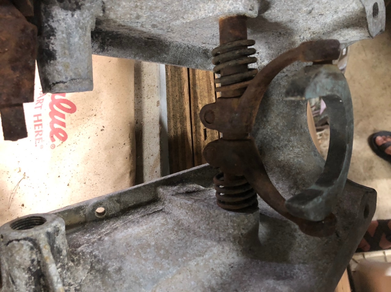

RV, is this one like you’re talking about?
Brad

Post by R.V.Anderson » Tue Jul 07, 2020 2:02 pm
Yes, that's the shaft. Actually, according to Ford, the ribs first appeared in some 1912 covers but it wasn't until late 1913 that they all had them.
