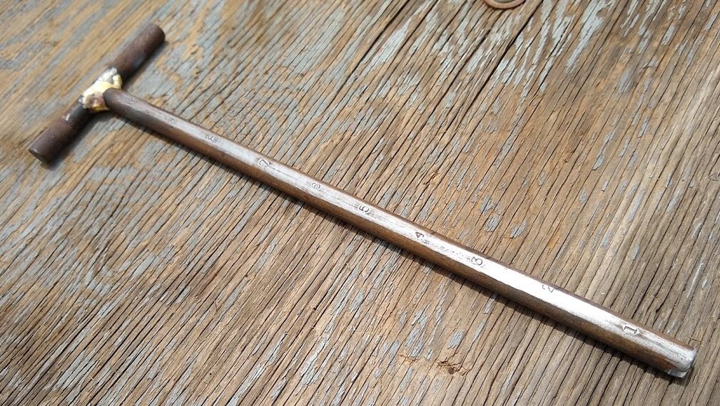

Since I've been driving my 27 coupe around more, including a trip to Tombstone this morning, I decided I need to start checking the fuel level occasionally. I haven't had much luck with the paint stick method. I tried a few other things, and decided that it needs to have a nice porous but high contrast surface, and also have a way to prevent me dropping it in the tank, plus it needs to stay vertical, which helps always go to the same depth. I looked at pictures of a bunch of others, and this is what I ended up making. It's all brand new, but the idea was to make it like it could have been made it a long time ago.
Time will tell how well it works. I think there's enough reserve capacity built into my measurements, to keep me safe. I like to fill up most cars around 1/4 tank, anyways. Note the slot at the bottom end....multi purpose tool.

I tried a couple different bare wood paint sticks, as well as some other things. The best results I got were with rusty steel! so that's what I used. It's easy to see the gas level with it.
Thanks for the suggestions! I guess a real stick, would work best. But this one kept me busy for half an hour making it, so I can't complain.

Thanks for all the suggestions. The cowl tank is a bit different than the under seat tanks, which led to my strange, long list of requirements...which my gauge meets, but none of the others do. The tank shape lets you put the gauge in at an angle, which you don't want to do, and also it's in an awkward place.
Like I said, time will tell how well mine works.

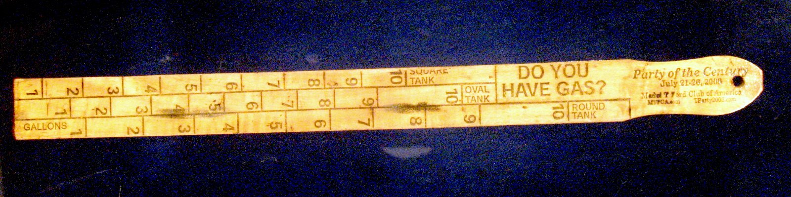

I use the traditional wood stick with Ford markings, but I gave it a coat of polyurethane and scuffed it with sandpaper so the wet part shows up.

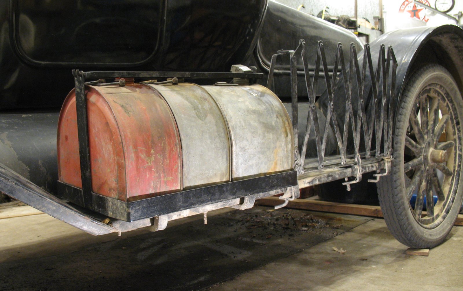

Steve —on your tank stick I’m assuming that the square tank reading would be for the 26-27 cowl tanks? The earlier square tanks in the early Coupes had a square tank. Just wondering.
I have a tank stick but it has oval and round tank markings only.
- Posts: 7413
Re: Making a gas gauge for a cowl tank
I don't know, John. I assumed it was 26-27, but maybe both tanks measure the same.

The square markings are not for the cowl tank. The gallon markings are too evenly spaced. The cowl tanks have graduated markings due to their odd shape.John kuehn wrote: ↑Wed Jul 15, 2020 10:17 amSteve —on your tank stick I’m assuming that the square tank reading would be for the 26-27 cowl tanks? The earlier square tanks in the early Coupes had a square tank. Just wondering.

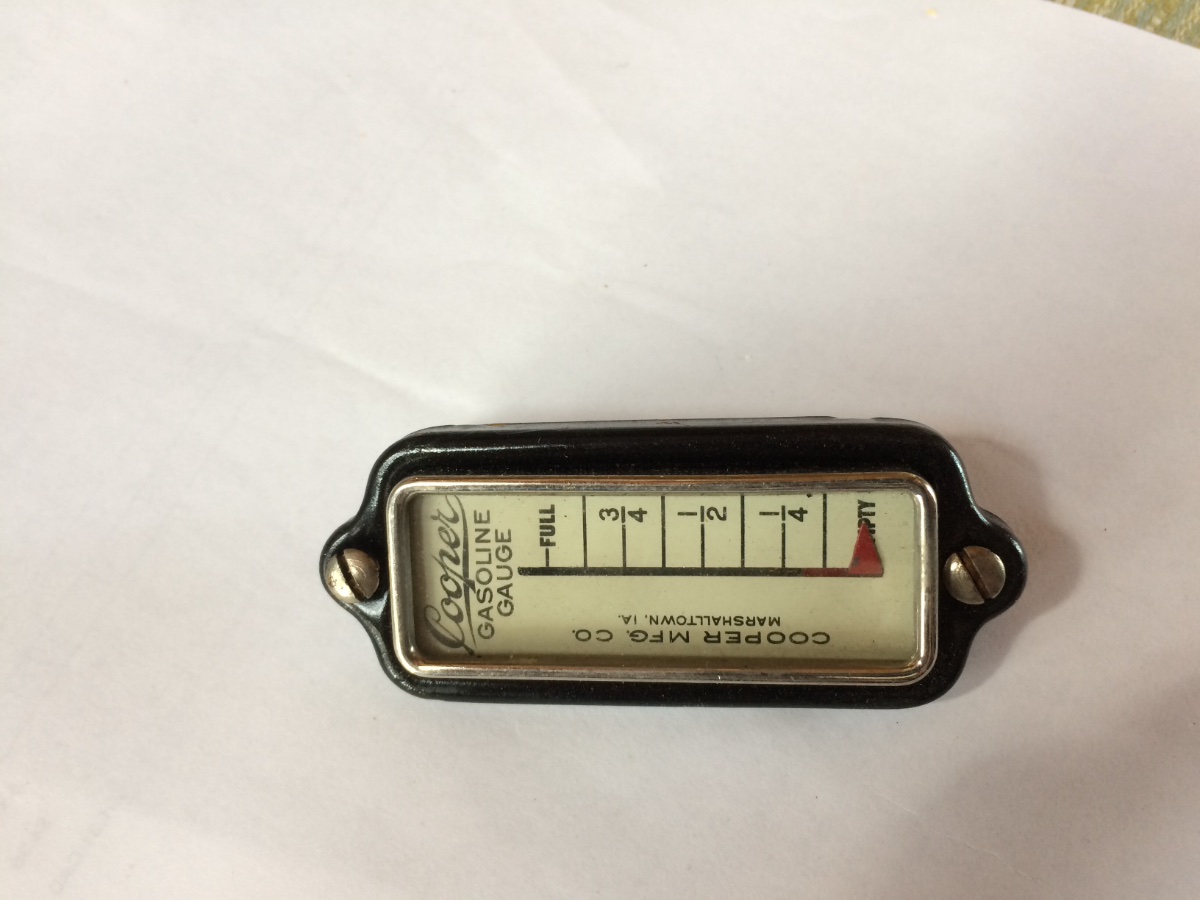

Looked at jab35 post referencing another post....the stick looks like the markings of a dox cup.
Les Schubert
- Posts: 1364
- First Name: Les
- Last Name: Schubert
- Location: Calgary
When I saw the title of the thread I was thinking this!!

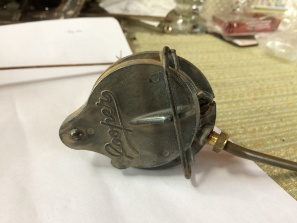

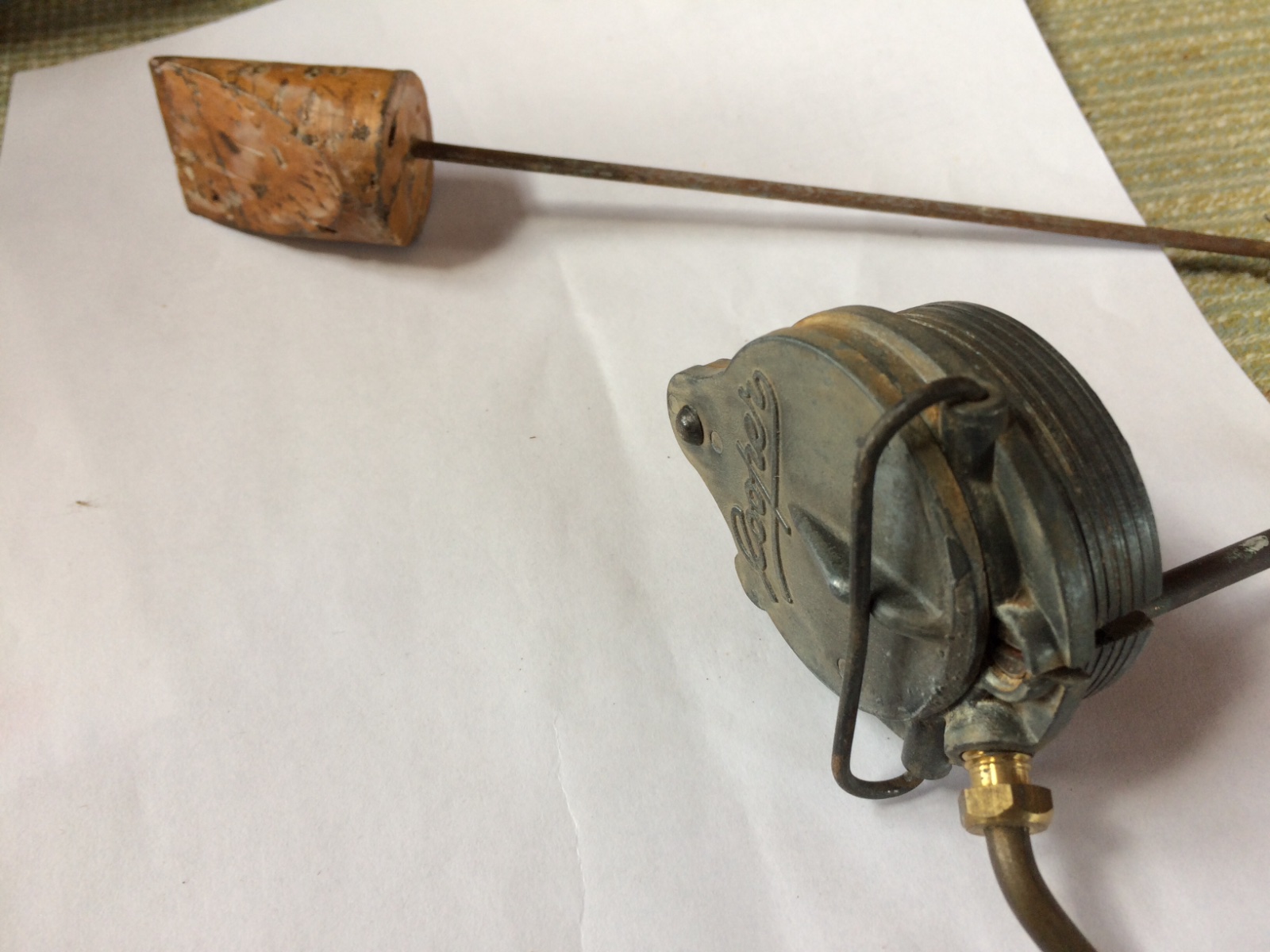

Orrrrrrrr.... one of those that have the spiral-ey insert that goes down into the tank... not sure how that would work on an improved car, but I'm sure where there's a will, there's a way!
Ya know, I wonder how well the old cork floats handle modern "gasoline"... would it be better to switch it to something like Nitrile, or maybe make one out of brass sheet...
- Posts: 5614
Susanne - I have several original gas gauges in cars and I've replace the original cork floats with the Model A gas gauge modern material float - they work perfect BUT I only run "clear" gas in my T's !
