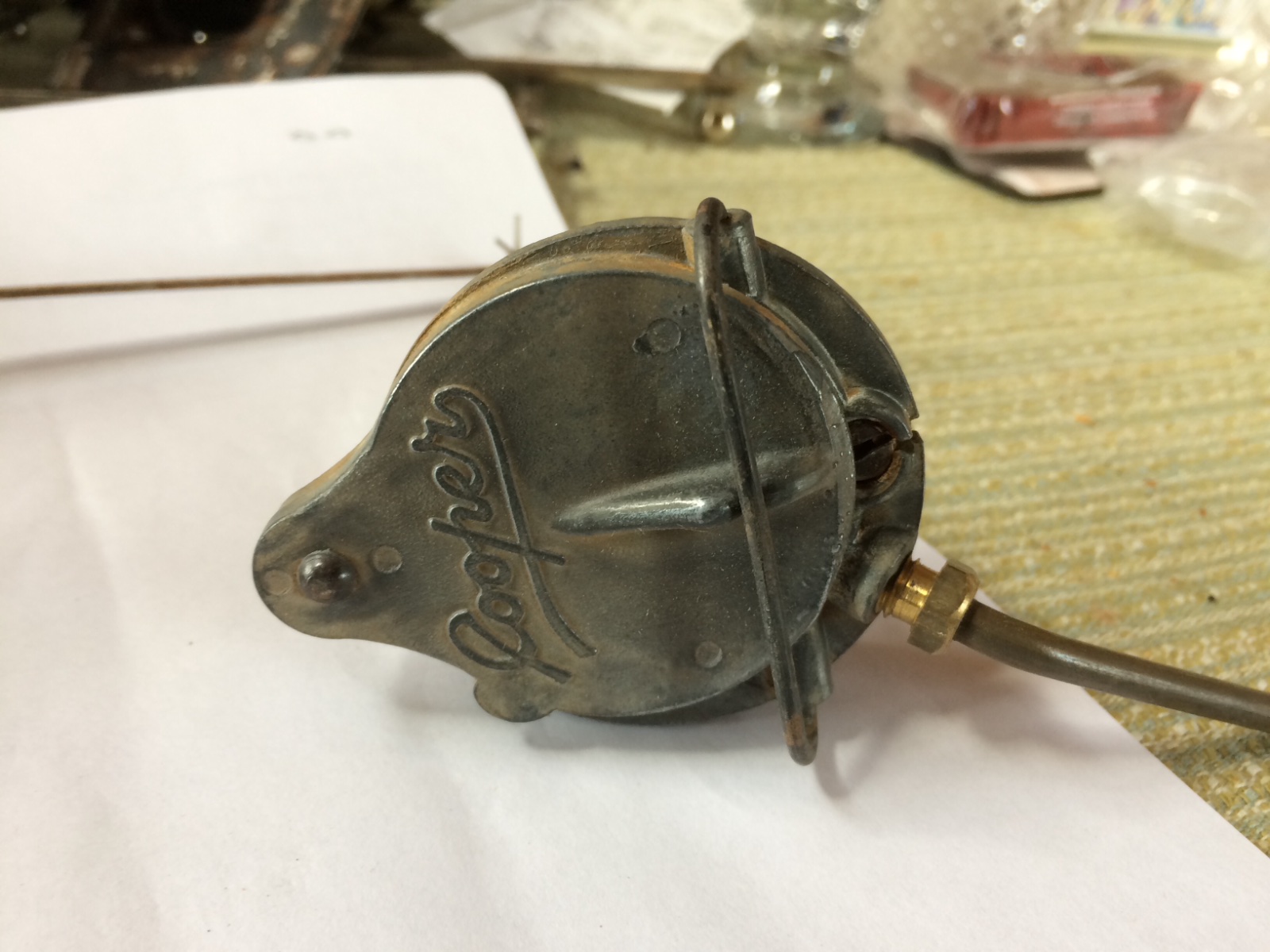

Me too... It's like the one on my space heater for my shop. And it works!Les Schubert wrote: ↑Thu Jul 16, 2020 6:00 pmWhen I saw the title of the thread I was thinking this!!
Orrrrrrrr.... one of those that have the spiral-ey insert that goes down into the tank... not sure how that would work on an improved car, but I'm sure where there's a will, there's a way!
Ya know, I wonder how well the old cork floats handle modern "gasoline"... would it be better to switch it to something like Nitrile, or maybe make one out of brass sheet...
- Posts: 5175
Re: Making a gas gauge for a cowl tank
Susanne - I have several original gas gauges in cars and I've replace the original cork floats with the Model A gas gauge modern material float - they work perfect BUT I only run "clear" gas in my T's !
