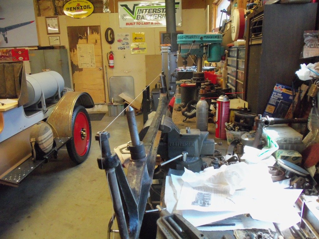

One very quick way to check out the entire alignment of the frame and axles would be to measure from center of the front spindle bolt at the bottom of the axle to a point on the opposite rear side. Such a place as the bolt where the rear radius rod bolts to the rear backing plate. Then measure in the exact same manor the opposite side. The distances should be the same if everything is in alignment.
A way to measure the alignment of the front axle whether it is bent would be to remove everything from the axle and then put a rod in each hole where the front spindle arm is bolted, the spring perches. There are 4 holes so put a straight rod in each hole. They should all be in alignment with each other. If not, the axle is bent and needs to be straightened.
