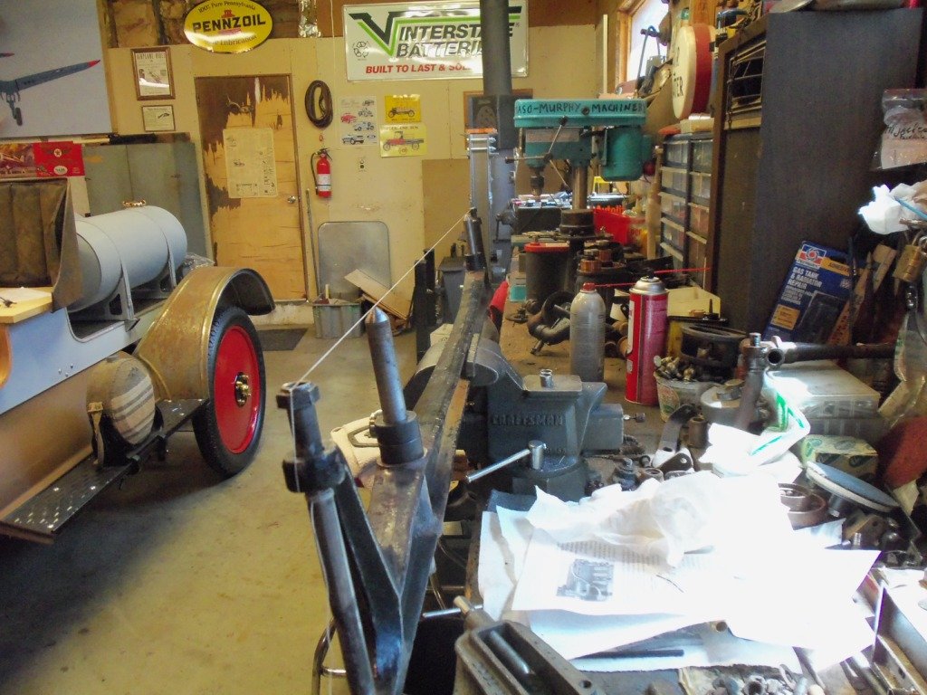

Stephen: I have had that problem. Play with caster all you want but that won't fix it. Your axle is bent, between the perch and the king pin. Probably hit one too many curbs in its day.
Posts: 5356
Re: Why do I keep wearing tires out?
Post by RajoRacer » Thu Jul 23, 2020 1:24 pm
I'm in Jack's "camp" on this one - I made this simple alignment gauge - tells you in a glance which end is going where !
