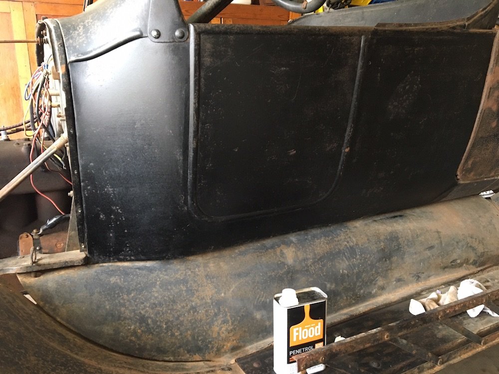

I used something called Penetrol on my old and very thin paint. It's avaialable from Lowe's, Home Depot, etc and has little or no smell. I wiped it on then immediately wiped it off until dry. You can do your whole car with a small can. It leaves a very dull shine and doesn't tend to attract dust and dirt and it also doesn't adversly affect old paint.
WD40, on the other hand, leaves a wet look, attracts dirt and dust like a magnet and smells like WD40.
It's the fad these days for hotrodders, but I wouldn't clear coat any old finish, especially not one that was down to having almost no paint left at all like yours. You'd be sealing in oxidation that will turn aggressive and cause real problems.
The best thing you can do however, is simply keep the car dry. Oxidation, once stopped, has little or no chance to progress in the absence of moisture.
Here's a shot showing treated and untreated panels on my 24 Touring with Penetrol. In the photo, the body was treated and the fender, splash apron, etc had not yet been treated. This was two years ago and the treated panels still look the same. Of course, the car sleeps inside a dry garage and is never in the rain.

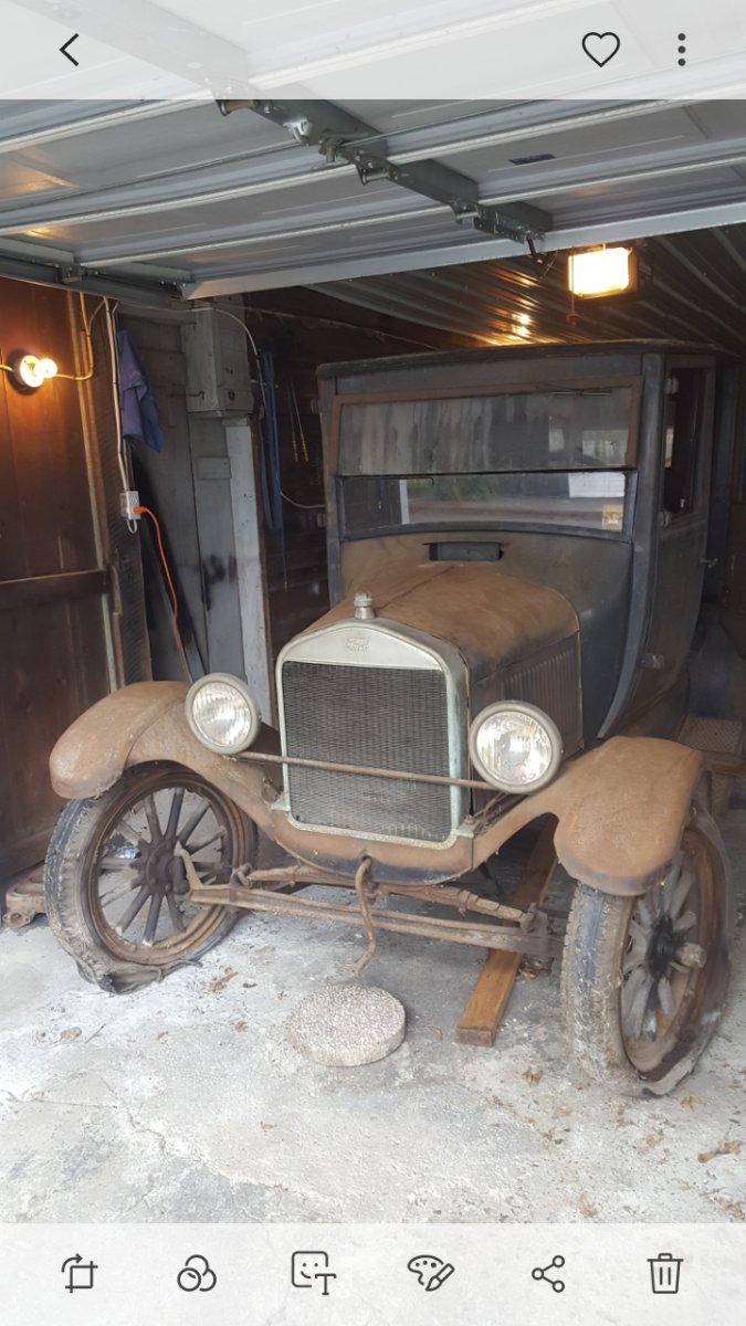

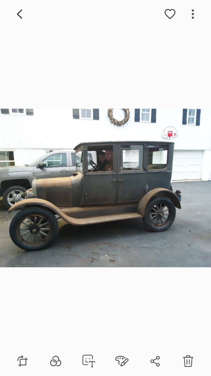

Larry e rutt
Topic author - Posts: 154
- Joined: Wed Jan 09, 2019 4:52 pm
- First Name: Larry
- Last Name: Rutt
- * REQUIRED* Type and Year of Model Ts owned: 1926 fordor
- Location: Ephrata pa
Re: Clear coat my 1926 fordor body
I'll tell u what I know about my fordor.. my wife and I own an auction house.. a customer came with pictures of a barn full of (stuff ) he bought and it included the model t. I had been casually looking for an old car for 35 years or so. We agreed on a price and I bought it before it hit the auction. The story goes it was in the tobacco shed next to the main barn when the main barn burned, it was ten feet from the barn fire..here is a few pics
