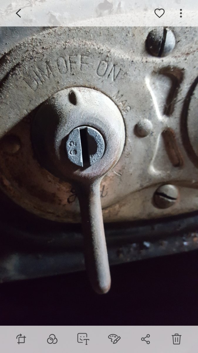

I'll tell u what I know about my fordor.. my wife and I own an auction house.. a customer came with pictures of a barn full of (stuff ) he bought and it included the model t. I had been casually looking for an old car for 35 years or so. We agreed on a price and I bought it before it hit the auction. The story goes it was in the tobacco shed next to the main barn when the main barn burned, it was ten feet from the barn fire..here is a few pics
