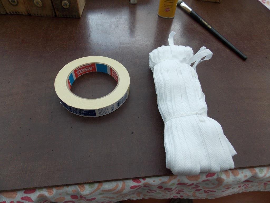

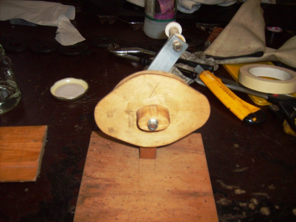

Here a few photos of what I use.
First there is the tool I made to make the coils. $2.-
The masking tape (polyester based and stand oil when used properly). Here I found it in about every "do it self shop". $2.- each need two.
Cotton tape 3/8" large needed about 1.3m each coil makes a little over 20m. You can find it at a sewing shop by the meter or 5 meters.
Last time I bought it was 200m for $57.- all in.
The coating here you can find the polyester resin for $16.-/liter available in 1/2liters. One liter does four coil loops.
I think for about $15.- you should find what you need to do the rebuild.
Good luck
Andre
Belgium
