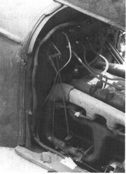

If your carb is later version with double-end choke lever, seems rather easy to run a choke wire up into the car via the slot where the carb adj. rod now rides.
This photo of a period belt starter being installed on a non-electric T, but you may can see the extra wire running up and into the slot in the wood firewall, that is likely the new choke wire.

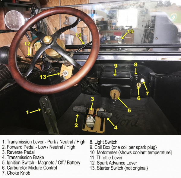

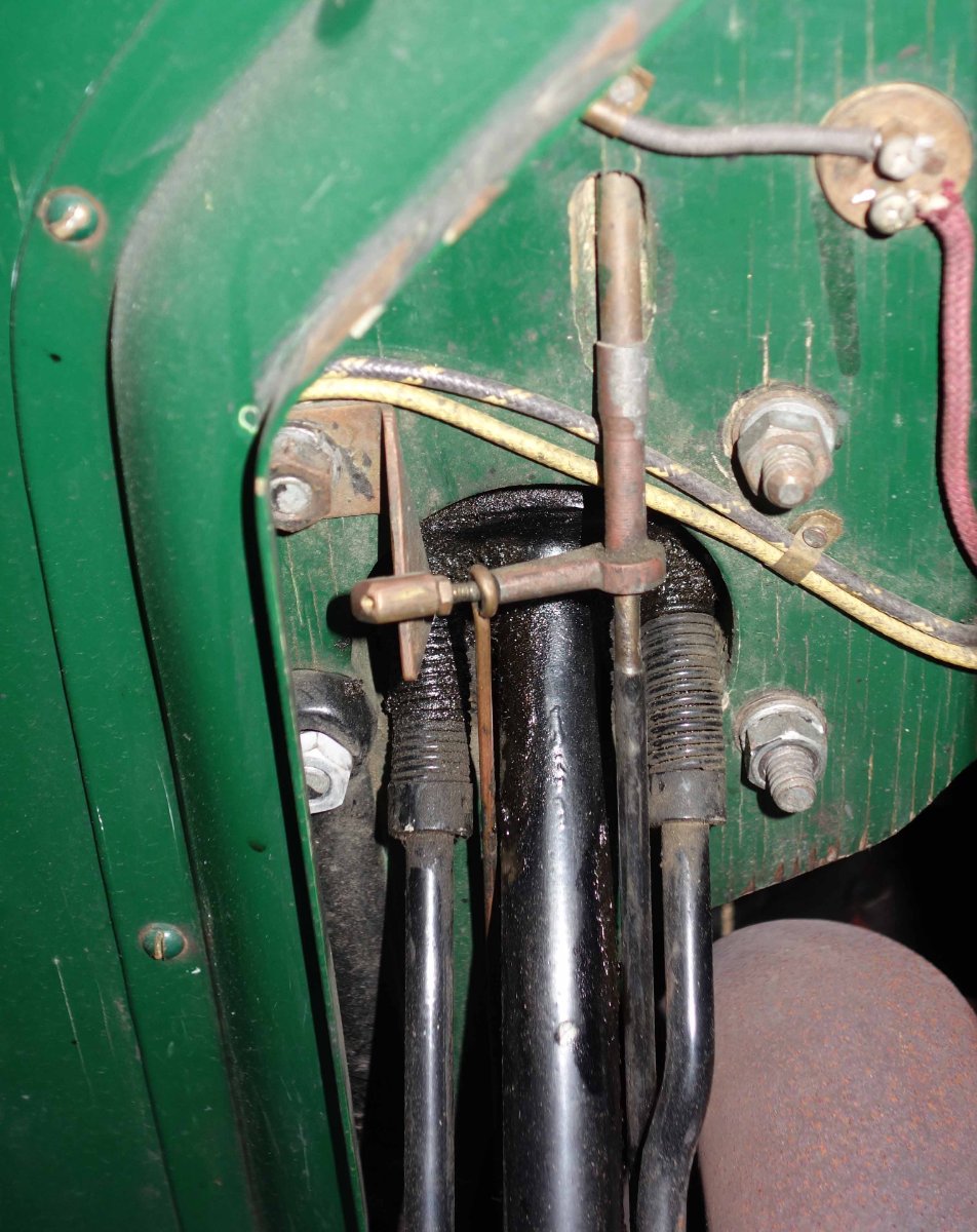

I have the same thing....a '17 touring with a starter added. The setup is similar to a '19 or '20. When I had my Holley G carburetor overhauled by Russ Potter I asked him to add a double-ended choke lever which allows the attachment of a choke wire from the front by the crank and from the panel. The latter used a bell crank (yellow arrow) attached to the carb choke lever at the bottom and to a pull rod inserted thru the firewall and terminated with an aluminum knob (green arrow). I was able to purchase both from the vendors although I had to shorten the pull rod and re-thread it to attach the knob. You can see the choke knob in the second photo at #7.

For Dan,
Nice photo. Note that it also is a 1917 –you can see the electric light switch to the left of the coil box insulators. That was discontinued on USA cars with the introduction of the combination horn & light switch (For of Canada continued that push-pull light switch for a few more years).
For Tim,
Nice description.
For Harold,

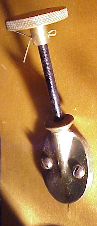

Lang’s has most of the parts listed in their catalog –
Bell crank is part 4583 see: https://www.modeltford.com/pl.aspx?t=s&v=4583&page=1
Priming choke rod with knob – goes through the dash to the bell crank – available in several sizes – from 7 ½ inches to 20 ½ inches – the 7 – ½ inch one is shown at: https://www.modeltford.com/item/4588D.aspx
Choke wire from the carb to priming bell crank on the engine side of the firewall 4589B at: https://www.modeltford.com/item/4589B.aspx
Depending on the type of carburetor you have, Lang’s has some of the dual arm levers available. And of course, you can place a note in the Classified Parts section for used parts if you need to or if you prefer. .
Note Tim has a metal firewall that was used by Ford as a replacement for the low wood firewall. It would have already had the holes drilled (punched?) for the bell crank to be mounted. But that same bell crank was mounted to the wood firewalls starting in 1919 when a starter was supplied. Below is a photo showing that bell crank on a wood firewall from around 1920. It is from the Jul-Aug 1979 "Vintage Ford" page 16, and is used by permission.
Tim shortened the rod on the inside by cutting off the end with the threads. I think you could probably cut off the other end and re-bend it – depending on which is easier for you to do.
If you decide to go with the 1919-1925 original style bell crank, pull rod on the inside, etc. just ask someone to give you some measurements for where the parts would be located on your wooden dash. It doesn’t have to be perfect. Or as Dan mentioned you could run a wire to the carb (you will probably still need the two lever arm on the carb – so you can choke it from the front if you are hand cranking or from inside the car if you are using the electric starter.
Good luck with your upgrade.
Respectfully submitted,
Hap l9l5

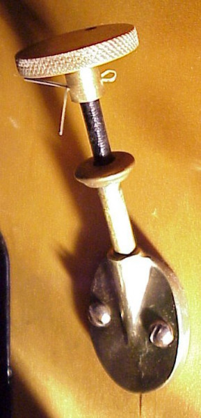

I used the mixture control rod to go through the firewall just enlarged the hole in the 1915 dash and made a tube over the mixture rod and a second brass knob.

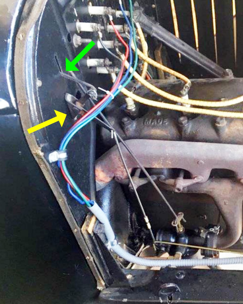

Re: adding choke rod inside of body 1917 touring with starter
Frank,
Here is the motor side. Hopefully the photo will load, sometimes they don't for what ever reason
If not email me and I will send it to you direct.
