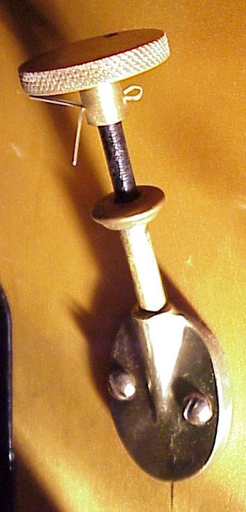

Re: adding choke rod inside of body 1917 touring with starter
I used the mixture control rod to go through the firewall just enlarged the hole in the 1915 dash and made a tube over the mixture rod and a second brass knob.
Peter, can you post a picture of what the choke rod assembly you created looks like on the motor side of the firewall, please. Frank
Frank,
Here is the motor side. Hopefully the photo will load, sometimes they don't for what ever reason
If not email me and I will send it to you direct.
