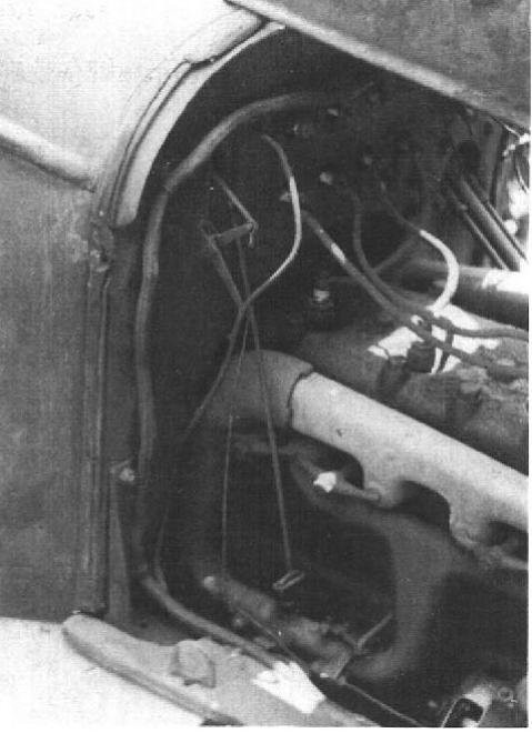

If your carb is later version with double-end choke lever, seems rather easy to run a choke wire up into the car via the slot where the carb adj. rod now rides.
This photo of a period belt starter being installed on a non-electric T, but you may can see the extra wire running up and into the slot in the wood firewall, that is likely the new choke wire.

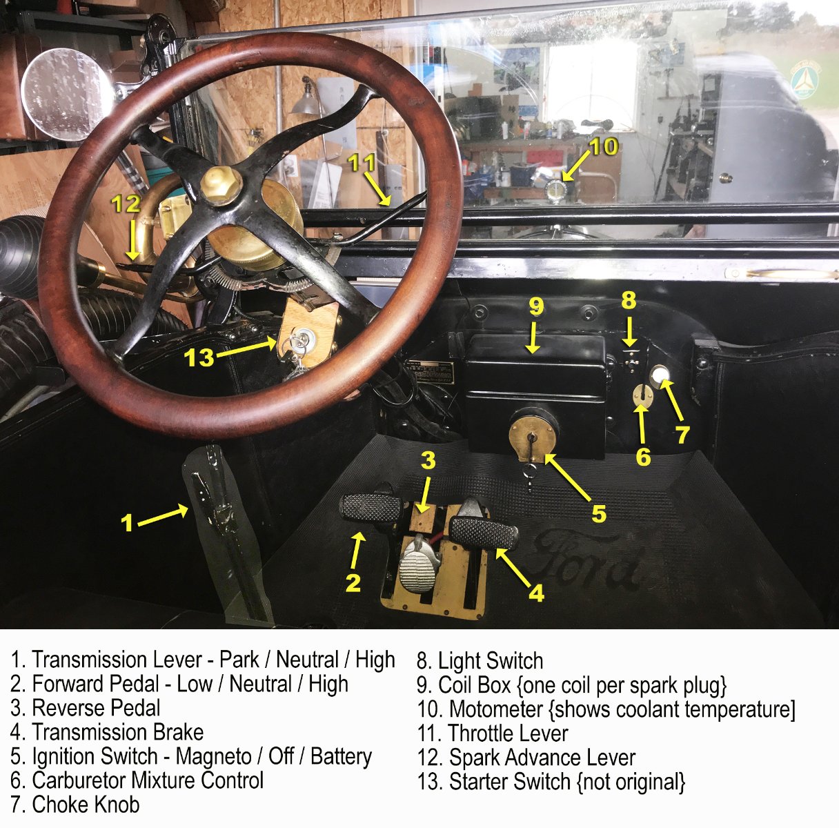

I have the same thing....a '17 touring with a starter added. The setup is similar to a '19 or '20. When I had my Holley G carburetor overhauled by Russ Potter I asked him to add a double-ended choke lever which allows the attachment of a choke wire from the front by the crank and from the panel. The latter used a bell crank (yellow arrow) attached to the carb choke lever at the bottom and to a pull rod inserted thru the firewall and terminated with an aluminum knob (green arrow). I was able to purchase both from the vendors although I had to shorten the pull rod and re-thread it to attach the knob. You can see the choke knob in the second photo at #7.
[/attachment]
[/attachment]

Nice photo. Note that it also is a 1917 –you can see the electric light switch to the left of the coil box insulators. That was discontinued on USA cars with the introduction of the combination horn & light switch (For of Canada continued that push-pull light switch for a few more years).

Actually, I have a wood firewall. The photo I posted is not of my car. I used a small router bit to make a slot in the wood because the push rod doesn't move straight back and forth. On the inside the slot is covered by an oval shaped brass disc with a centered hole.
I've attached a drawing that may help. It's referenced to the cabin side of the firewall.
