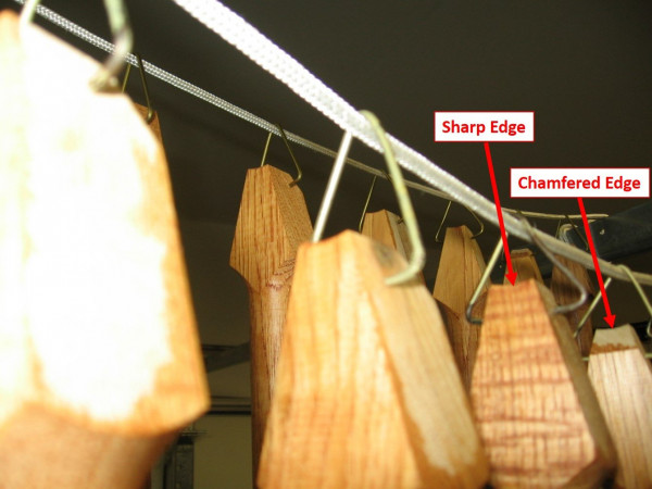

Note that the base of each spoke has a chamfer on one side. Are you sure that the chamfer of each spoke is facing the fillet on the hub? That chamfer is there to provide clearance for the fillet. If the spoke is rotated the wrong way, the sharp edge of the base of the spoke will hit the fillet and possibly prevent the spoke from seating on the center of the hub.
