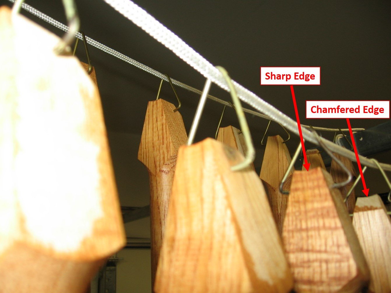

Note that the base of each spoke has a chamfer on one side. Are you sure that the chamfer of each spoke is facing the fillet on the hub? That chamfer is there to provide clearance for the fillet. If the spoke is rotated the wrong way, the sharp edge of the base of the spoke will hit the fillet and possibly prevent the spoke from seating on the center of the hub.

I ran into the same problem you’re having when I was rebuilding my rear wheels a few years ago. I varnished mine before assembly and thought I was careful to keep the finish off the tapered sides. I didn’t. Those tapers need to be smooth and flat so they can slide past each other as you’re pressing them in. Either way, you’ll need to raise them up and start over. Continually check alignment as you’re pressing them. Once you get past a certain point you’re not going to be able to rotate them any more.
