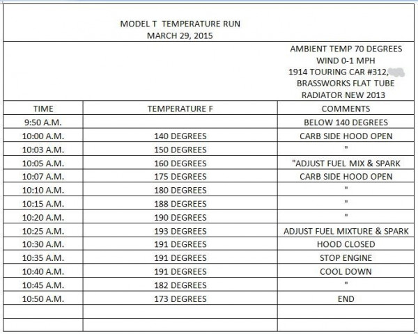

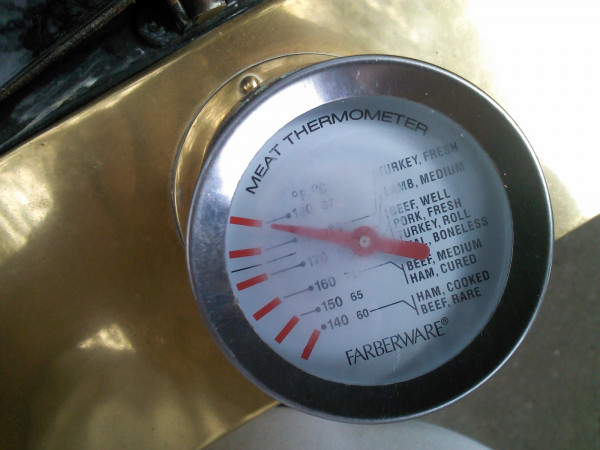

- Posts: 285
- Joined: Sun Jan 06, 2019 11:28 am
- First Name: Kenneth
- Last Name: Parker
- * REQUIRED* Type and Year of Model Ts owned: 1914, 1925
- Location: Houston, Texas
Re: 13T - Coolant Temp and Initial Driving Experience
Darin,
Sounds like you are fine.
If you are still curious though, be sure the kitchen thermometer is accurate.
I have a 1935 Ford V8 that uses thermostats so I've been checking them before installing for years.
Here is how I check my thermometer:
I used two NOS thermostats that are for my '35 Cabriolet, a 160 degree and 180 degree.
The thermostats opened at the proper temperature in a pan of water on the stove.
That puts me within a couple of degrees+/-.
Set the car up in your driveway with no tail wind.
Take off the radiator cap and drop the kitchen thermometer in the top tank.
Here is what I see on my '14, 4-ball Kingston, air pipe, coils on magneto, 50/50.
The fan is important when you are sitting still for an hour with the engine running
so you can't have a tailwind.
Any head wind will just drop the temperature. Almost still that day but not quite.
