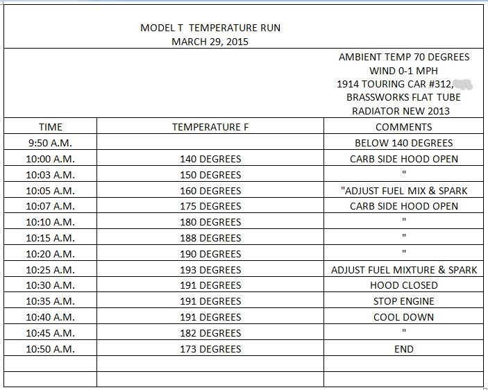

I have a 1935 Ford V8 that uses thermostats so I've been checking them before installing for years.
Here is how I check my thermometer:
I used two NOS thermostats that are for my '35 Cabriolet, a 160 degree and 180 degree.
The thermostats opened at the proper temperature in a pan of water on the stove.
That puts me within a couple of degrees+/-.
Set the car up in your driveway with no tail wind.
Take off the radiator cap and drop the kitchen thermometer in the top tank.
Here is what I see on my '14, 4-ball Kingston, air pipe, coils on magneto, 50/50.
The fan is important when you are sitting still for an hour with the engine running
so you can't have a tailwind.
Any head wind will just drop the temperature. Almost still that day but not quite.
Sounds like you are fine.
If you are still curious though, be sure the kitchen thermometer is accurate.
