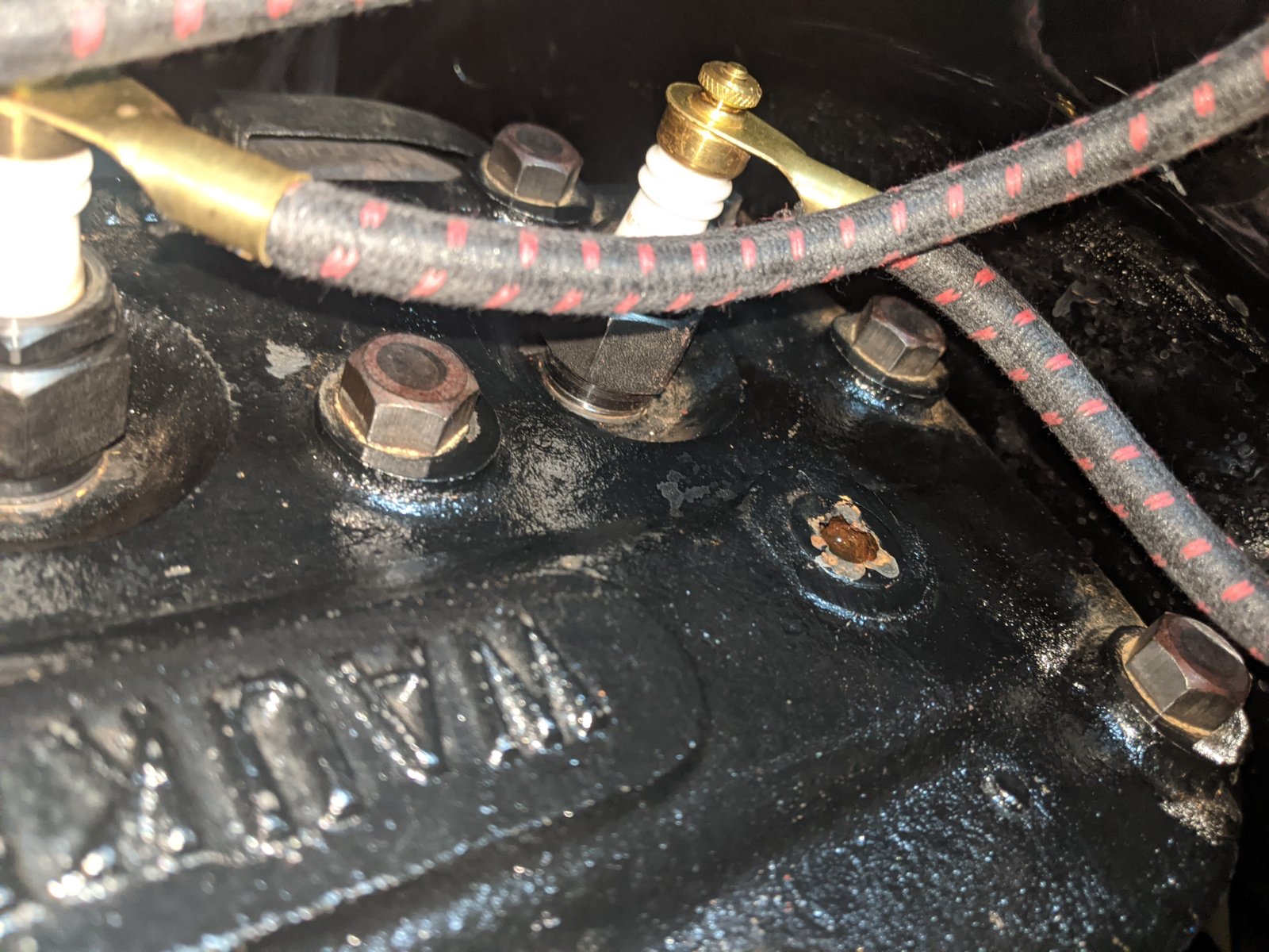

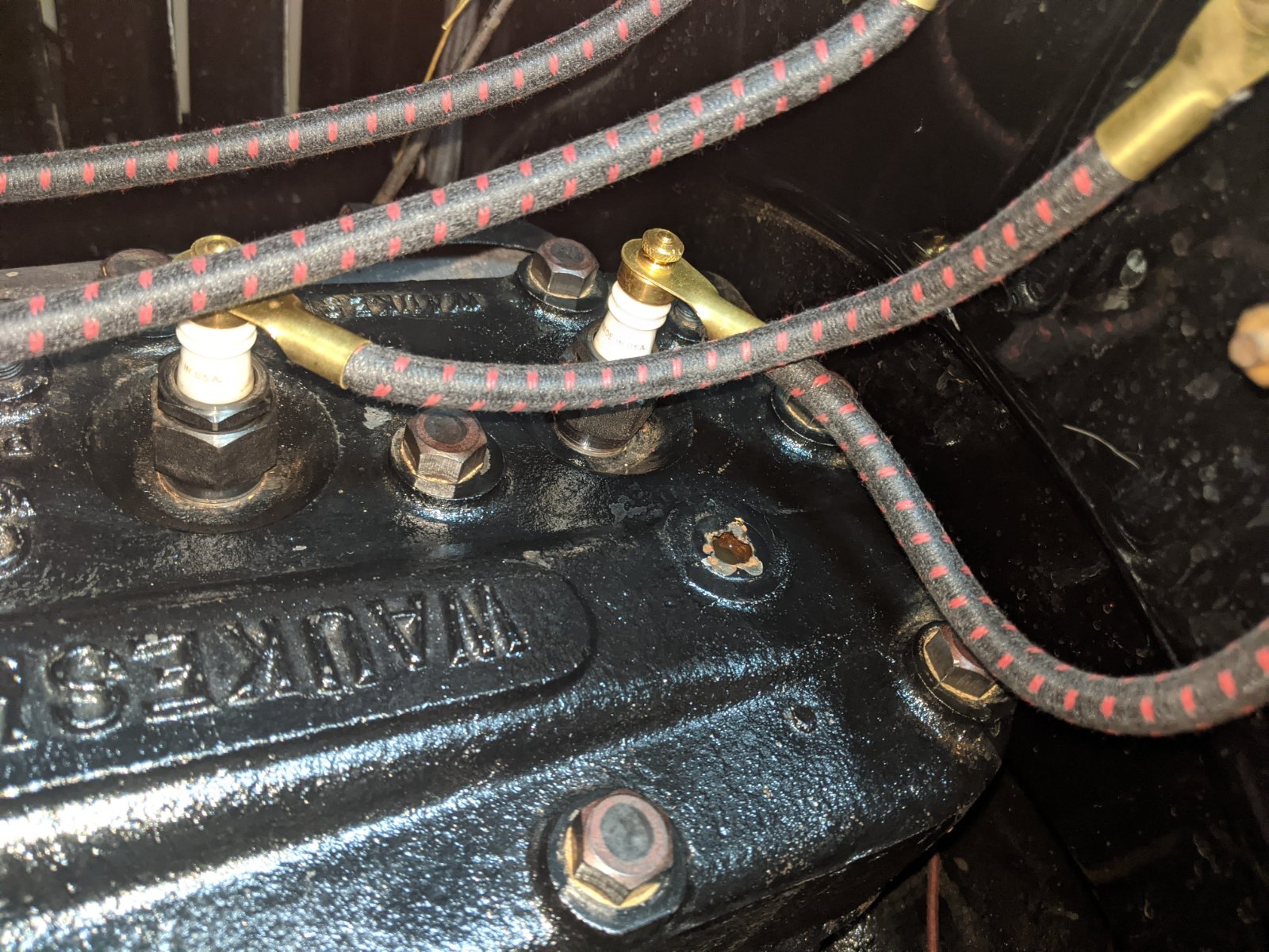

Leak in Waukesha Head by #4 Spark plug.

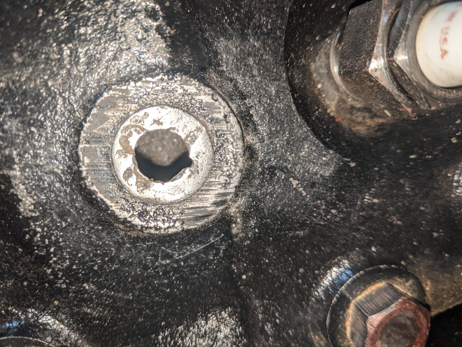

Went out for a ride tonight and started smelling antifreeze.
Got home and have a leak in head between plug#4 and back of head in round embossed area.
Water spraying out of round embossed area.
Is this a freeze plug area?
Any help appreciated.

Looks like a typical freeze plug to me. Probably will find that the center is rusted thru. Might get lucky and have a nickel fit in there

Either as Kevin states or a standing boss during the internal core support at casting time. These were a steel type pin which in the long term corrode away. If it is, simple fix by drilling out a small hole using a brass 10/32 brass screw with red Loc-Tite. Sand head off and touch up with paint.

Tend to agree on that, a freeze plug there. Interesting place, my W-R head could have used a freeze plug in that spot. If you look close on mine, a long run of braze is covering a long freeze crack aside the nameplate boss!

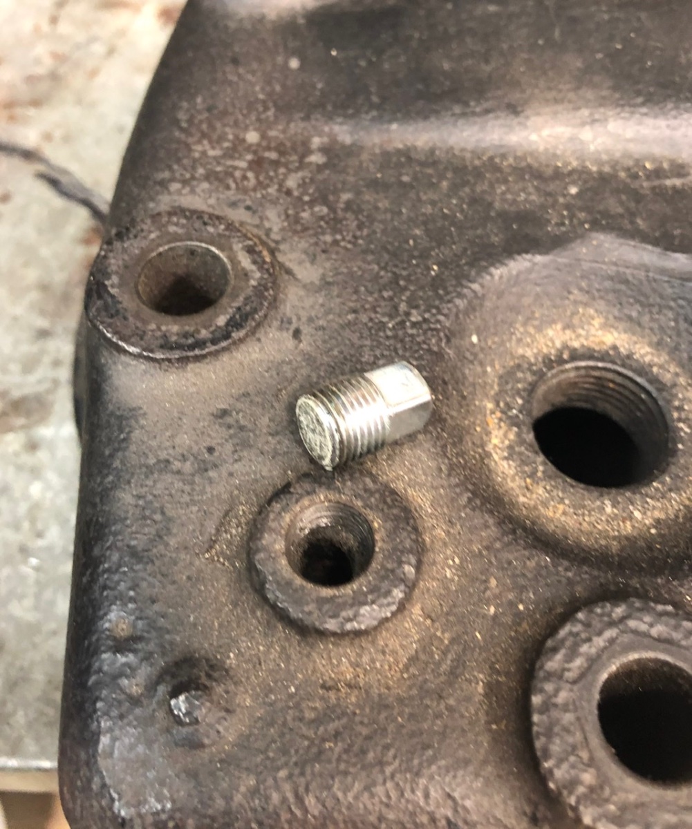

Picked up a 1/8" pipe plug and it screws in easily. A little loose until no threads showing.
Any recommendations for sealing plug into head?
Rick
Rick

Re: Leak in Waukesha Head by #4 Spark plug.

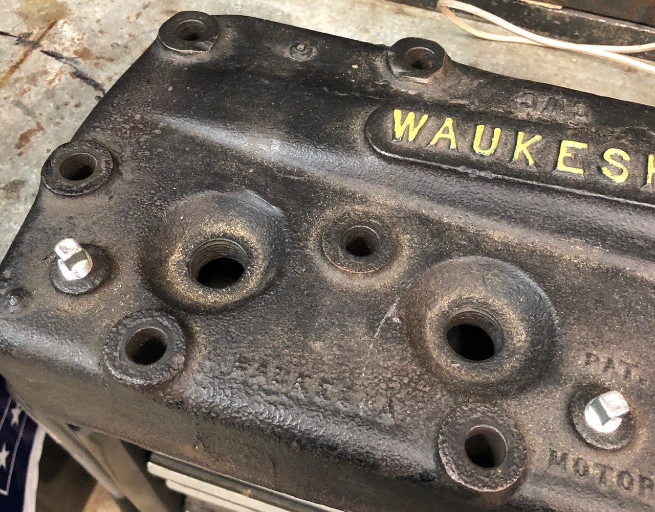

What’s showing in the picture IS a “freeze plug”. There are multiple DIFFERENT Waukesha heads. The one pictured uses a freeze plug there.
After further investigation Adam is right a freeze plug it is.
Previous owner of head must have put a pipe plug in or filled center of freeze plug due to previous leak.
Now what is my best option and how to do proper repair.
And where to get correct freeze plug

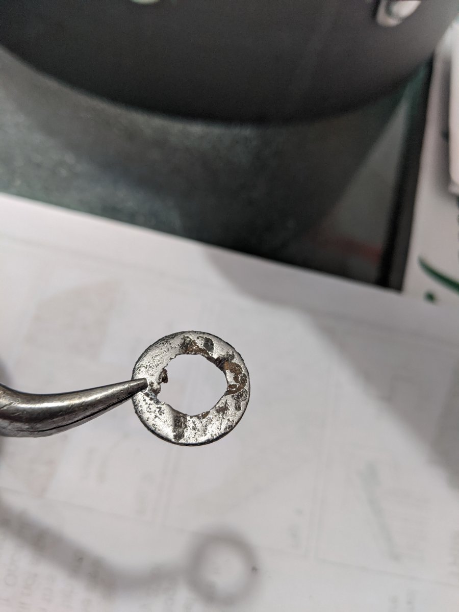

Some auto parts stores may still have them. What size is it? You could for now, clean it and seal with something like JB weld. Might want to put something like a screw in the hole to bridge the gap for now if you want to do a temp repair. It might be the same size as the T welch or freeze plug.
- Posts: 5517
Drill it out & tap to the appropriate sized pipe plug, apply sealer - done.

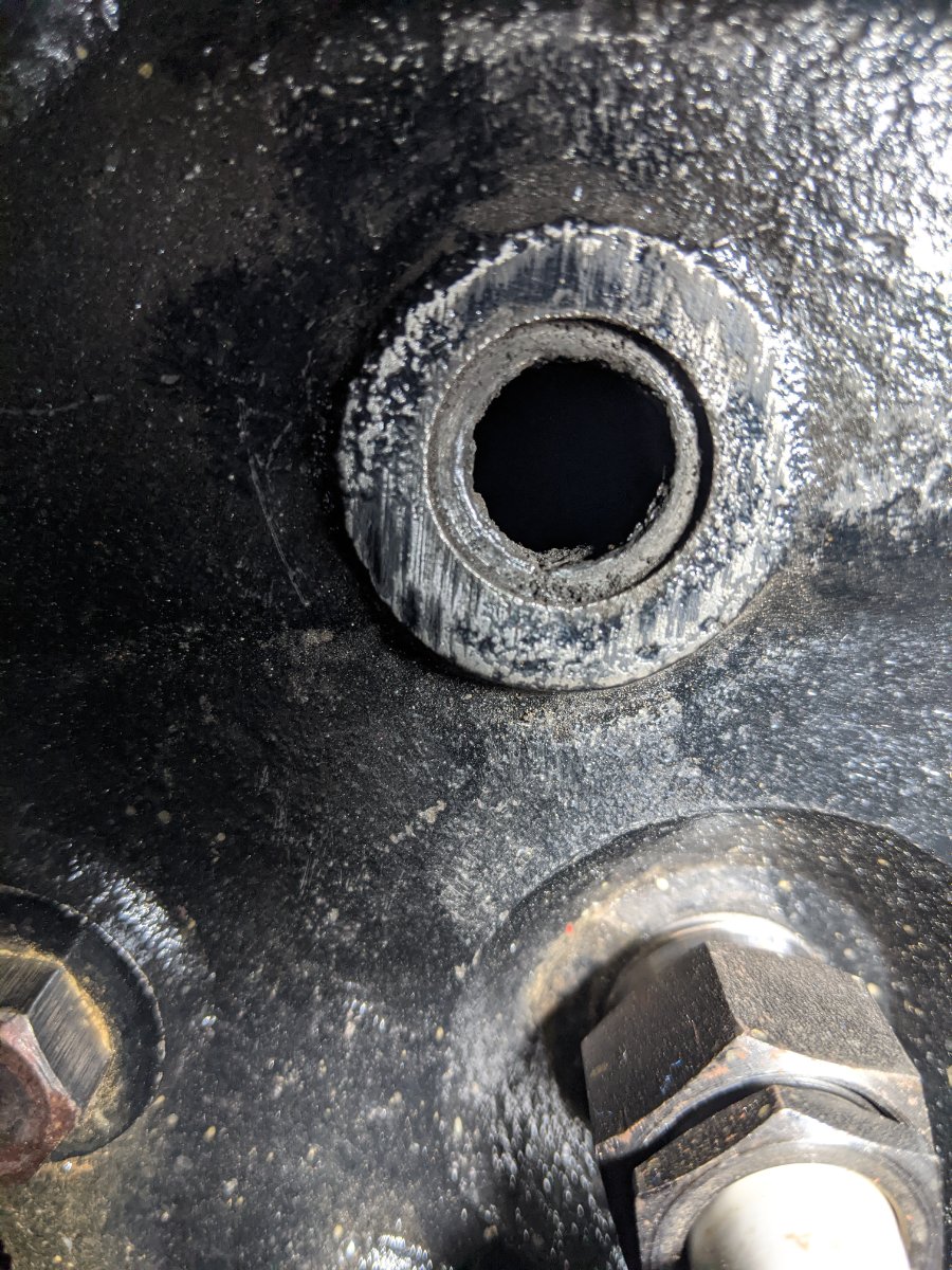

Old freeze plug out and area cleaned up ready for the new one.
Thanks to Hank and the MTFCA for all your help.

- Posts: 5517
Is that what the core hole looks like without the plug ?????
Steve
Yes that is what the core hole looks like without the plug.

If freeze plugs actually worked, that would be a good place for one. I have 3 WR heads like Dan posted and mine do not have a plug there. Getting very hard to find one without freeze cracks. I still like telling about the “perfect” one I bought off the west coast. I knew there was a problem before I lifted it outa the box. I measured 39” !! of crappy weld and braze on the top
of the head, with a heavy paint job over it. That one cost me $40 bucks to return, but at least I got most my money back.
If looking for one, asK for good pictures deep inside the front water outlet.

Thanks Jerry, I was aware of that. I use a larger size on our Rajo oil gauges, and they are getting tough to find. For fun, next time someone takes a trip to an auto parts store, ask for a Welch plug. Or a core plug. Or a freeze plug. Blank stares.
As for the WR head, the one shown is right in line with the core wires. They likely started making the cores differently.
