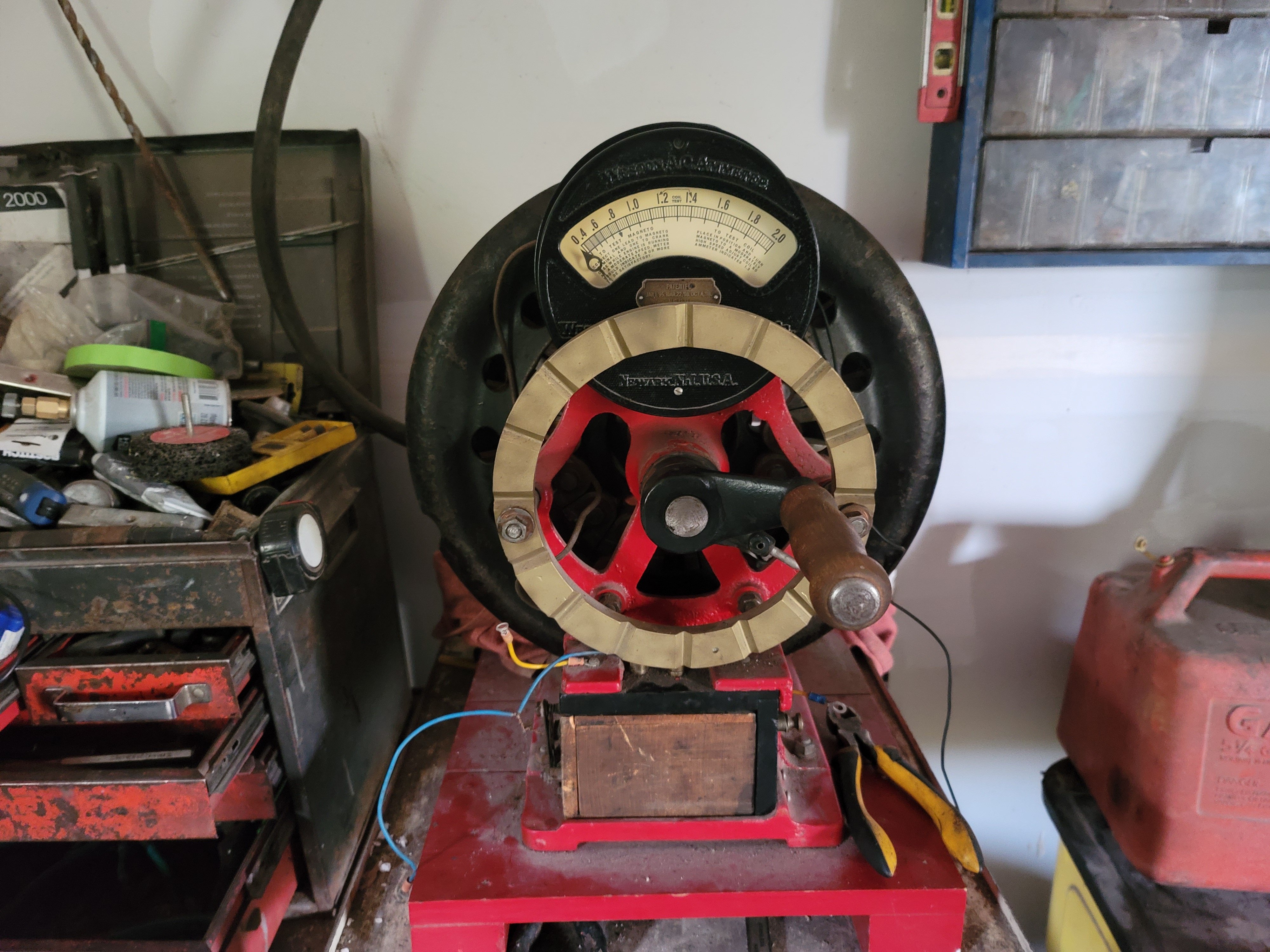

I have a SSECO HCCT that I am having troubles getting the spark to jump the ring. It has a rebuilt Weston meter on it and will fire the coil and make the meter work, but it will not spark on the spark ring. By hooking up a test light to ground and then touching the spark ring it will 'spark' the test light. This is a SSECO HCCT, but the spark ring is of the type that in Patterson/Casica book, that is listed as an unknown manufacturer. I will attach a photo in a bit. Thanks in advance.

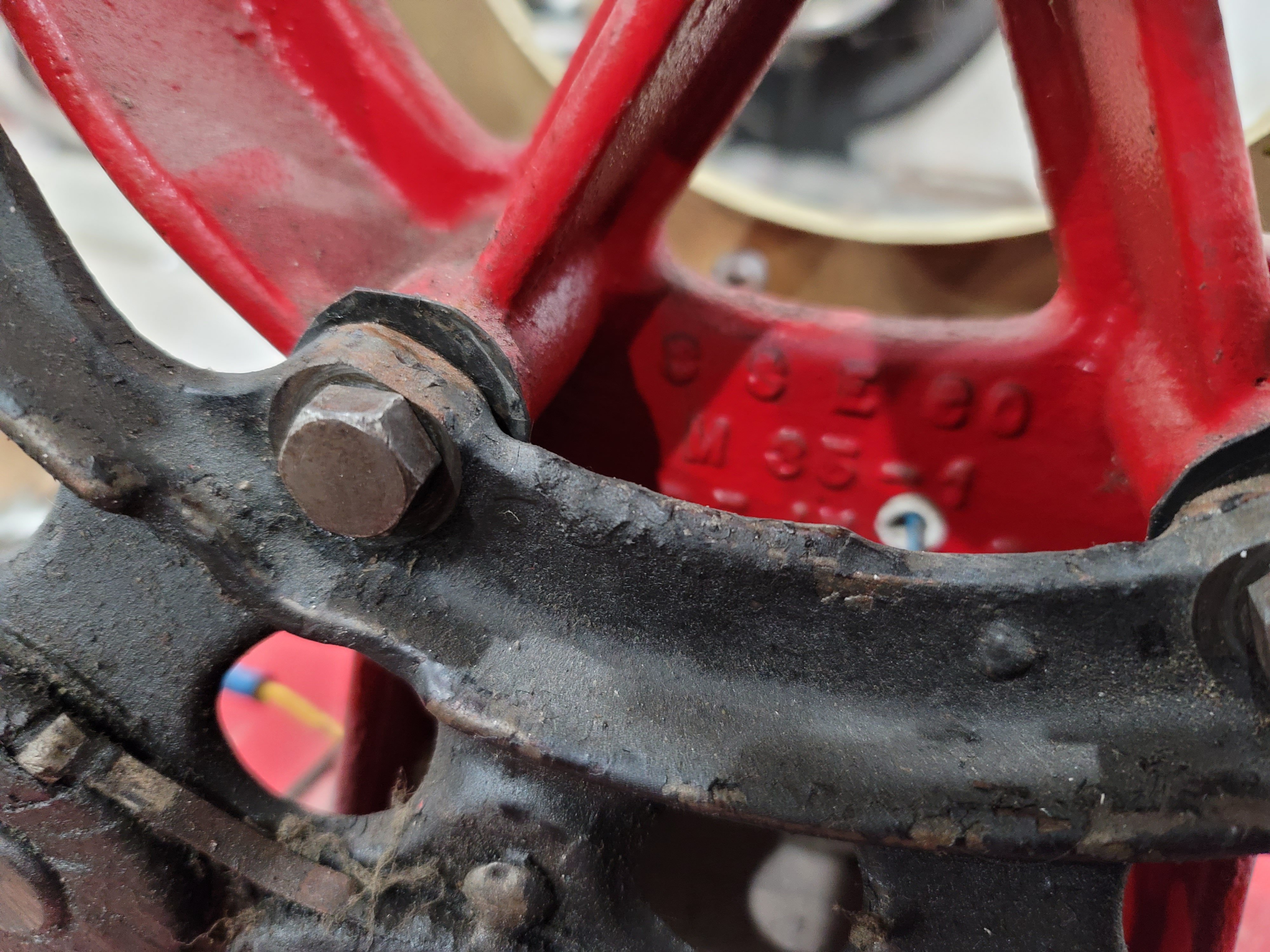

I have glass beaded the ring, pointer, and the socket the pointer installs into. Check out the photo.

Andy, it is an Service Station Equipment Company (SSECO) unit, as well - just a later version than shown in the HCCT handbook SSECO section. It appears your spark ring might be grounded to the frame via the two mounting bolts. That needs to be isolated electrically, preferably by standoffs that don't have a through hole.

I have it figured out. With some good private messages, several emails, and a chit chat with the Coilman, the solution was found. The spark ring was grounded to the frame. I made some new standoffs out of some delrin, making sure there was no thru hole. One side holds the delrin to the frame and the other held the spark ring to the delrin. Now I can finish the restoration. I'll post a photo when done.
