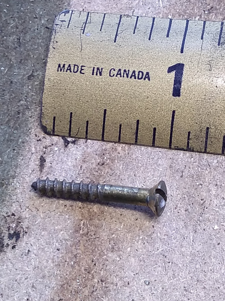

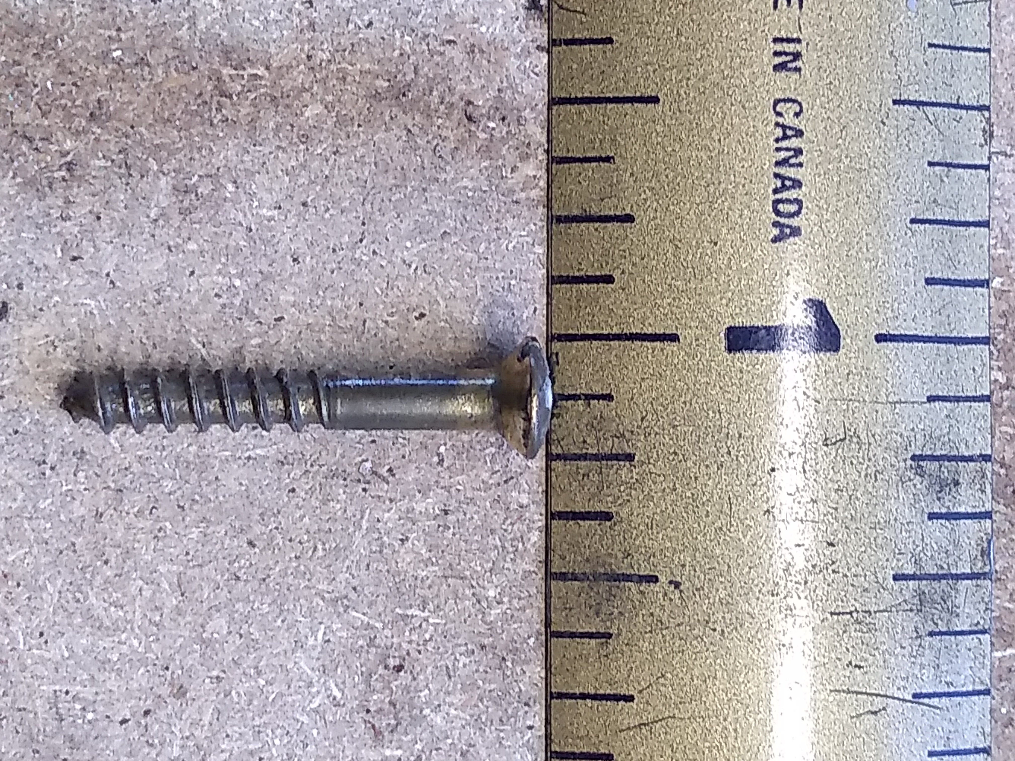

John F. Regan said on Tuesday, August 31, 2010 - 10:31 pm:
'09 screws were in fact #5 oval head screws. The #7 began later and was carried through 1914.

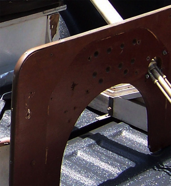

Re: 1909 firewall trim
This photo Dan showed in the discussion does show some spacing. I think it may be original.
More insight on it is welcomed.
This is another of Dan Treace's photos.
http://www.mtfca.com/discus/messages/118802/149412.jpg
I don't know the history but the spacing may well be correct.

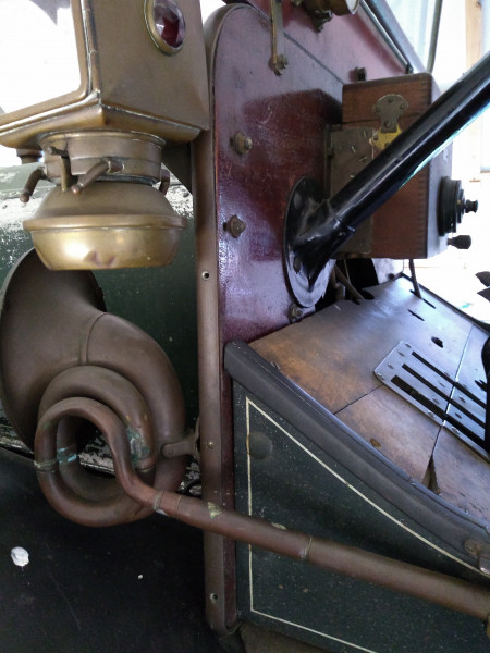

Here's my unrestored Aug 09 (not totally unmolested, it had an incorrect repaint circa 1950)
The bottom screw is 1.5" from the bottom edge, subsequent screws are 5.25" apart. The screw is a raised countersunk 1" long with 0.25" wide head.

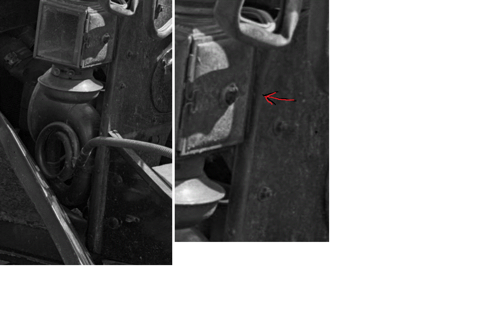

This photo of a wrecked '09-'10 was taken in 1913. Timing suggests that nothing was changed from original. This correlates with Jem's photo. It also shows a screw behind the lamp. See the arrow.
Yes there is a screw behind my lamp
