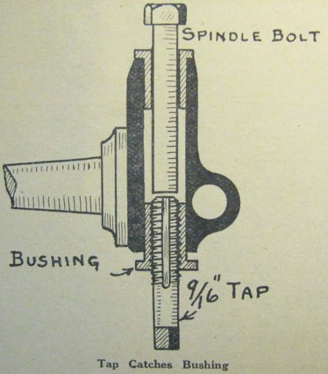

The bushings are hat shaped so you cannot press them thru. One way is to cut the outside part of the bushing off, then press them thru. Another way is to screw a tap into the bushing and drive the bushing out from the back side with a punch against the tap. There are special tools but pricy and not readily available.

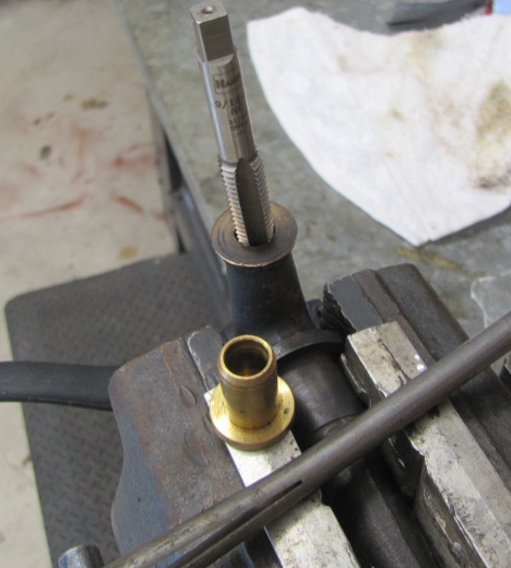

Using a tap is quick and efficient.
Or in lieu of the tap, vendors sell a split driver that catches on the barrel of the bushing to drive it out. Split driver on lower part of photo

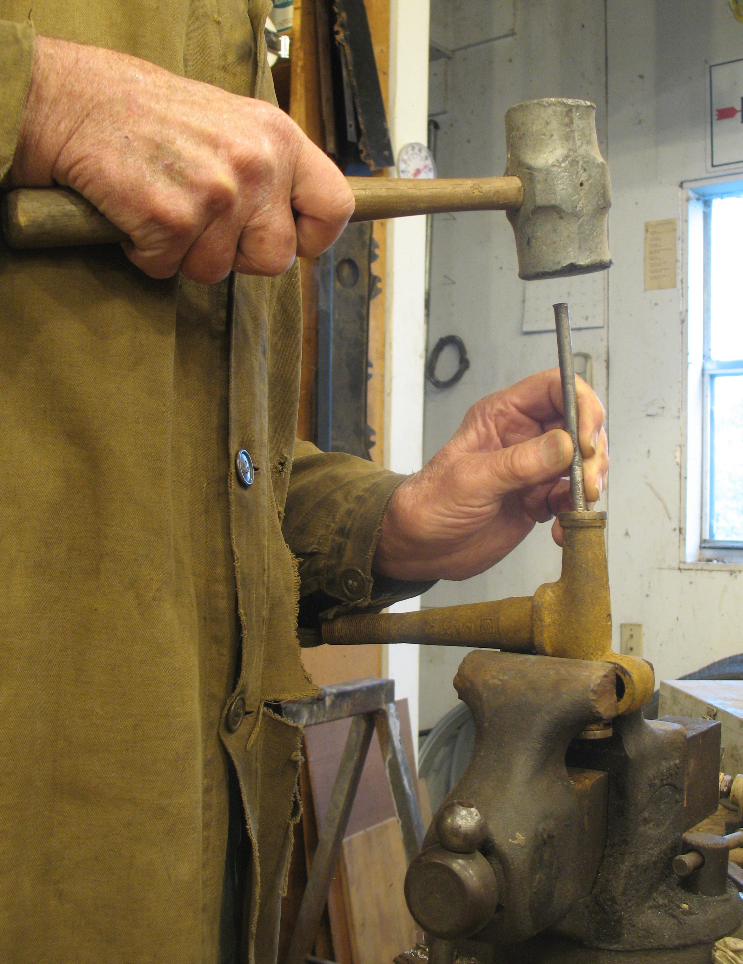

- Posts: 7413
Re: Advice needed
I get by with just a 3/8" rod and a Big Fat Hammer.

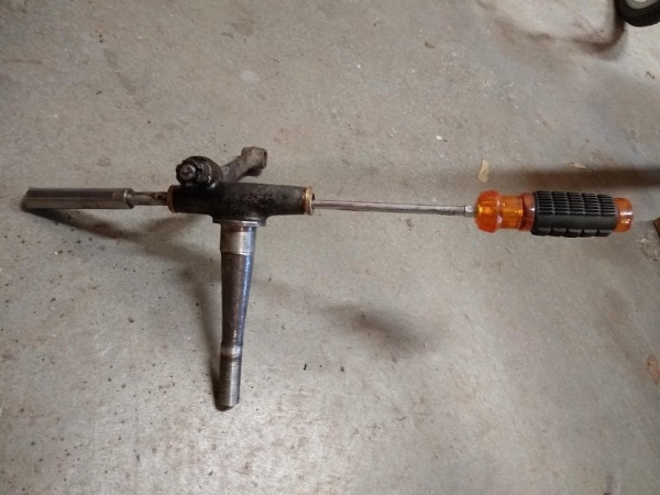

Not only is this a good trick, but about the only way to keep the tool spread apart to drive out the bushing. Stick the screwdiver into the tool like shown in the picture below, and one or two whacks on the garage floor will pop the bushings out.A good trick with this tool is to use a flat blade screwdriver to keep the tool ends spread apart while you are driving out the bushing.
I also agree with the comments earlier about getting the right reamer tools. I think that this is one of those cases where you really need the specialty tools, or don't do it at all, because you may end up being worse off than when you started.
