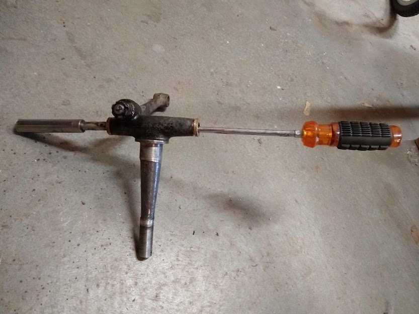

A good trick with this tool is to use a flat blade screwdriver to keep the tool ends spread apart while you are driving out the bushing.
Not only is this a good trick, but about the only way to keep the tool spread apart to drive out the bushing. Stick the screwdiver into the tool like shown in the picture below, and one or two whacks on the garage floor will pop the bushings out.
