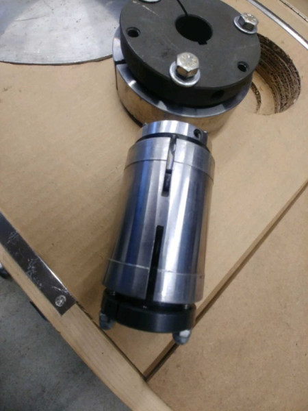

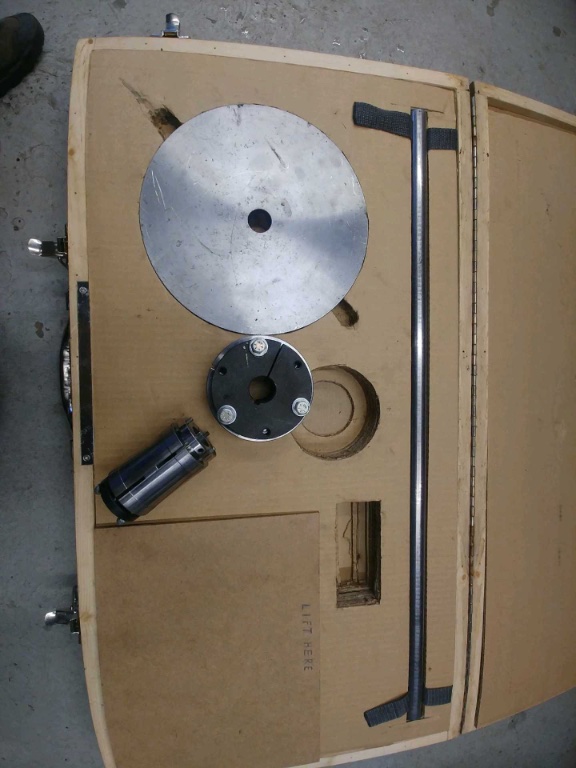

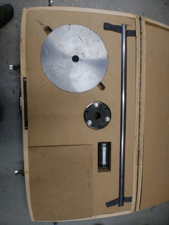

Les Schubert
- Posts: 1364
- First Name: Les
- Last Name: Schubert
- Location: Calgary
Re: Ruckstell Housing
My rear axle alignment tools

Dave Young
Topic author - Posts: 245
- Joined: Sun Feb 24, 2019 9:37 pm
- First Name: David
- Last Name: Young
- * REQUIRED* Type and Year of Model Ts owned: 26 Touring, 26 RPU, 24 Coupe, 26 Speedster, 28 Chandler, 29 Chandler, 29 A
- Location: Mays Landing, Nj
I was considering doing as Alan suggested, but after seeing the beautiful alignment jig that Les uses, I decided to just go ahead a spend the million to get a new one from Chaffins, ready to install. I will be selling the housing that I have. Someone could probably send it out to Chaffins and have a left side stub installed. I didn't want to wait that long.
- Posts: 6815
Les, you do some really interesting things with "T"s and design/use very nice tooling. Thank you for sharing, as it is always a treat.
